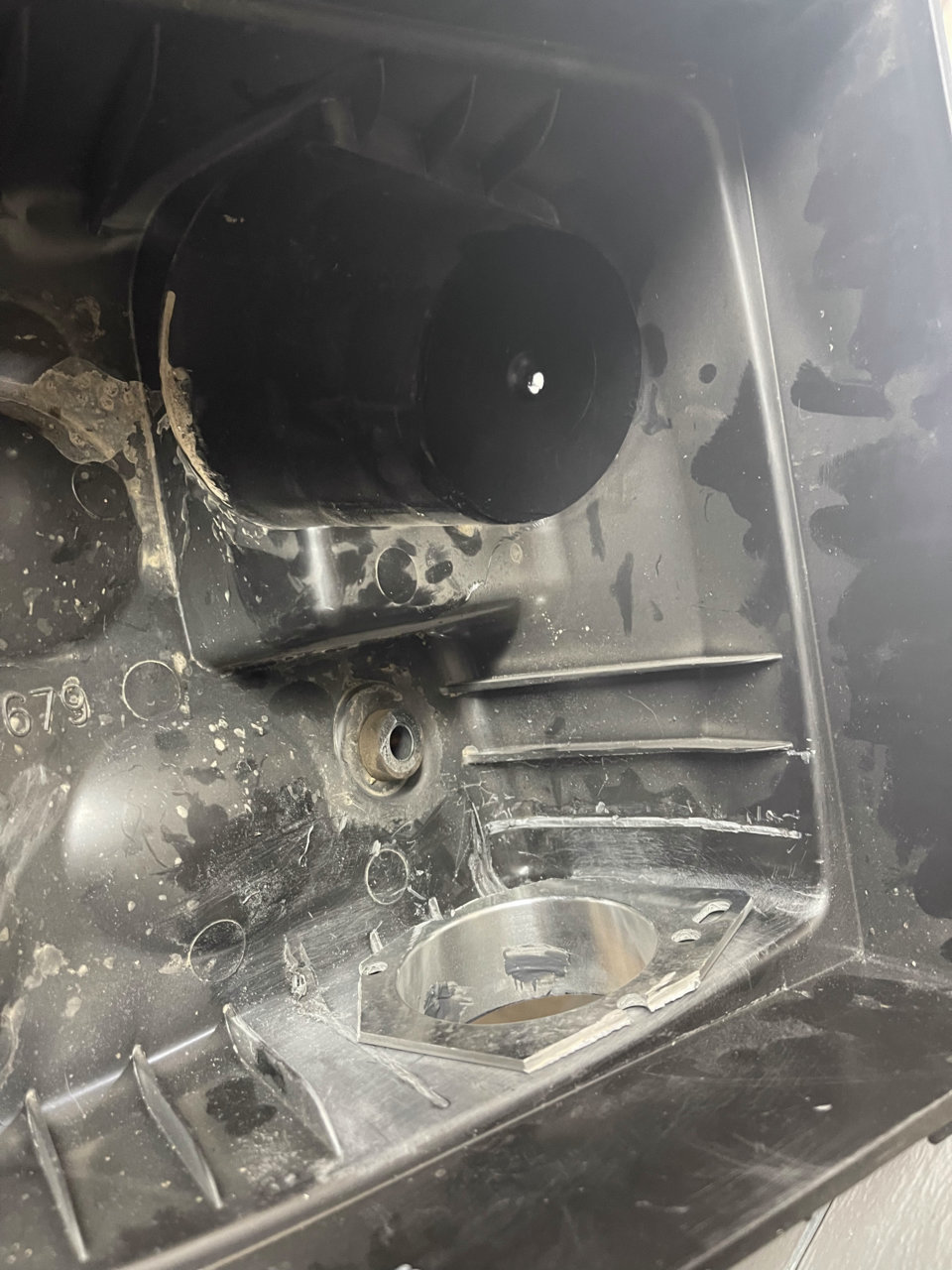

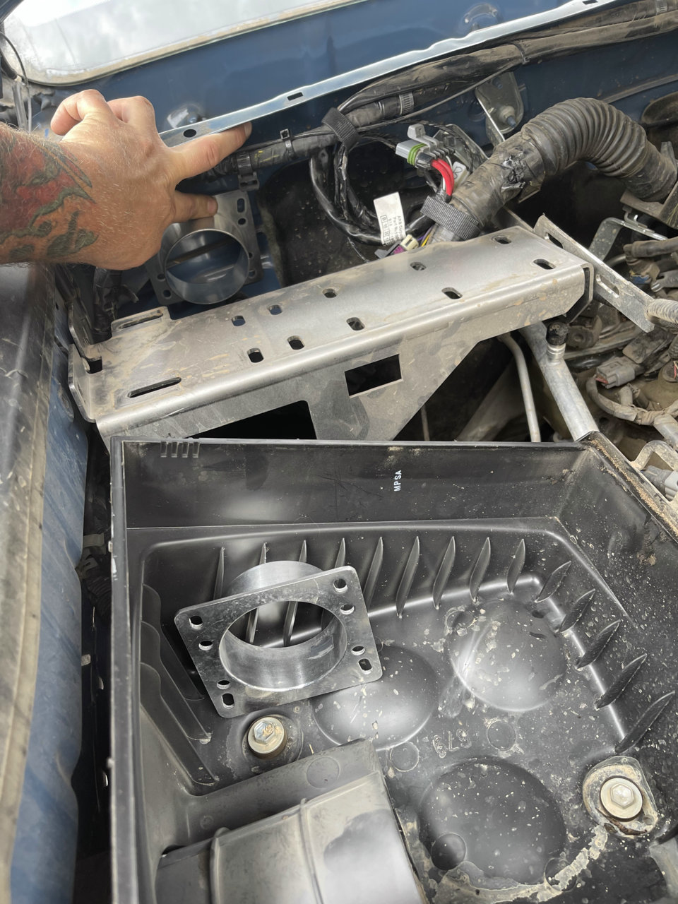

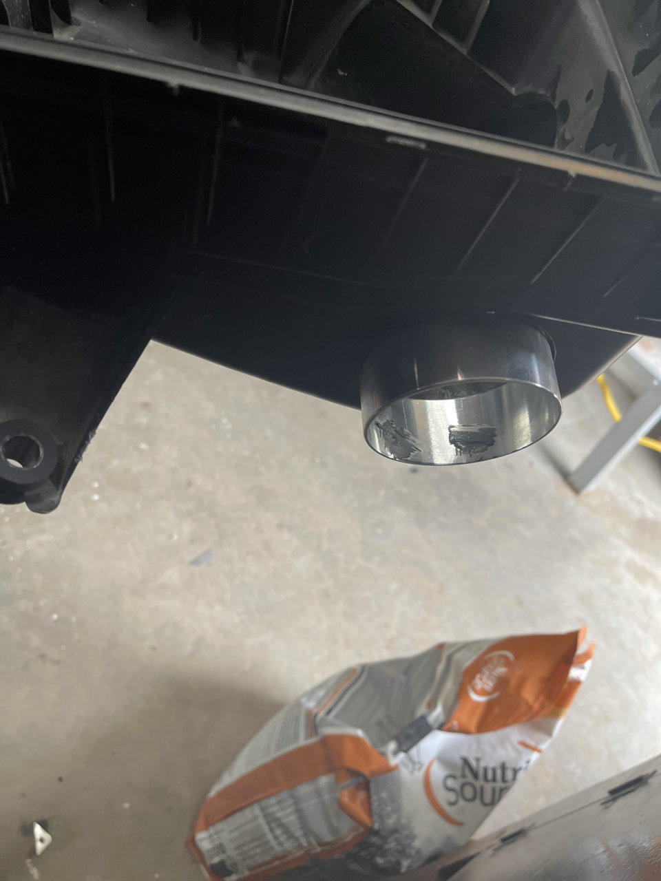

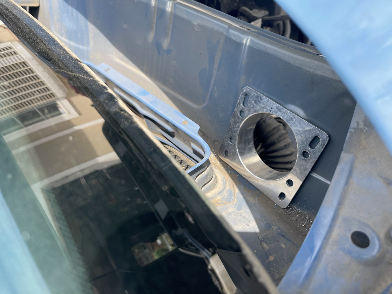

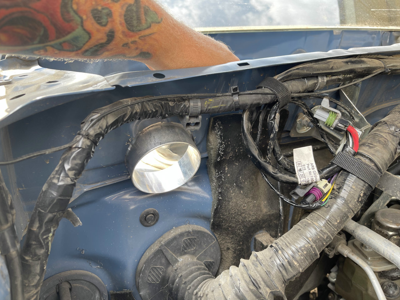

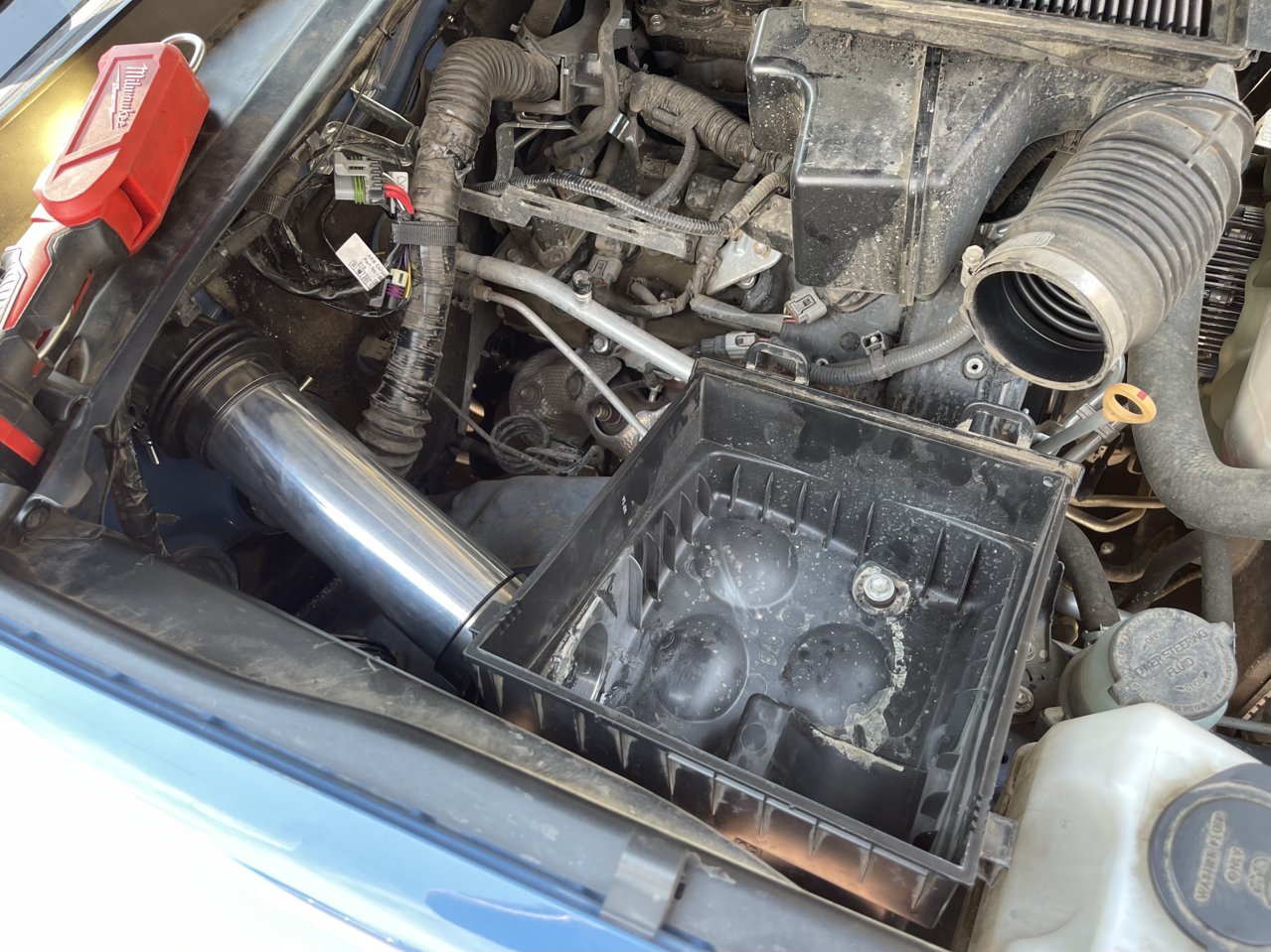

    FINALLY started to work on my cowl induction intake/snorkel... Going well so far. Here are the links to the parts needed.. I will be finishing this up this weekend. Removing my fender flares kinda forced me into it, I cant stand actual snorkels and this is the next best thing.
    https://www.amazon.com/dp/B00HG7D56G?ref=ppx_yo2_dt_b_product_details
    https://www.amazon.com/gp/product/B005M1Z1D8?ie=UTF8
    https://www.summitracing.com/parts/sum-294512
    To anyone interested you have to drill through the cowl wall, as well as your stock intake box. I plugged the stock intake hole that goes into the wheel well, with the bottom of a bucket. LOL! I am epoxying the mounting plates on, then after they are fully cured I will be fully sealing them on with JB weld or maybe some type of silicone. This is clearly not a reversible mod. IMG_1923.HEIC.jpgIMG_1922.HEIC.jpgIMG_1920.HEIC.jpgIMG_1919.HEIC.jpgIMG_1916.HEIC.jpg

    You lost me on this one… your doing this because you removed the fender flares? Whey would the flares make any difference?
  10. Jul 30, 2021 at 3:57 PM
    #70
    ZebraScissors
    ZebraScissors [OP] Well-Known Member
    Oct 3, 2017
    #231922
    369
    Drake
    Reno, Nevada
    2018 Cav Blue TRD Pro

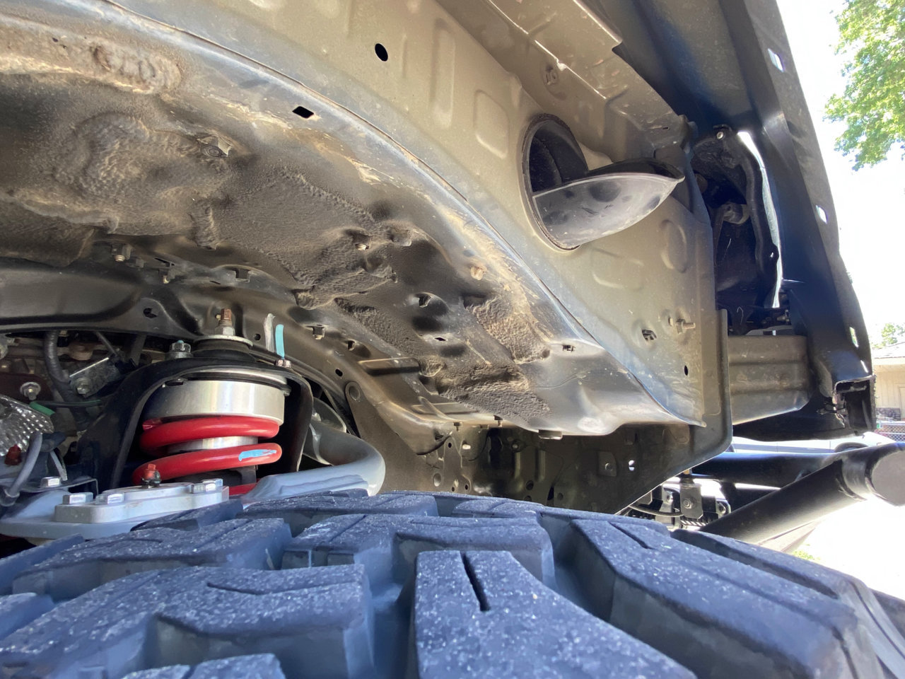

    The actual intake tube for your intake box, is in your fender well. Here's a pic. So when you cut the fender flares, you lose your fender liners, and when you lose your fender liners your intake is pulling directly from your tire area. Super horrible for water crossings, when it rains, dirt, dust, rocks. It's a mess. Your options are to get a snorkel, go this route, or fab up your own new fender liners. This mod is super popular with the 2nd gens.
    So I'm capping that off, and re-routing the intake to where the air flows in for the HVAC system! Get's your intake level to just below your windshield, for us snorkel haters.

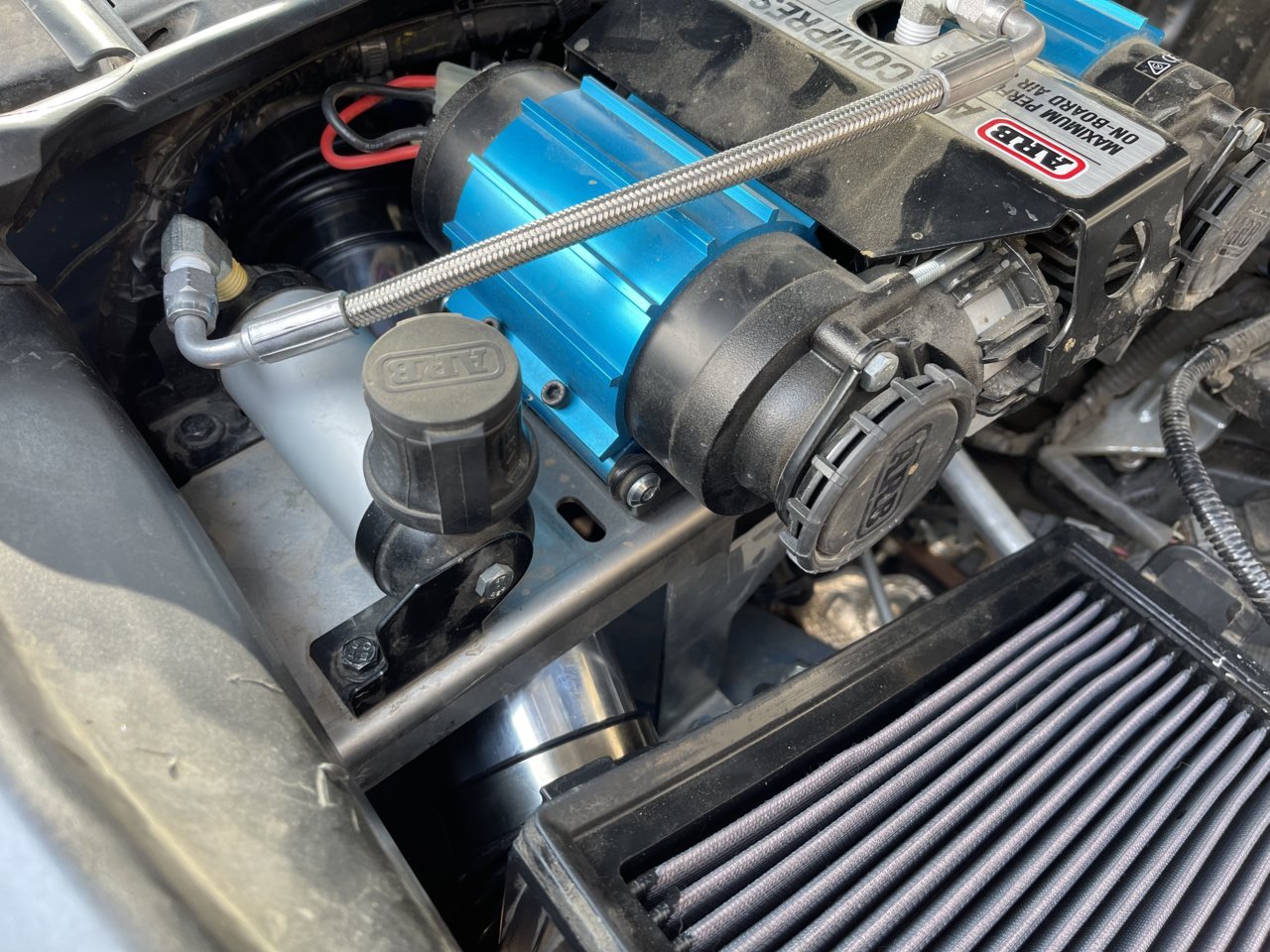

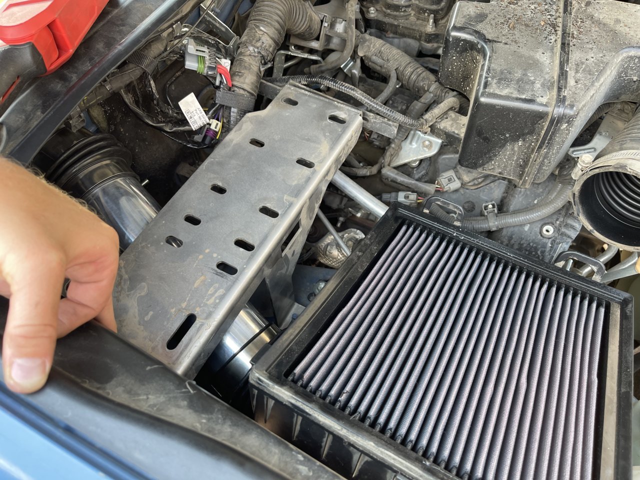

    106661DC-07C9-4EE4-8635-1F6E5711E1BC.jpg BDCCBAC9-1A8A-4A6C-80B6-C83D0A5A3CF4.jpg CF366F22-1896-4DA1-8C1B-FA9932BD79E3.jpg B11C4CD8-181F-4050-BADA-24AEA5B76F6C.jpg Alright! Mission complete……
    I think I’ll start a separate thread to help people out with it. The whole thing came out fantastic, and tucks perfectly under the ARB.

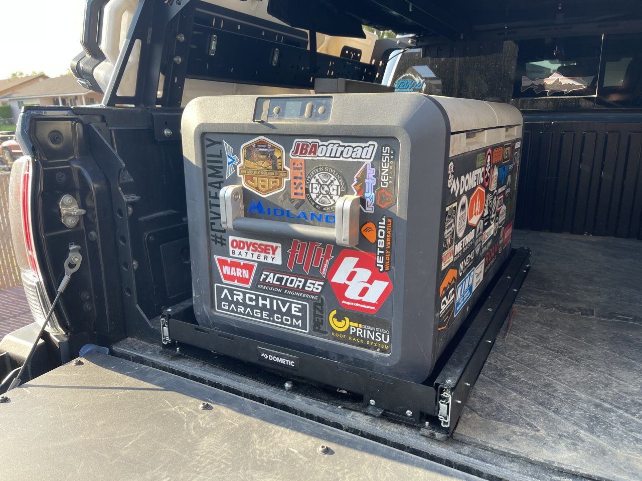

    FINALLY got my fridge slide. Had to chop up my bed mat to fit, but super stoked for it to be secured down and easily accessible now. That was like a 3 month backorder.

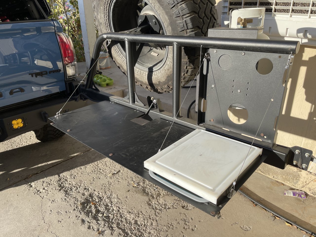

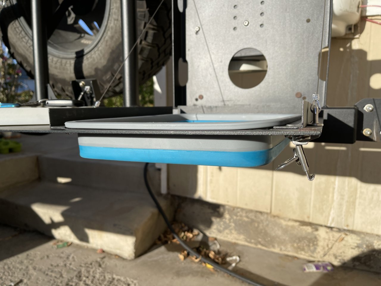

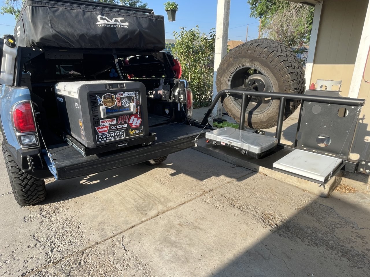

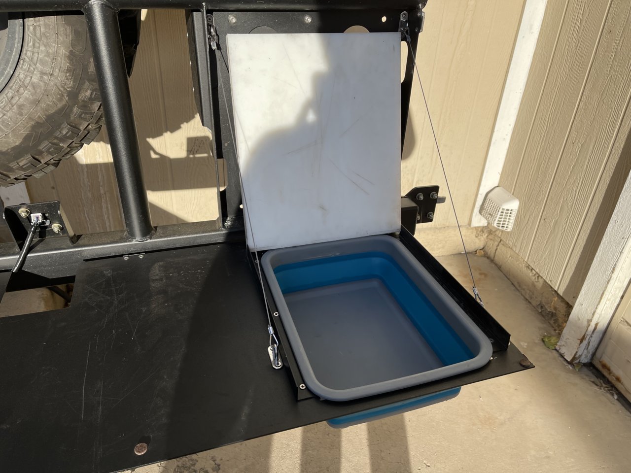

    Did some minor tweaks to my setup. First is the tire carrier table. I still need to sand the edges, paint it, and add some edge trim. But I added a collapsible sink. Works like a charm…. One less thing to pack. Collapsible sinks are all over Amazon in any size you want.
    Space is at a premium with 4 people and 2 dogs so being able to save any space in my Roam cases is a win.
