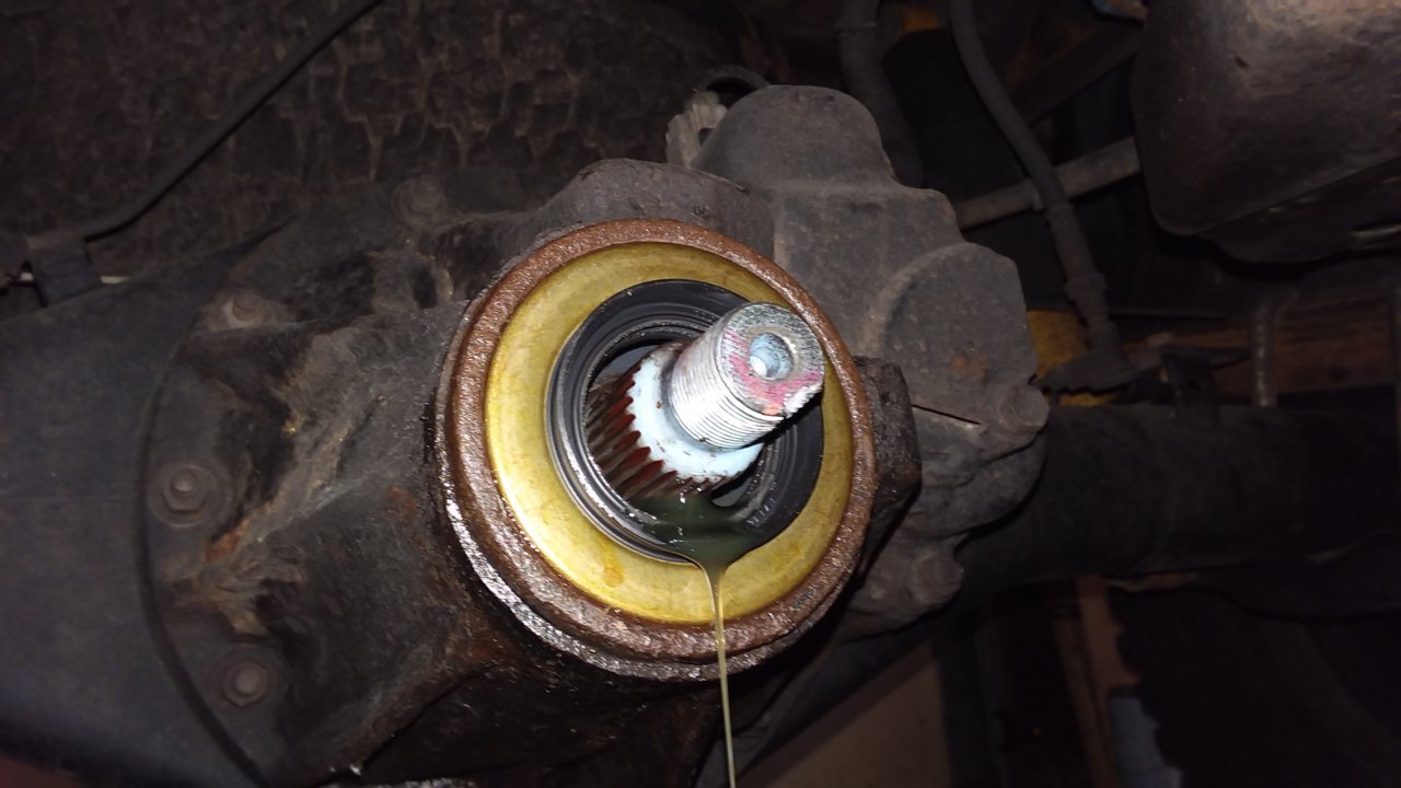

    Sometimes I get frustrated with maintaining an old truck! This week is one of those weeks.

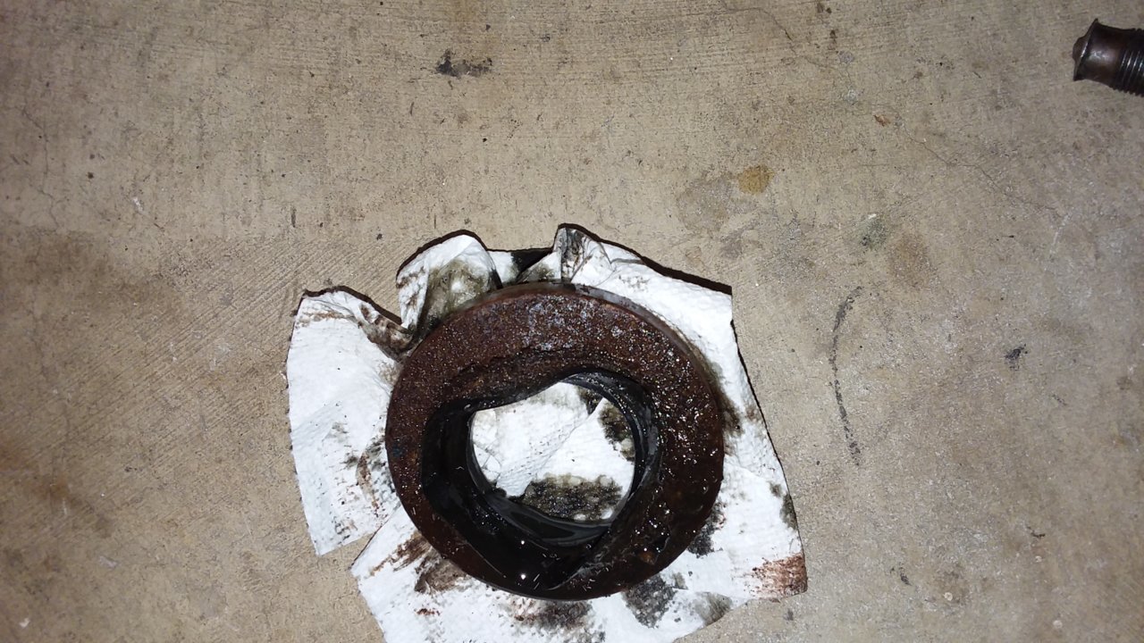

    My pinion seal has been weeping, but not too bad. I came out to the garage the other day and found a puddle underneath it!
    I didn't feel any unusual play in the pinion, so I decided to do a booty Fab repair and just replace the seal.
    Turns out that the seal was pretty crusty and looks like it may have rusted through! Hopefully problem solved and lots of happy miles to come.
    Next up, 4 degree shims in the rear axle to get rid of the vibe that probably caused this, and a new steering rack that has been sitting in a box for 2 months...

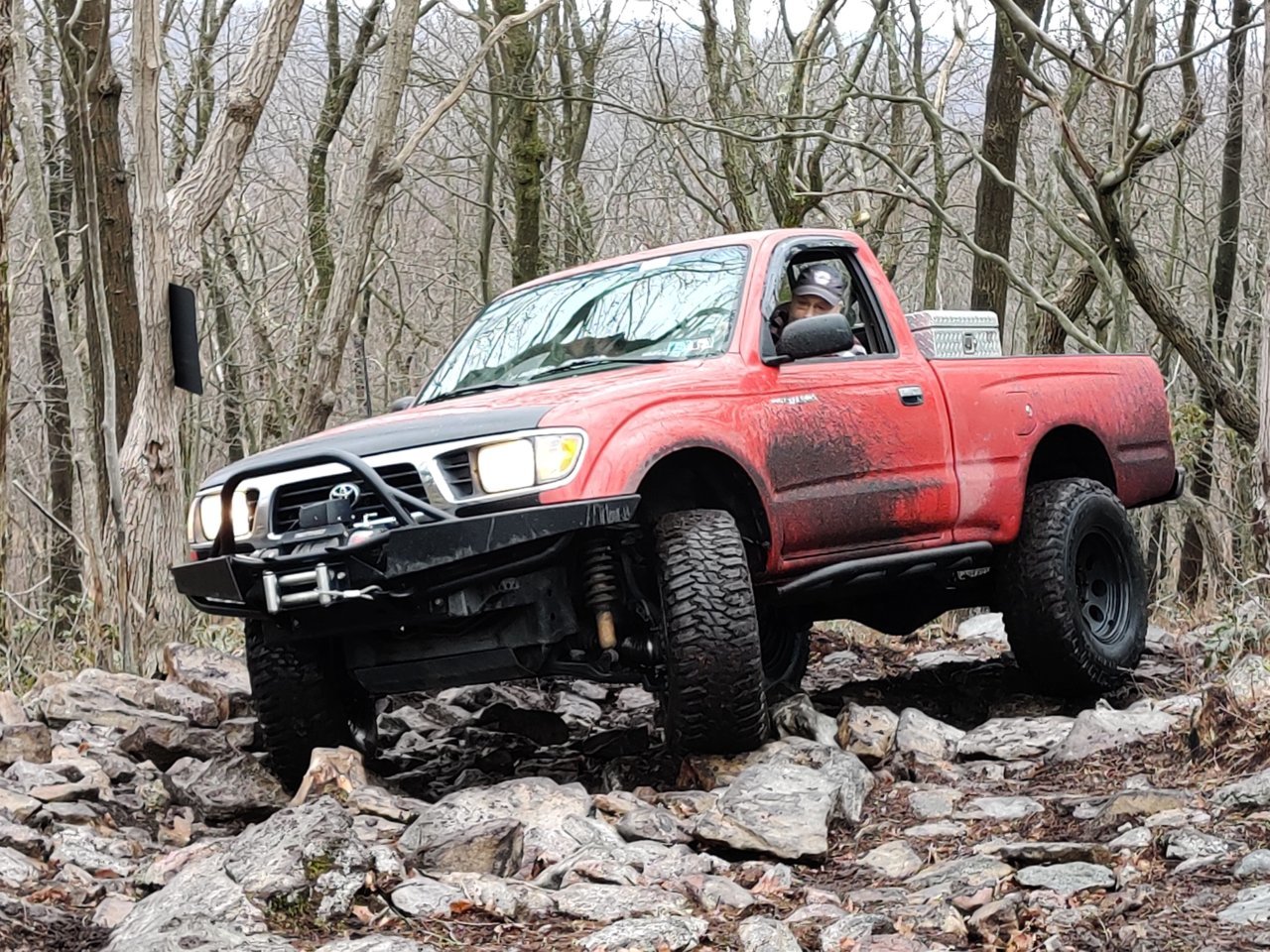

    Spent the day on the trails with the club. It was good to finally meet @El Dahs today!
    Pinion leak is gone, the 4 degree shims have fixed my driveline vibes.
    No action shots yet, but at least a picture of the truck, dirty!

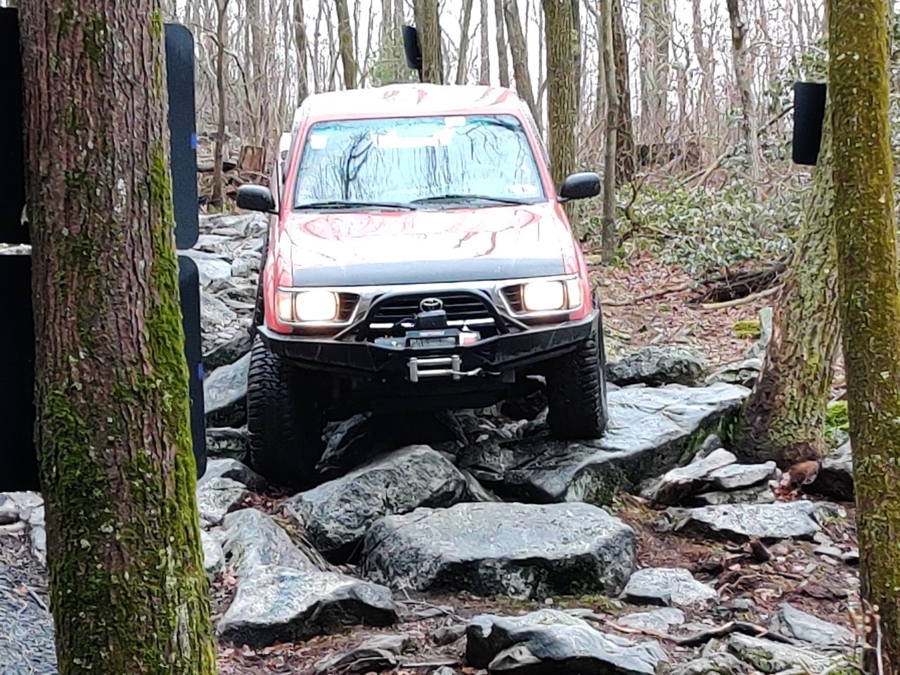

    Hit the trails again yesterday with a 2" dusting of snow. Made things a little more interesting!
    4 trucks, we hit a lot black trails at Rausch Creek. Snake Bite, Camel Back, Krawlin for Cops, Tombstone, Boot Hill, 25, 101, etc.
    Truck did great, it always amazes me! Still have a steering noise - it is now a rattle on washboard type stuff. I am guessing it is the steering shaft at the slip joint, but I also have a new rack sitting in the garage waiting for me to install....

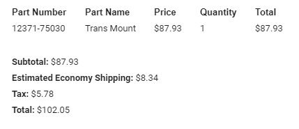

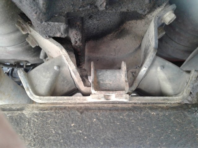

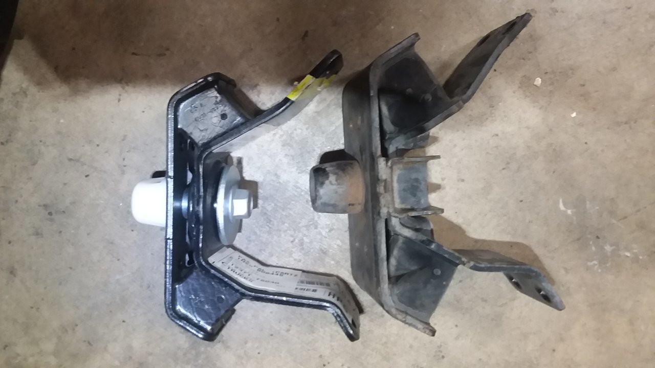

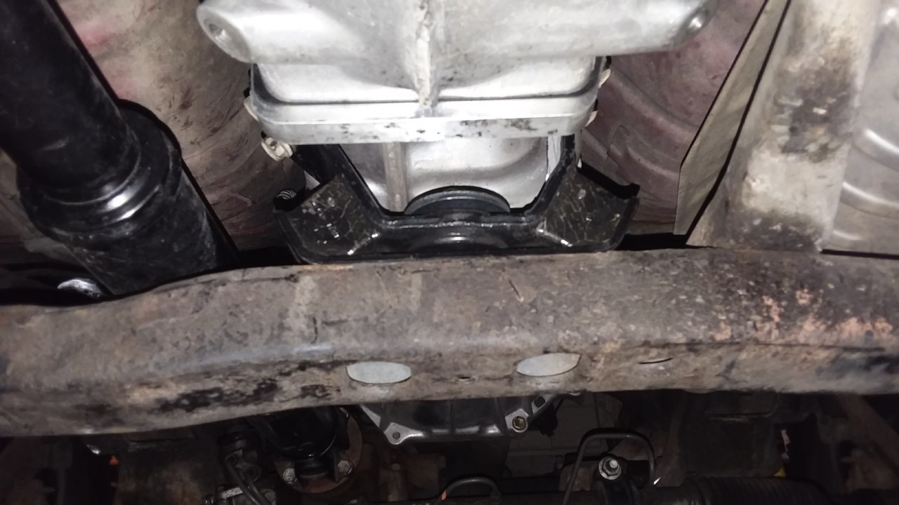

    Replaced my cracked transmission mount this morning. Had trouble finding one that Toyota still has in stock.....
    Here is what I used and it was perfect!
    Old mount
    Comparison
    New installed

    Your original trans mount looks weird. I've never seen one like that.
    The on my truck is the same as the one you got as a replacement.
    Need to replace mine too. Pretty sure it's shot and lifting the whole drivetrain when I get on and off the gas hard.

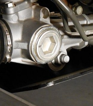

    Finally got around to installing my new rack.
    FYI, a leaking rack will destroy an inner tie rod in less than 1000 miles!
    Looks like my minimalist skid plate is taking hits well!

    Your new rack looks like it might be the old style of internal guide (the big external hex head)
    I could be wrong, but from my understanding the new style ones have have an internal hex
  19. Mar 16, 2020 at 4:03 AM
    #199
    cazinpa
    cazinpa [OP] Well-Known Member
    Dec 5, 2016
    #204074
    430
    Andy
    Lancaster, PA
    '96 Tacoma
    A few tweaks
    Yeah, it is. I have the parts to swap the guide in my old rack. Didn't want to void the warranty just yet though! Will eventually get to that...
