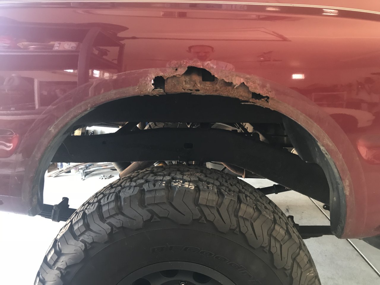

    Fix it asap. Mine progressed very rapidly. I think wheeling tweaks the bed in this spot and makes it rust fast. Mine went from flawless to this in a year and a half!

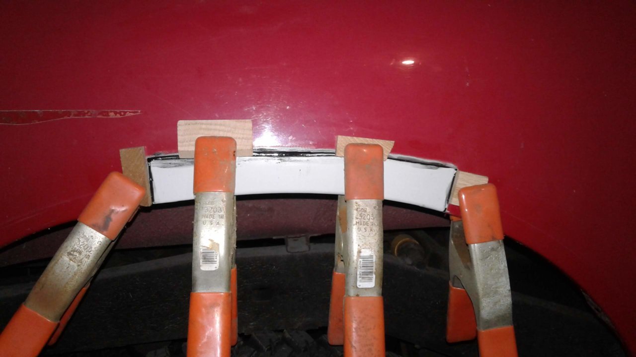

    Should know this weekend. I finally got them glued in last night. Need to get a few supplies and move on to the filler.

    I'm going to have to do a little at the bottom corners to fill in, but otherwise I used the 3m panel adhesive shown a few posts back. Pretty cool stuff!
    I cut off the support that used to be in there and am not supporting the new with anything but the plastic inner fender. We'll see how it goes...

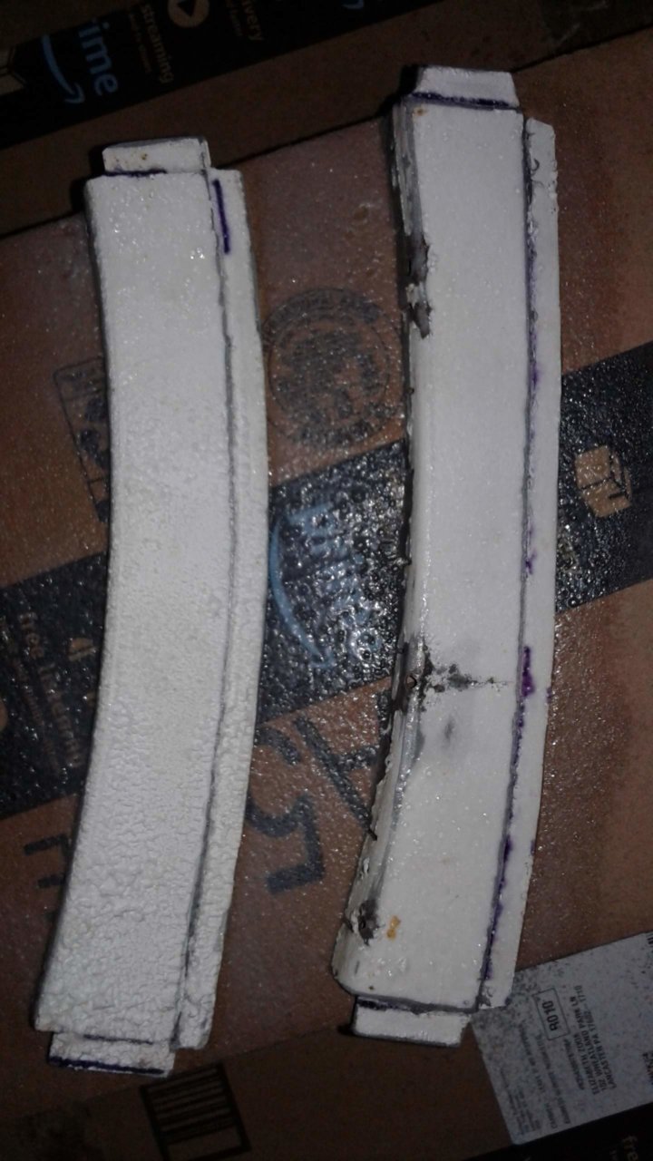

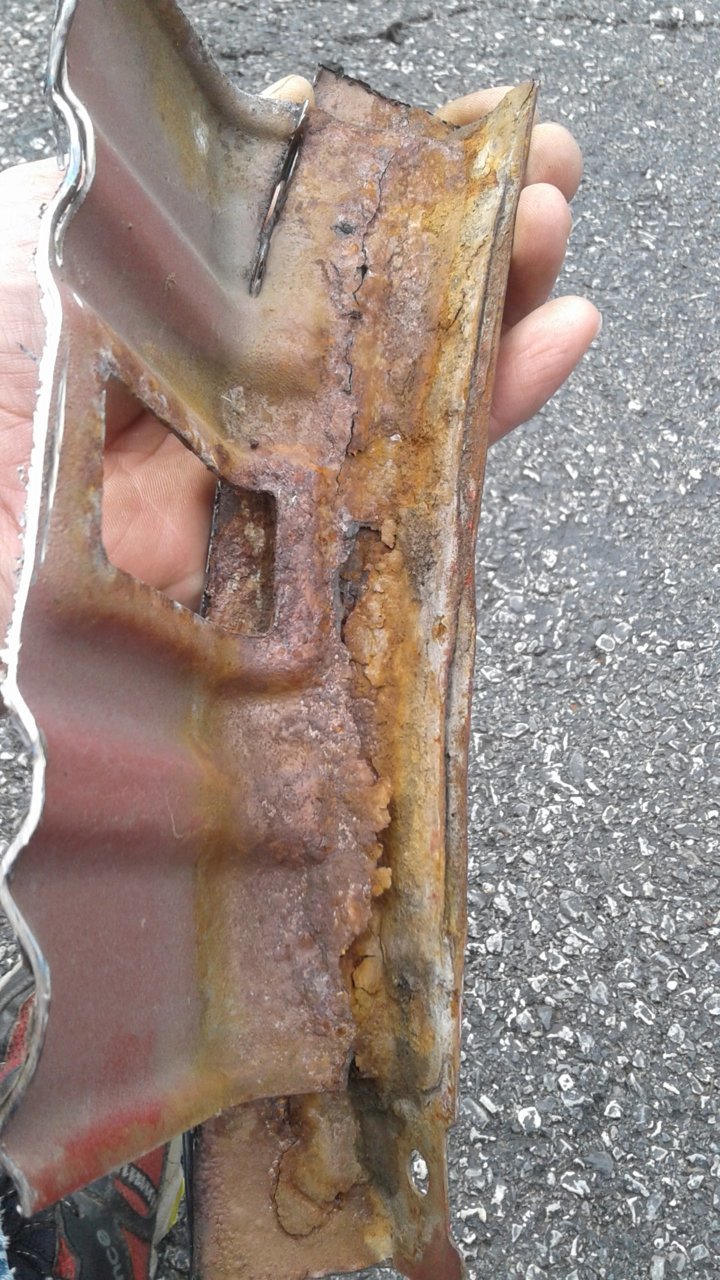

    I flanged the patch panels to go in behind.
    Here is a picture with stripper on them. I stripped them to bare metal and used an epoxy primer.

    My passenger is to the point that I need to just do it. This morning a small peice of the bubble rust fell out so there's a small hole I can see right through. It goes about 1" above my OEM fender flare for about a 3-4" section.

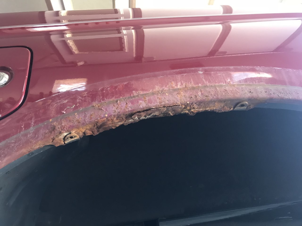

    Yeah, mine progressed really fast. It was bad - I had a paint bubble appear the day I cut it out. I pressed on it and water squirted out!
    The paint on the front was holding the rust flakes together.
    Here is the back of one of them - where my fingers are is the inside of the fender lip. The support is on the left - you can see where I cut it off.

    Damn that's a of rust in there. Mine probably looks the same inside. How do the fenders feel without that support? Is it noticeably more flexible?

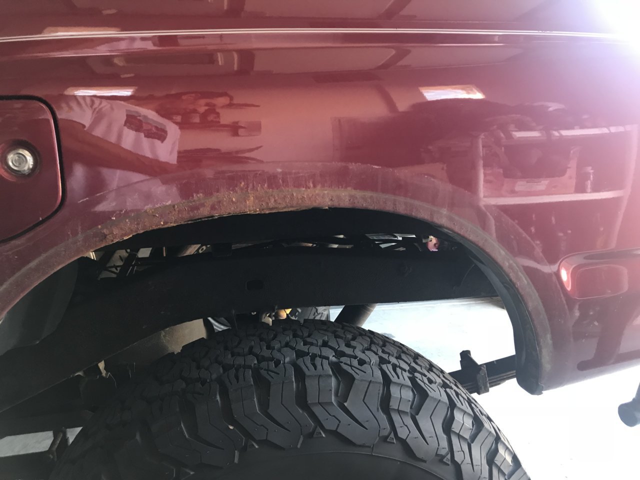

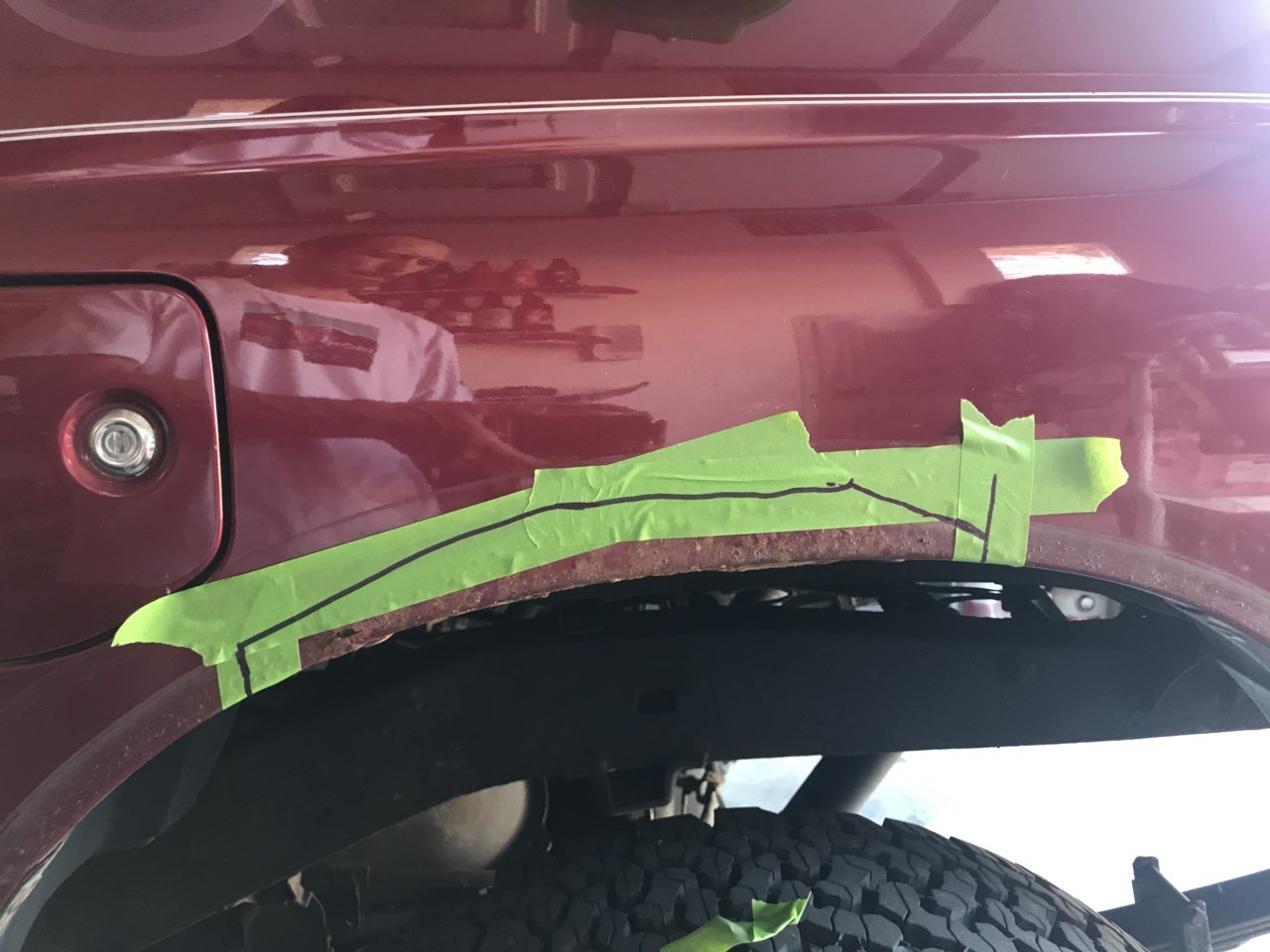

    Pulled my flares off this afternoon. Passenger is worse than I thought. Drivers is not as bad. It’s mostly on the bottom. Could probably be covered back up by the flare. What do you think about this?
  16. Jun 20, 2018 at 4:50 PM
    #76
    cazinpa
    cazinpa [OP] Well-Known Member
    Dec 5, 2016
    #204074
    430
    Andy
    Lancaster, PA
    '96 Tacoma
    A few tweaks
    Dang, that's way worse than mine was. Even your good side is worse...
    I'd fix it asap on both sides. It is worse than it looks behind the "good" side. Best to fix before it reaches the visible area beyond the flare.
    Mine is limited to the arch around the wheel well and the patch doesn't extend past the radius in the body where your flares stop so would be hidden.
    Is that rusted all of the way over to the gas door?

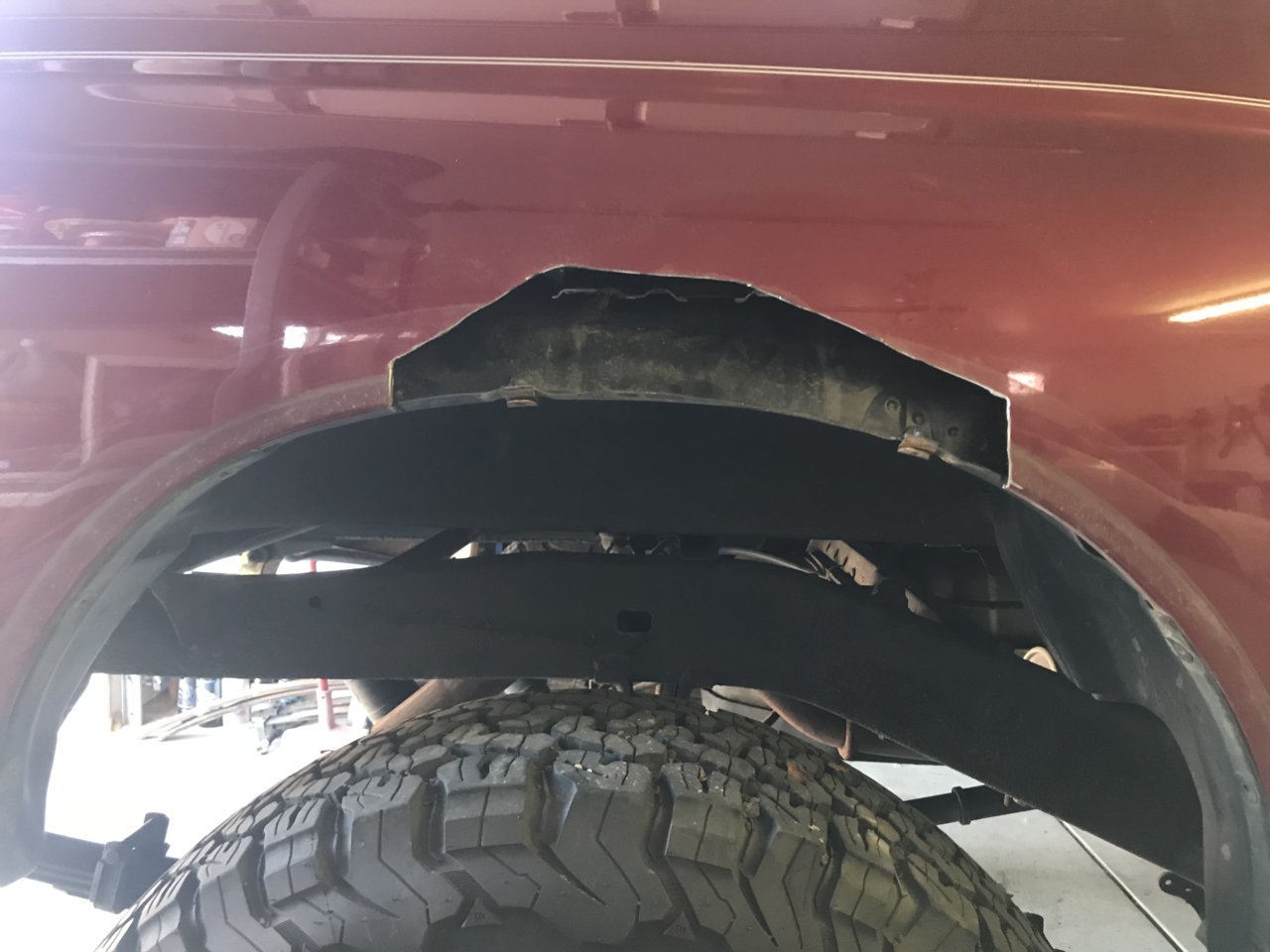

    This is the drivers side I just cut up. 2nd pic the passenger marked for cut. It’s pretty close to the gas door. Just before it.
  18. Jun 20, 2018 at 5:26 PM
    #78
    boostedka
    boostedka Well-Known Member
    Sep 29, 2011
    #64367
    6,064
    James
    NM
    2013 DCSB 6MT, 2004 4runner
    And cut. Looks like it’s below that flare line.
    I still need to cut off more of the fender support as well since it's pretty rusty.
    What really worries me is that the passenger side has some rusting on the back side of the actual bed just about the wheel well plastic.
