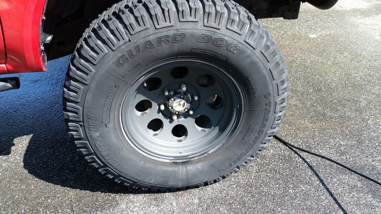

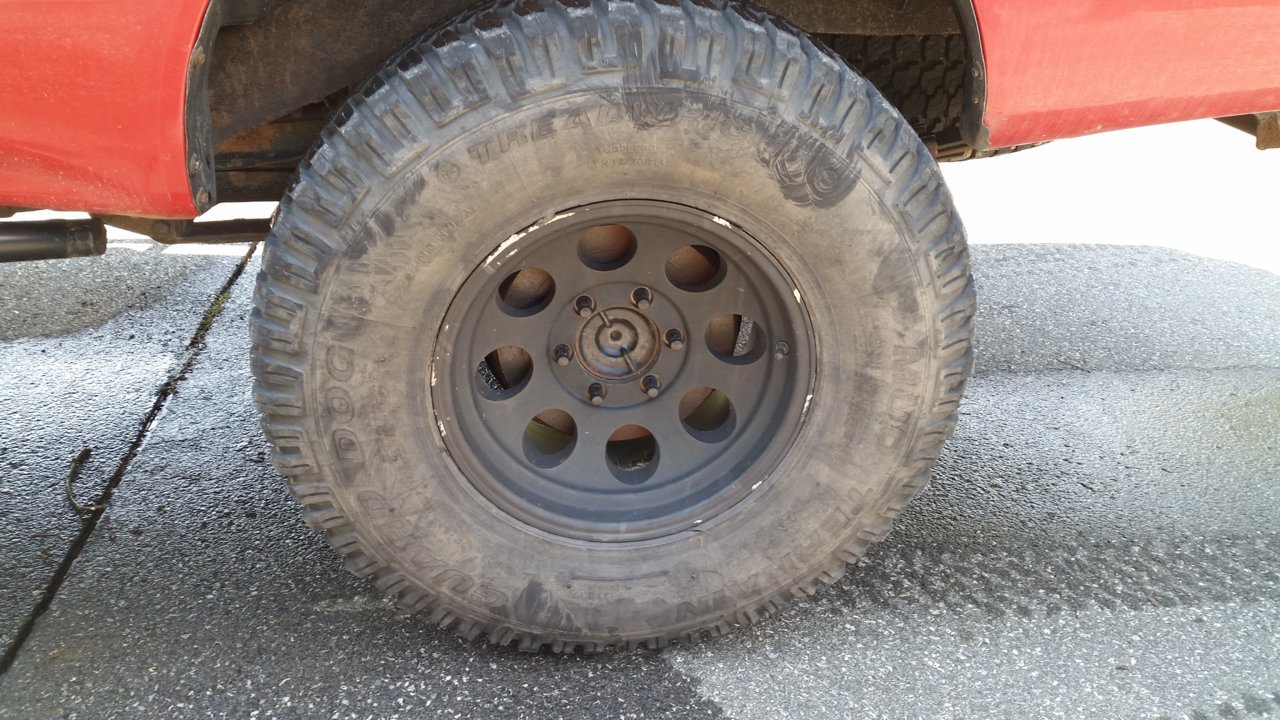

    I like to keep my tires looking good, and pressure washing alone does not get rid of the coal mud stains from Rausch.
    I've been using Bleche Wite on my tires for years, it is so good I am amazed every time I use it and thought I should pass on the tip.
    Here is after pressure wash only....
    After Bleche Wite and pressure wash...

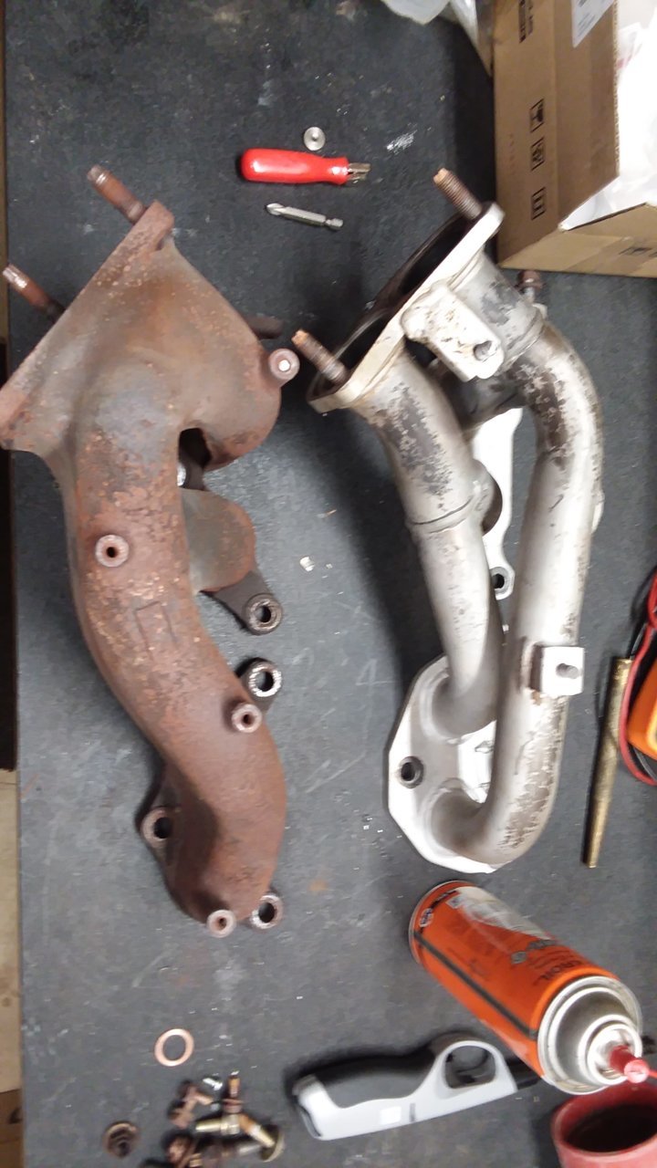

    Been planning a complete new exhaust, and this showed up yesterday to replace my likely cracked cast manifold. Looking to order the other pieces soon. Cat has been rattling since I bought the truck.

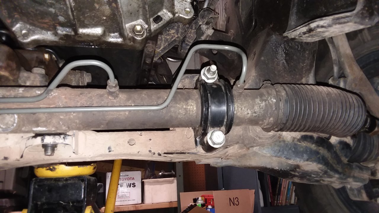

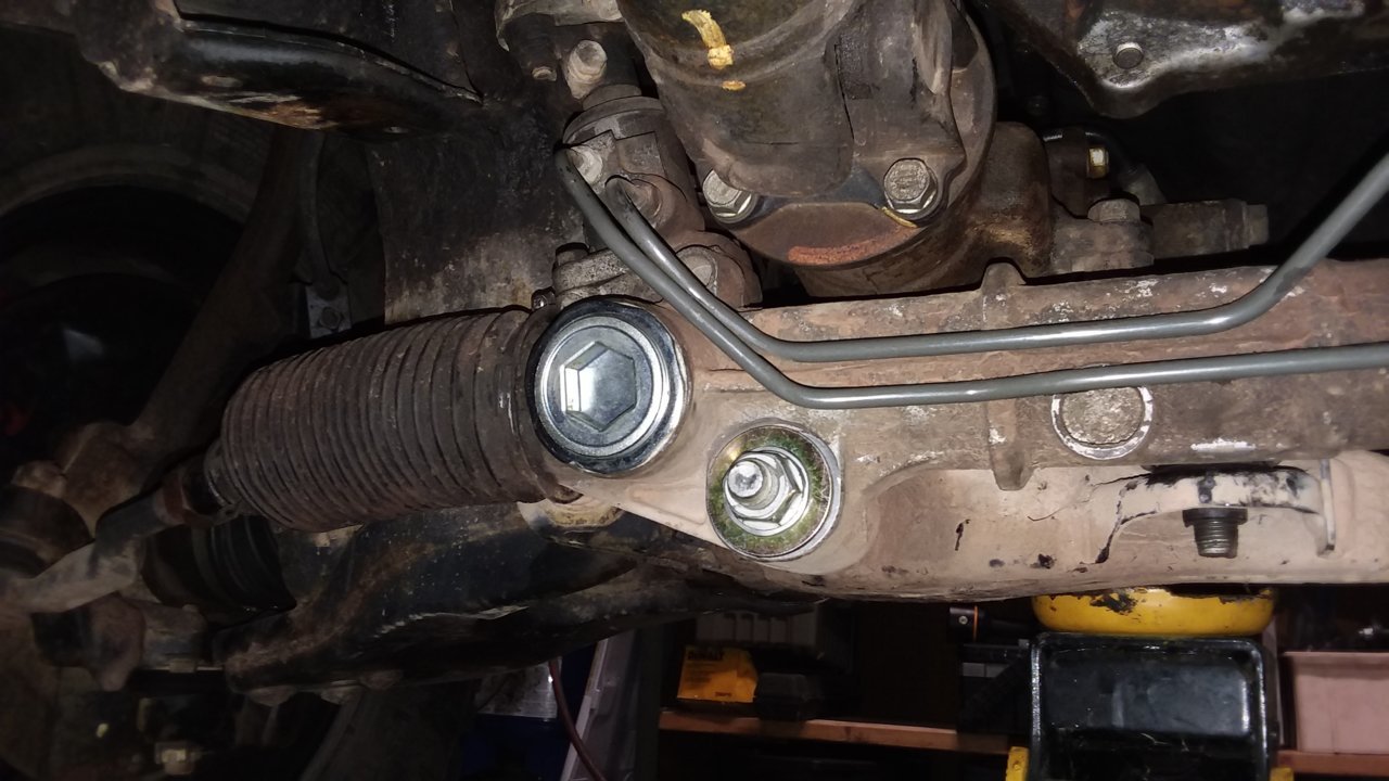

    Not too exciting, but I had a garage night last night to install some parts that I've had for a while!
    Installed new rack mounting bushings and a new rack guide. Mine was the roller style. I could definitely see why I had up and down play!
    Hoping it drives tighter and most importantly it flys through state inspection.

    #114
    DJB1
    DJB1 Well-Known Member
    Jun 8, 2013
    #105835
    2,223
    Dave
    SLC, UT
    2003 Regular Cab 4X4 5MT
    That’s one of my favorite mods I’ve done on mine. The stock steering rack bushings are squishy and don’t age well. With new bushings your steering will feel like a sports car instead of a farm tractor.

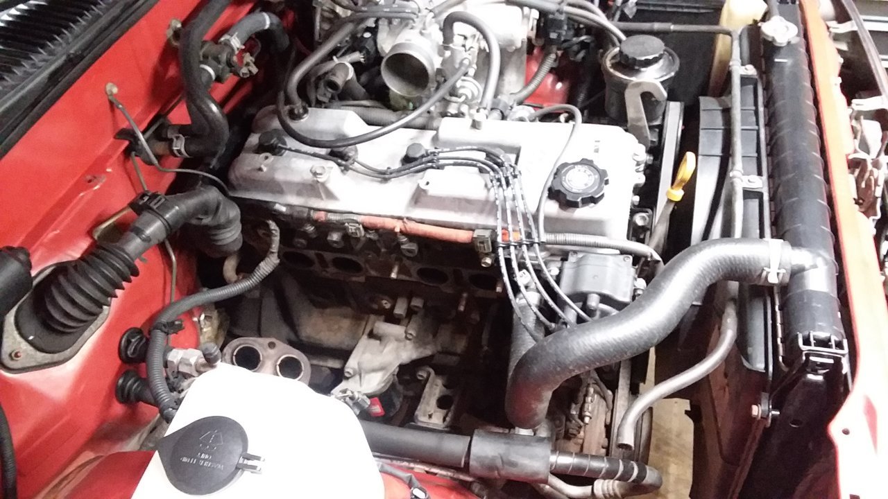

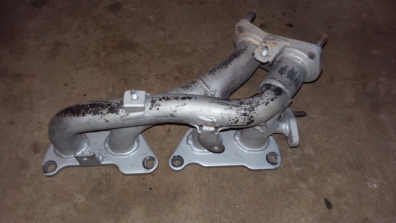

    I am replacing most of the exhaust. I bought a later model tubular manifold from a forum member a while back and am upgrading from the crack prone cast one.
    Also replacing the cat and muffler/tailpipe.
    Got the manifold removed, parts are on order!

    Does anyone know if the newer tubular exhaust manifolds are Stainless? The one I bought is painted, but if Stainless I think I will just sand blast and leave it bare.
  18. Jan 7, 2019 at 7:42 AM
    #118
    Ritchie
    Ritchie Well-Known Member
    Dec 24, 2012
    #93649
    1,931
    San Diego (North County)
    RC Step side Pre-runner
    2.7 w/auto, 4WU 3 link, F & R Diamonds, ARB's F/R w/ Yukon 5.29's, Inchworm 4.7 Lefty, Deavers, ARB OBA, Schrockworks up front.
    My OEM unit was stainless. It discolored and looked awful.
    I went with a Thorley header that is ceramic coated. The cost to coat the OEM part was more than buying a new header that came coated, go figure.

    Ok thanks, that's what I needed to know! Gonna try the Eastwood hi temp coating.
    Hoping to have all the parts to knock it out this weekend.

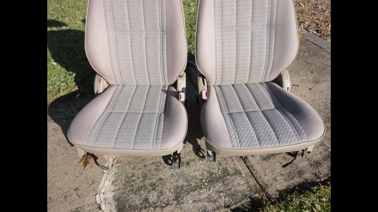

    I put my time machine to good use today. I went back and grabbed these beauties!
    After 2 years of semi-dedicated looking, I found these seats this weekend. They are even better looking in person. I'm pretty excited!
    One of my winter projects is to revamp my clapped out interior. These put me off to a great start!
