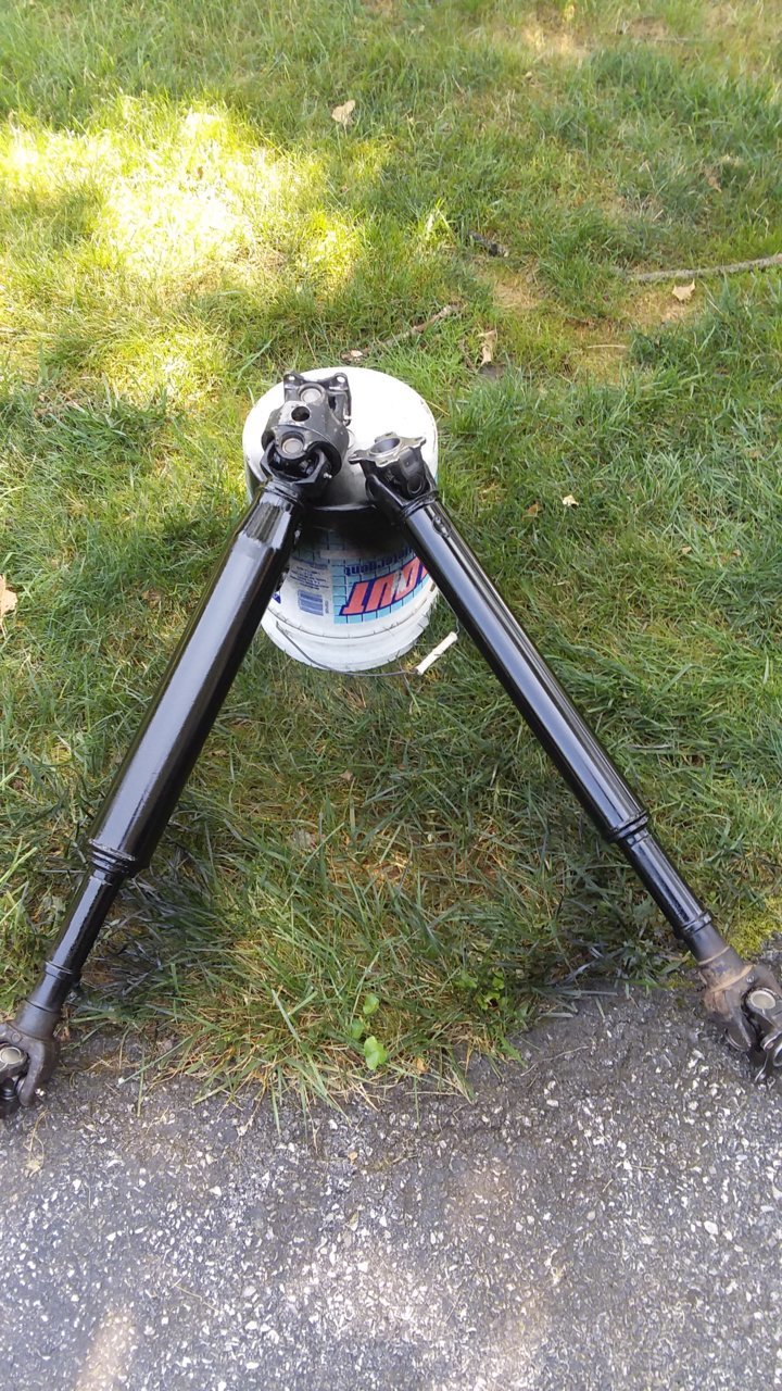

    Driveshafts are lengthened/shortened and all new ujoints installed - even the CV!
    I shot a quick coat of paint on them today.
    Hoping to be driving it again within a week...

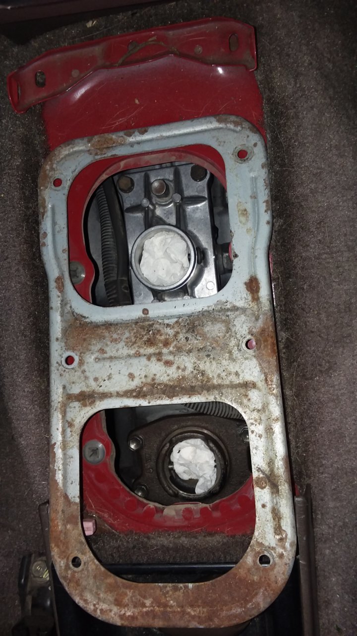

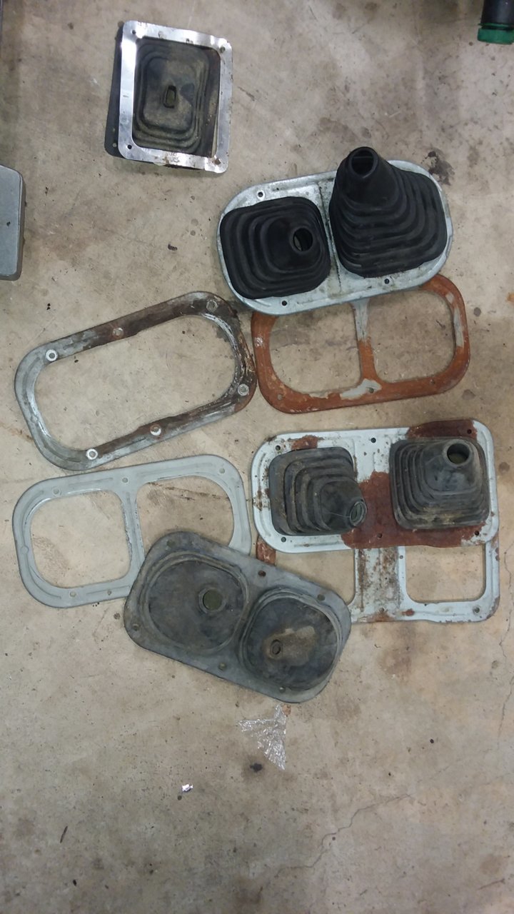

    I think I've been at this game too long....

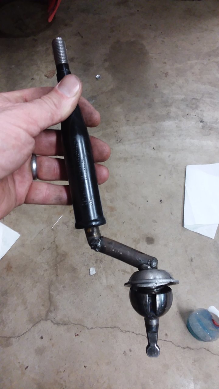

    Went looking for a shifter boot in the barn and found a bunch!
    Looking for opinions -
    Shifter boot from a top shift case truck looks like it would be the right spacing. Go with this, or mod the shifter to come out the original hole?

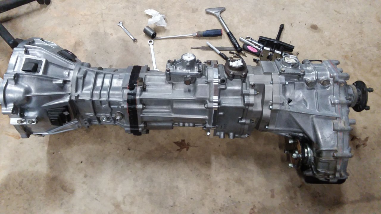

    She lives again after 9 months!
    Buttoned things up last night with the help of my oldest son (11yo).
    Summary:
    Clutch
    Flywheel
    Rear main seal
    Tranny seals and shifter seats
    Crawl box
    Rebuilt driveshafts with all new ujoints
    Tubular exhaust manifold
    New cat
    New o2 sensors
    New muffler/tail pipe
    Poly steering rack bushings
    New rack guide - updated
    And I'm sure some other stuff I've forgotten!

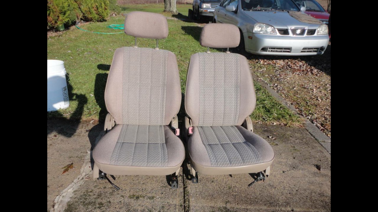

    Next up is new carpet and the new seats I bought last year.

    Bucket seat are so much more functional than the bench in a reg cab. It makes the storage space behind them so much more usable and easily accessible. Plus they're way more comfortable of course!

    Indeed. I already have the same buckets, they are just shot. They look like they have every bit of 280k miles on them!

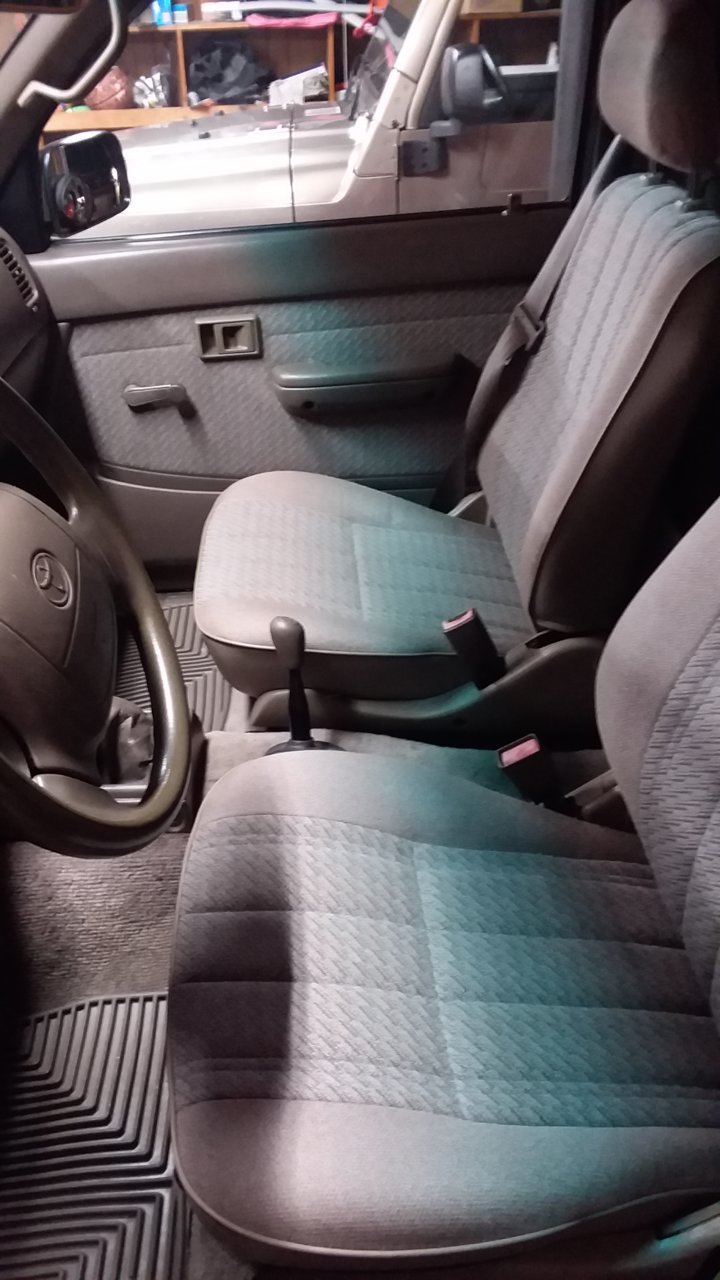

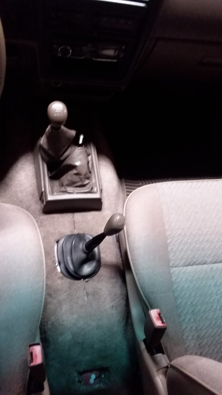

    Finished up some details.
    My bootyfab shifter relocation
    New seats installed!

    You planning on fabbing up a center console to fill the remaining space between the seats?

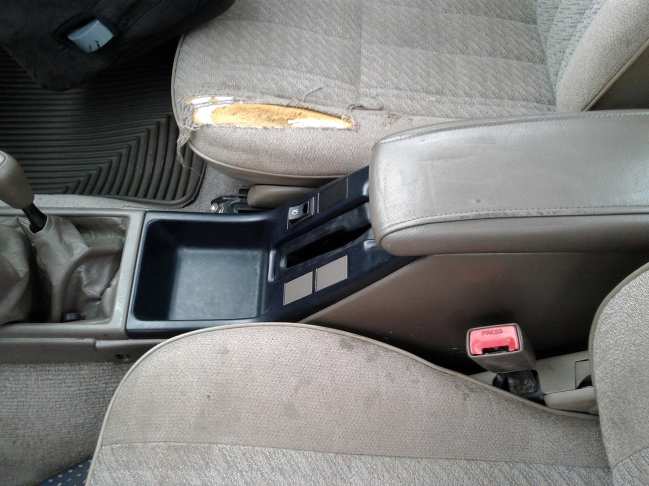

    Trying to figure out what to do there.
    I have a 4runner console and the part where the e-brake comes out unbolts. Thinking maybe I can do something there.
    Also have this guy
    betterbuckleup likes this.

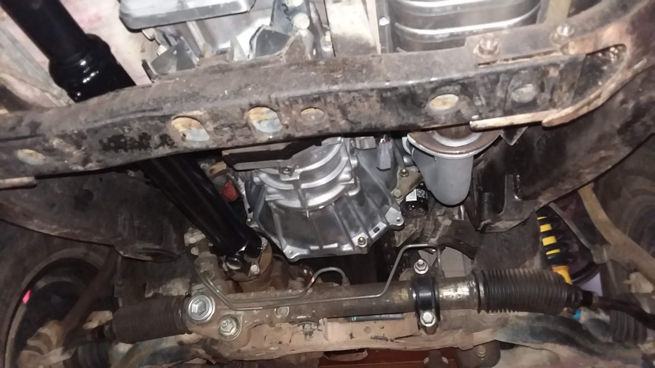

    Yup, I did! I had it out a few weeks ago on a club run. It rocked!
    Fighting a vibration right now - have some 4 degree shims to put in the rear axle and am hoping this fixes it.
    Also have a leak despite my extreme efforts to prevent it!!! Not bad, but there is usually a drip hanging from the crawl box.
    Only one picture from that day. Not much to look at, but something to make this post more entertaining ;-)

    After I installed my Inch Worm 4.7 case, I too had a small drip. Turns out that there are 2 allen plugs for the adapter plate that required some silicone before tightening into the plate. Once I did that, all good.
    Hope this helps you.
