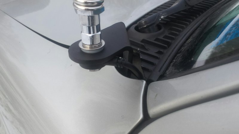

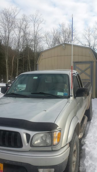

    Here's a couple of mine

    Thanks man, I'm liking this mount! Can you give me info on how it is installed, there's nothing on CBIs website. Does it bolt up to existing holes? It also looks like you had to cut some plastic to install it?

    2003 Lunar Mist Tacoma DLX

  12. Feb 25, 2017 at 6:49 AM
    robupstateny
    robupstateny Well-Known Member
    Dec 25, 2016
    #205636
    561
    Rob
    Upstate NY
    Gray wire mod, Gentex 177 mirror, cupholder from @bradrn22, custom dog seat., AJT Design shift knob., Cb install
    Probably easier with another set of hands. Mine was a real pain the butt, because I was doing it alone.
