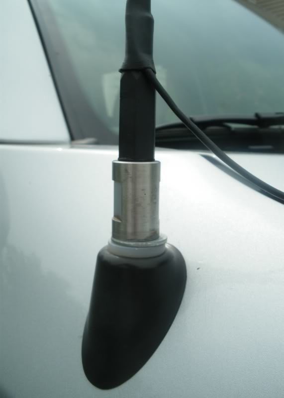

    Anyone have this setup for their truck? I thought it would be the best place to put a firestik cb antenna (good ground, would look stock, etc) and use the firestik splitter to use the cb antenna for the radio as well.

    Why not just get a hood mount for the Firestik? Then you could remove your stock antenna and still use The Firestik for AM/FM. Sorry I'm not much help but I'm just not sure how you would mount a CB antenna in the stock location. It's a small plastic mount that wouldn't be near big enough or strong enough to mount a Firestik.

    That little 5mm antenna bolt is not going to hold a Firestick for long.

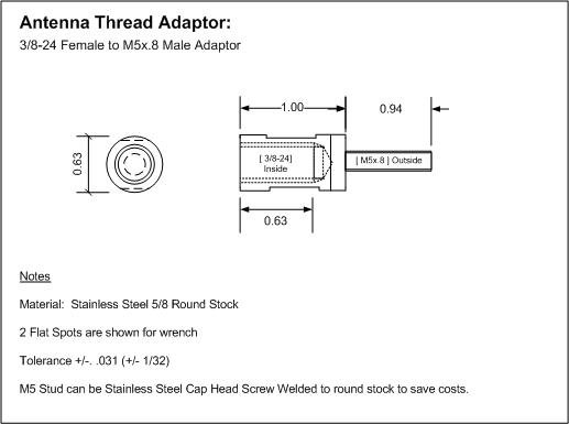

    well im planning to get rid of all the stock antenna shit all together. im thinking i can get 2 firestik stud mounts (2nd one really just for the coupler) mount the stud mount below the antenna base in the fender (with a 10mm washer to keep it from going thru the antenna base), get a 3/8" threaded rod, cut like an inch or two off depending on how deep the antenna base is, put 2 10mm washers on top of the antenna base, with the 2nd coupler on top of them, keeping the 2nd couple above the antenna base, then just screw in the 2' firestik like you normally would to a stud mount, into that second, extended coupler. i have the firestik matchmaker splitter, and can then just plug the cables in and done. i think i can make it work. could you follow that? i may be wrong..
    let me try to get some pics showing my idea...
    similar to these parts.. you kind of have to visualize our trucks antenna base insted of the one pictured but you get the idea..
    from left to right...
    - stud mount screws into coupler #1
    - 10mm washer goes on top of coupler #1
    - 3/8" rod goes into coupler #1, over 10mm washer
    - antenna base goes over 3/8" rod, sits on top of 10mm washer
    - +2 10mm washers go on 3/8" rod and sit on top of antenna base
    - 2nd coupler threads on 3/8" rod above 2 10mm washers, on top of antenna base
    - 2' (or however big you want) firestik goes into 2nd coupler like one big happy family...

    Looks like it should work as long as you can keep the center conductor isolated.
    I'd be a little concerned about the thin sheetmetal, but that can be doubled up on the inside.

    yea, the plan would be for the antenna base to isolate the center 3/8" rod. only cut it to size just what you need... if any extra i guess i could just use washers to fill in the gap.
