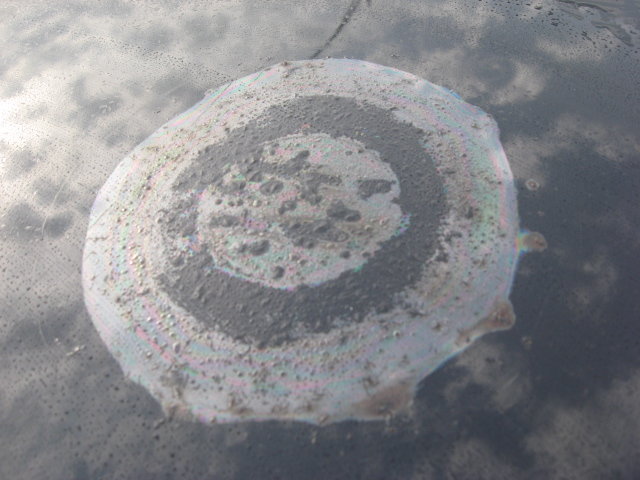

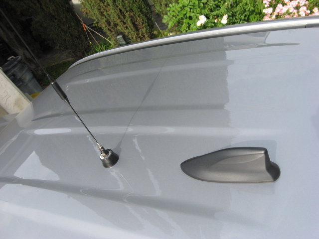

    Hey Baxter since no one replied, I will, I hope you removed the mag mount as the picture shows what it can do to paint. Picture is from my older Toyota. It ate the paint and left a nasty rust mark. I did a clean install on my new truck by drilling a hole just forward of the sat. antenna. The NMO mount is for the 18" ham radio antenna and works well. For CB the side rail bed install works OK but not the best location. Middle of the roof is best, on a roof rack works too..The truck bed seems popular and you need to make sure it gets a good ground. FWIW: You might want to look into getting a ham license. Easy to do and CW is no longer required. I got away from CB years ago and never looked back..Works way better and you have lots of bands to choose from..If you need CB, a hand held will work when four wheeling..Me; I'm sticking to my FT-857...
    NMO antenna mounts work and looks much better, dual o-rings keep water out...

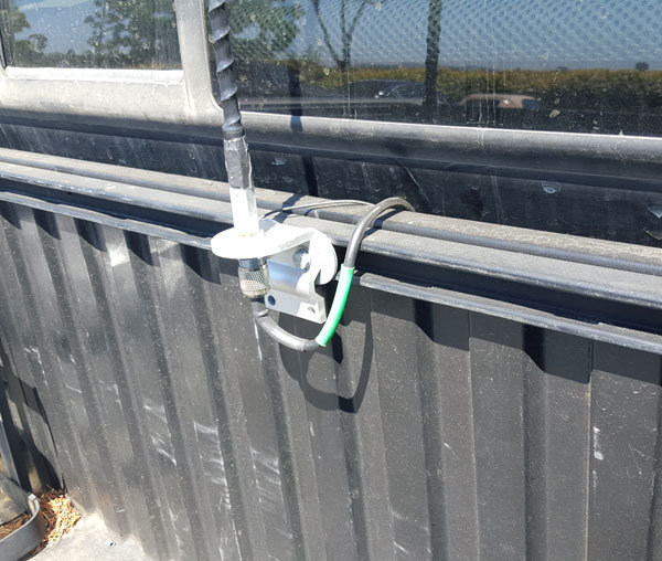

    Yes OP, you can mount it to the rail behind your cab. You don't have to ground it to your frame, either. Any of the little screws in that gap between the bed and cab will generally work. I half assed the setup in the picture with some extruded u-nuts to hold tight inside the rail and braided 16 gauge wire that's way too long for a good ground and run an average SWR around 1.8 which is good enough for me, but ungrounded it lingers in the 3+ zone. Hope that helps.
