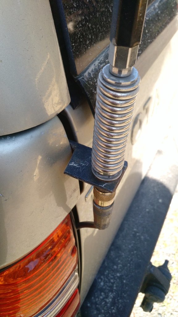

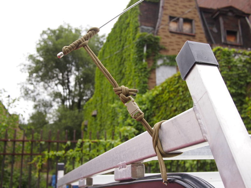

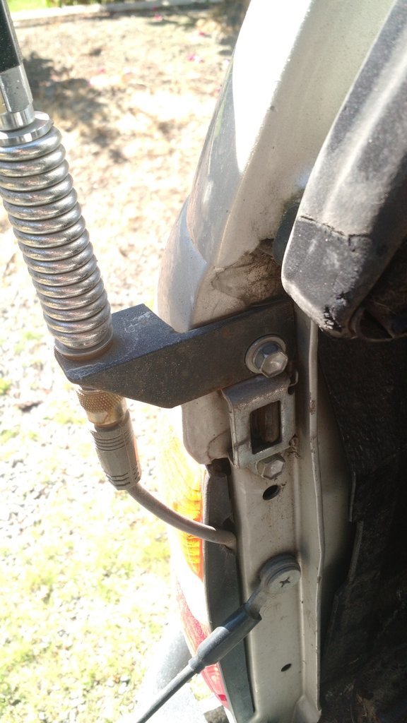

    weldo
    weldo Well-Known Member
    Oct 15, 2014
    #140423
    1,337
    Pittsburgh, pa
    2014 base ac 2.7 5-speed 4x4
    Finally a pic of my setup! I was inspired by @MatthewMay1
    I had to grind paint off of the bracket and bedside where it bolted and the underside of the tailgate bracket where the stud contacts. I checked resistance from the stud to a good ground on the frame and had good continuity. Performance seems pretty good though reception around the city isn't too great. Picked up a few truckers near the highway that came in nice and clear. Probably about 2 miles away or so.
    I checked SWR without the spring at first and it was around 3. With spring added it went down to 2-2.5 depending on what channel. I'd like to lower it further but I'm guessing I'd have to lengthen the mount slightly. Maybe a spacer of some kind?
    To tie it down I used some paracord and a small fastex type buckle. I like to say it's "deployable"!
    And a piece of foam weatherstripping to insulate the lower part from touching any metal. The weatherstripping is temporary til I think of something better. Can that affect performance, the weatherstripping covering some of the antenna?
    Jaysjammin and MatthewMay1 like this.

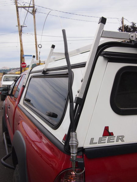

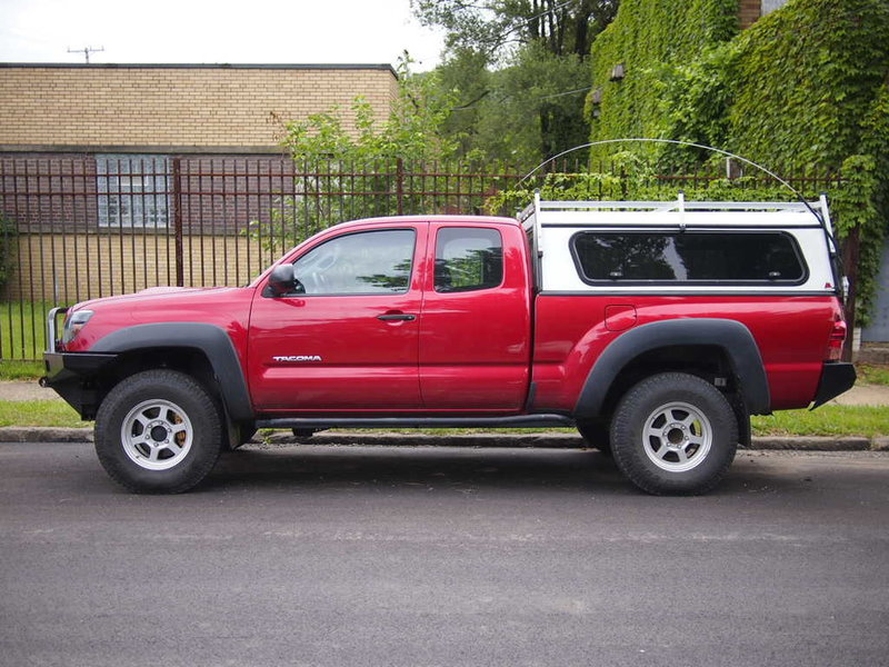

    MatthewMay1
    MatthewMay1 I'm an amateur professional.
    Nov 21, 2011
    #67486
    11,111
    Matthew
    Lone Star Republic
    Supercharged '01 TRD
    Nice. I got better SWR without the spring. Your reading is probably higher than you want because of the shell and rack
