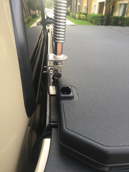

    While the tonneau cover for the '16 is nice, it is also a complete pain in the ass when it comes to mounting a CB antenna.
    Where are you guys putting your CB antennas? Is there anyone making antenna mounts for the 3rd gens yet?

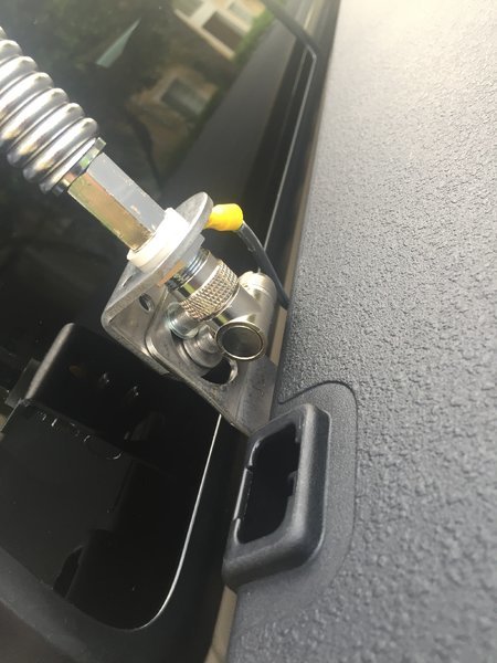

    Thats my rig, I had that issue until i tried putting the bracket between the black plate. no rubbing and plenty of room to open and close the tailgate

    I changed locations for the mount and it's much better.

    I like that. Did you bend the bracket? How does it attach?

    I put it in a vice and hammered the angles flat to make it a 90 degree bend instead of two 45's. This keeps it from being to close to the cab and elevates it enough to clear the cover. I drilled holes with a 5/16 bit and used self tapping screws to secure it.

    It was the firestik mount from Amazon. It sucked profusely. I ended up going with a tail light mount from C4Fab.
