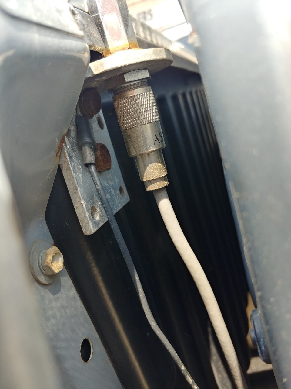

    Hey there everyone, just wondering if anyone has any ideas for CB Antenna mounts, I know there are a lot out there online, BUT I am trying to mount them in the bed (towards the cab) and have the mounts come out from my bed cover! Let me know if you have any ideas! Thank you in advanced!

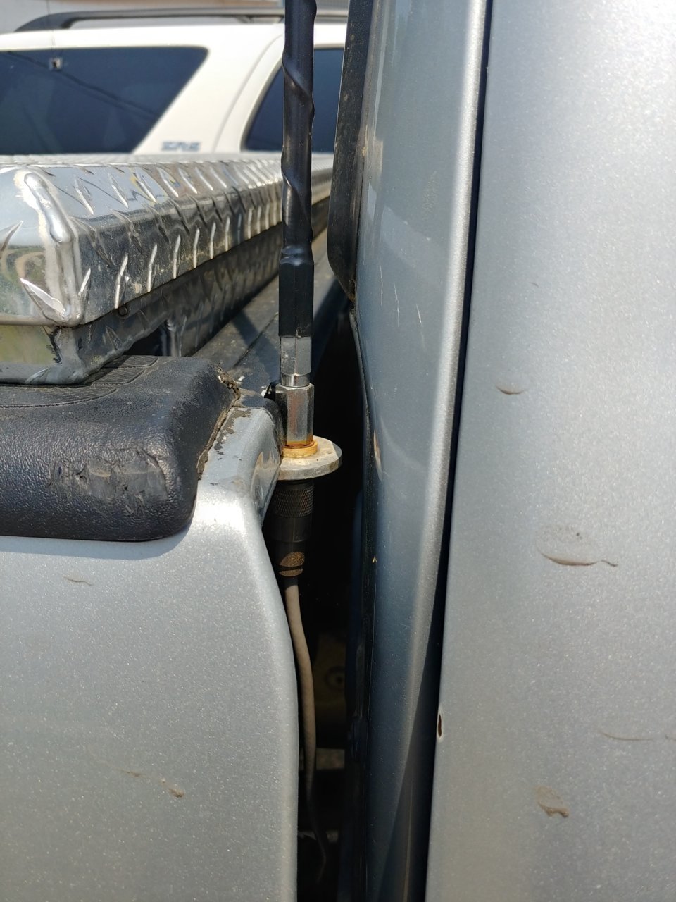

    i have dual antennas mounted in between the cab and the bed. i used the mounts that come with the cb antennas, but i only used half of the mount. the part that i used looks like an L shape. drill a hole in back of the bed and drill a hole in the center of the mount and bolt it to the bed. looks really nice and you dont see the mounts. i know it sounds confusing so i can take a few pics of it and post it if you want

    yea its tight as balls, i had 2 inches of room to work with. give me a few min, ill post a pic and youll see what im talking about

    Thanks for the pics man! Appreciate the help!
