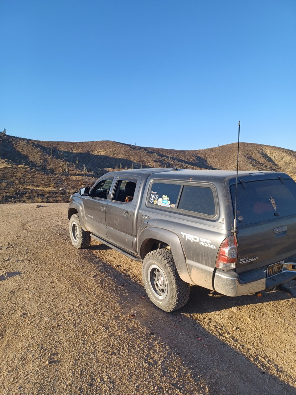

    I had to do this when I set up my cali raised tail-gate mount antenna, like op is looking at . Our composite beds mess up the ground plane big time…

    I think your right about that . They do throw that term ground plane around rather loosely….but it did help me out massively , Mine barely worked and had a lot of interference beforeI grounded it to the frame …

    I've got a cali raised bracket very similar to the setup you are looking at, and a 3 ft firestik. I have never measured SWR, but I've got good enough range to communicate with my buddies when we go offroading, sometimes up to 5 miles or so.

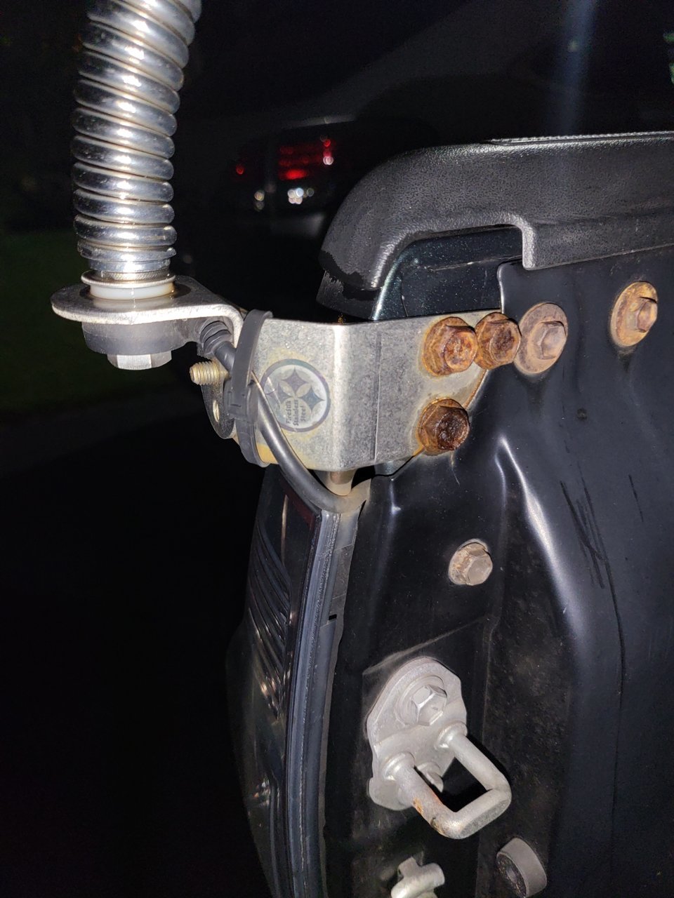

    I used the Firestik Door Jamb mount to mount a tuneable 4 ft. Firestik antenna to the driver's side rear fender, by the tailgate.
