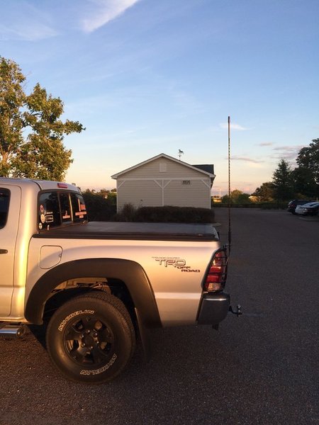

    I have a tonneau on the truck, so my options were pretty limited. Here's how I ended up mounting my 3 ft Firestik. It works pretty decently for what I need it to (relatively short range coms with a couple buddies and listening during interstate traffic jams when I'm curious as to what's going on).

    Looks good MD8 Taco.
    I also have a tonneau cover on my truck. Yesterday I fabricated a 1/32" thk antenna bracket that sits on top of the bed rail and runs under the rail for the tonneau cover and bolts to the forward tie down rail in the bed. With this set-up the tonneau cover will open and close with no obstruction from the antenna or the bracket.
    I just need to be sure I can ground the antenna.
