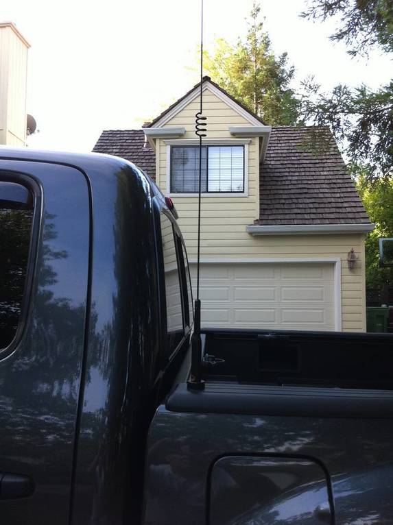

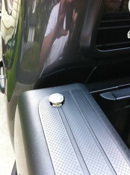

    I ran the cable out the back of the cab and through the side wall of the bed....I pulled up the plastic rail (bedliner) that sits on topside of the bed...I drilled a hole through it right where it sits on top of one of the bedstake openings. I connected my cable to a small NMO mount (for VHF/UHF radio)...the top part of the mount---where you screw the antenna in---I pushed through the small hole in the plastic bed rail and the rest is hidden underneath and sits in the bedstake opening..without an antenna it looks like a small metal receptacle is coming up through plastic...I just screwed the antenna on and it looks like the antenna rests on top of the plastic rail but is fully secure....
    I'm sure my write-up is confusing, I'll take a picture of it in the morning and throw it up here..

    I think you can enjoy radios but don't want to advertise they're there. I know for me I love my little UHF/VHF radio but hate the look of the antenna...but anyway, to each their own....Here's some photos to give you an idea of what I did...

    fhlsh that is a great mount job you did. I believe I will take your idea when and if I ever get another tacoma....
