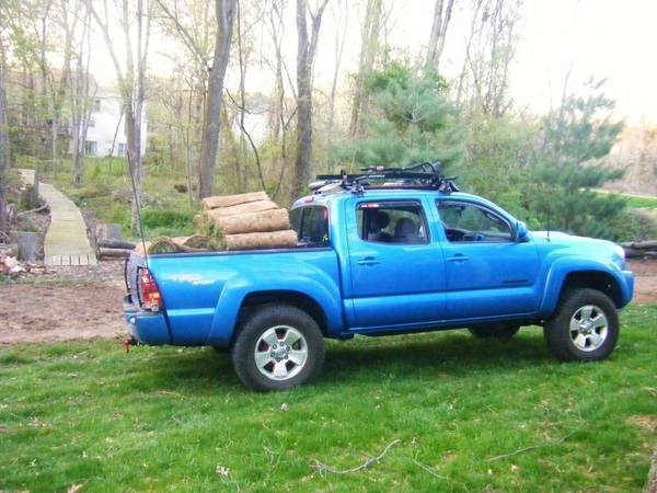

    oswego,
    thanks for the info! I've had my cb and antenna up and running for abotu a year. I'm running a 4 foot firestik, so the second would be the same thing. do you think it would be possible to get the split made with equal lengths of cable on both sides, so i could just connect it to the existing cable i have? if not, oh well, coax is relatively cheap. as for the quick disconnects, they unfortunately will not work for me. with my lift, tires and roof rack, i don't fit in parking garages anymore :(
    here's a picture of the current setup. i'm planning to clamp the second antenna in the same spot on tail light guard on the other side. wish i had a better picture of it
    oh, i know that verry well, just throwing it out there. you hear some funny shit driving down the interstate :D

    Actually thats a convenient spot. behind the cab is actually a horrible place to put an antenna. the best place is smack dab in the middle of the cab roof. The roof provides a good ground plane. On the back you have a ground right next to your antenna most of the way up. Really messes with your signal. The range and clarity of CB is mainly a function of the band and mode it operates on. AM/SSB are terrible for audio quality and 11m is actually a horrible band for local communications. with the right antenna and good band conditions you can talk around the world on it, but its just not good for local communications. This is why so many offroaders are going out and getting their ham licenses where they can use VHF/UHF and all the repeaters on them. much better bands for local communications.
