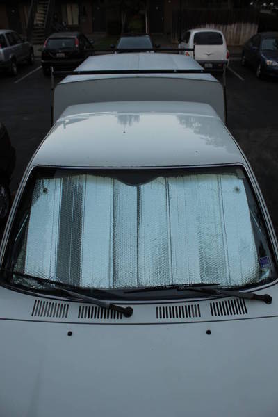

    Here's the gap between cab and shell...no 3rd brake light. I could secure the cable to the gap around the rear window and run it down following the tan wire in the picture, though, but I don't know what I would do if I wanted to take it down...
    Here's the top of the truck. The Relentless fab CB mount would not work here because there's a vented piece of metal between the end of the hood and the windshield, unlike in the 2nd gens where the plastic vents are below the surface of the hood.
