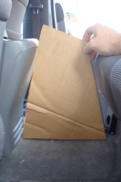

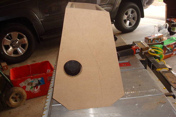

    Make a cardboard template.....strange angles in here...DCLB BTW....

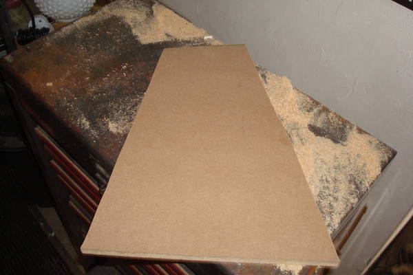

    Transfer the cardboard template to pressboard....

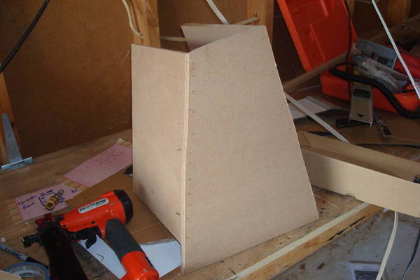

    Build the box...of course trying to shoot the nails straight helps...

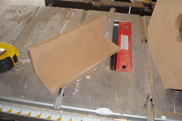

    Build and install shelf for CB...notice lip on back to set the depth of CB.

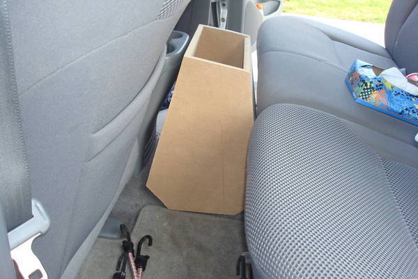

    Dry fit...note I cut off corners otherwise it won't go in......

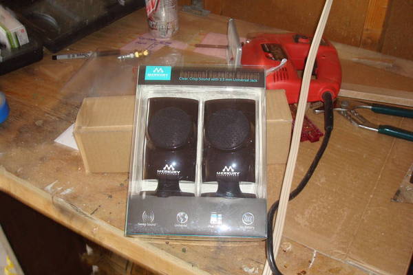

    $10 external speakers....from Wal Mart...cheaper than the CB Speakers....

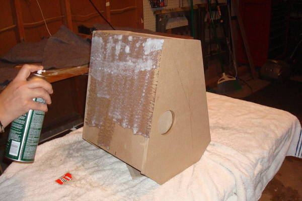

    Industrial spray adhesive...got the Mrs. to help on this step.....

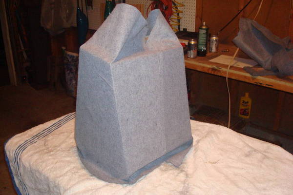

    Grey felt...about $15 for 2 yards...from Joann's Fabric...thanks again to the Mrs....

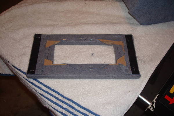

    Tuck and trim...a power stapler sure does help for this step.....

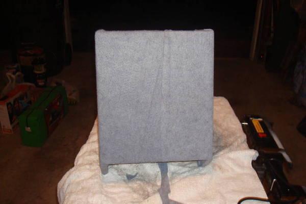

    Faceplate...again a little velcro here helps...

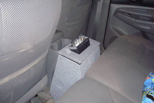

    Installed with no screws, brackets, or holes!
    Easy access for driver or passenger...CB or the entire box can be removed if needed.

    looks nice!!! do you ever lay your backseat down ?

    Rarely....The box is easy enough to slide out, just have to disconnect power cord and antenna from CB and the top access panel is velcroed on for easy access....The box is sized so I can still flip drivers side back seat to get to tool box etc....

    just curious as to what/where you tapped in for power for the cb since you put it in the backseat per se? or did you just run a very long length all the way to the front of the truck?

    I ran a black and red wire from a grounding bolt and fuse # 28 under driver's side dash, zip tied up under dash, ran along under center console, comes out under the back of the console butted and taped to the trimmed CB plug black and red wires. If I pull the box out I can tuck the wire under driver's seat or the rug in the back seat.
    The antenna is on the back window driver's side. Pulled the panel behind the seat and tucked the antenna cable behind the panel, coming out behind the seat, coiled and zip tied extra cable, ran cable under/between the split in the back seat to the box.
