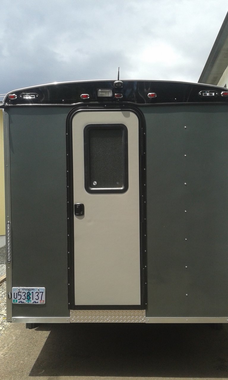

    Alrighty, this is a little different than truck mount CB setup. I am getting ready to put a CB setup on my trailer. Purpose is to be able to talk with neighbors (1-5 miles) and some of the local farm truck drivers as they drive by on the main road.
    I am looking for advice on radio and antenna.
    For the radio, I am thinking SSB. From what little I read, SSB has better long range?
    The antenna will be mounted at the back of the trailer on a flat wall (one layer aluminum, one layer steel) approx 3" below the top of the trailer. It will ONLY be attached when the trailer is parked, so length isnt an issue.
    I am thinking a ball mount with spring to make it stable on the wall if it gets windy and to give a good seal against water getting into the wall. Thinking to the left of the porch light above the marker light.
    Anyone have a suggestion for what would work well and not cost as much as a new sat phone?

    Is it a metal roof on the trailer?

    Yes, aluminum.

    Is that suggestion because it can be disassembled, or?
    I have a spot where I can fit a 102" or that full 12' antenna inside. Same location where my fishing pole and pole spear will be mounted.

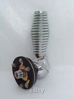

    This is the mount type I was thinking. It should put the bottom of the antenna right at the edge.

    the key is to get the antenna as high up on the trailer as possible. the metal will react with it a bit. Doesn't matter how it gets attached.. You could use a mount like that if you'd like.

    Yeah, I think the ball mount will get it the highest I can.
    You think the 2 piece would be better or a 102" whip. I know I will also get a firestick to put up there when I park in the woods (have a night/fire watch position that will give a little extra $ once I get the trailer done and just need enough for someone to drive next to the trailer and give info).

    Nice. Are you in the forestry business? A 102" whip will be fine. Any of those methods that have been around for awhile will do. Get your hands on an affordable swr meter. It'll help you tune that antenna and get the most out of it.

    Anything else I need to look into? I see a couple different ball mounts. One looks like you strip the wire end, the other looks like it threads right in.

    It looks like most use the ring terminal style attachment for the wiring at the mount.
    This is one that I found that appears to have a thread on attachment, but when I went to the link for it, it is unavailable. So, that clears that part up.

    4- I assume you mean antenna? I am thinking a Hustler SSM1 mount & spring with 102" and a shorter antenna (for short range needs with overhead trees). Mounting on back wall as it will give me the highest point and offers the only steel backing on the trailer that is accessible and wont block an awning.

    Is a ball mount less effective than the 90* steel mount? The extra cost for the ball mount is fine it it works just as well as it looks better and seems that it would provide better weather resistance and wear protection for the cable going through the wall than just a hole and a grommet.

    Yea it’s certainly cleaner
