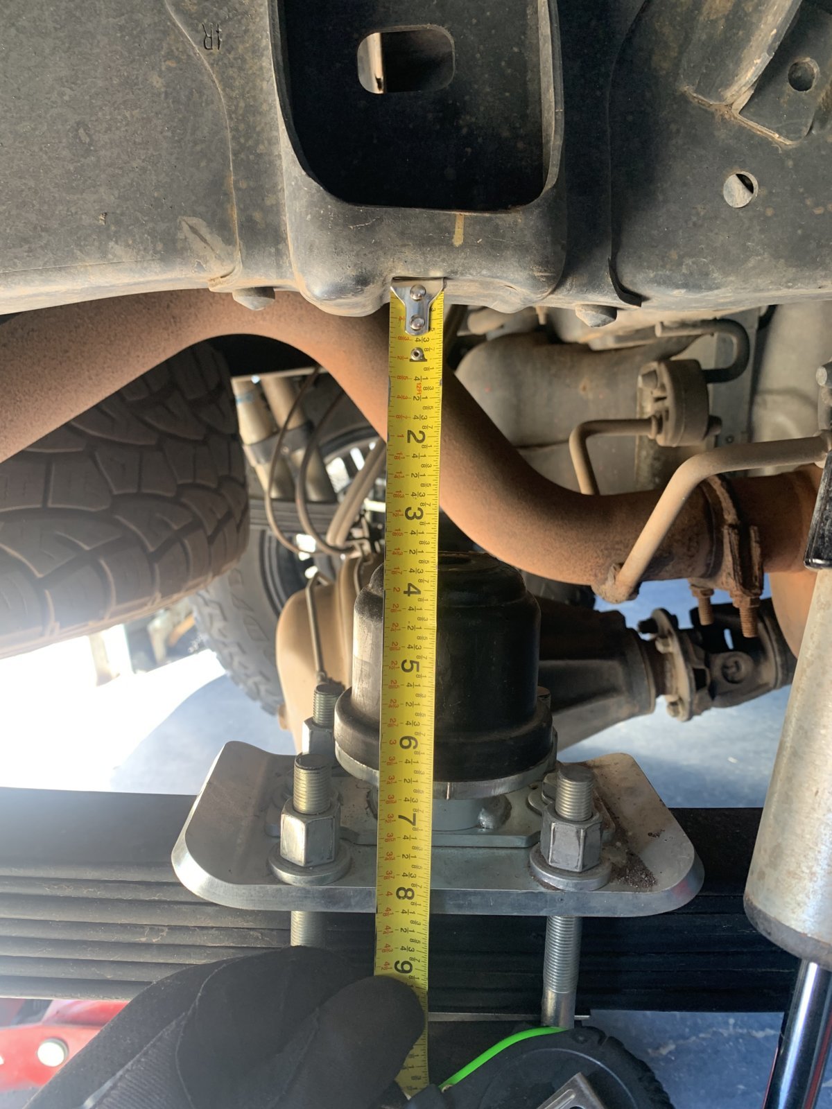

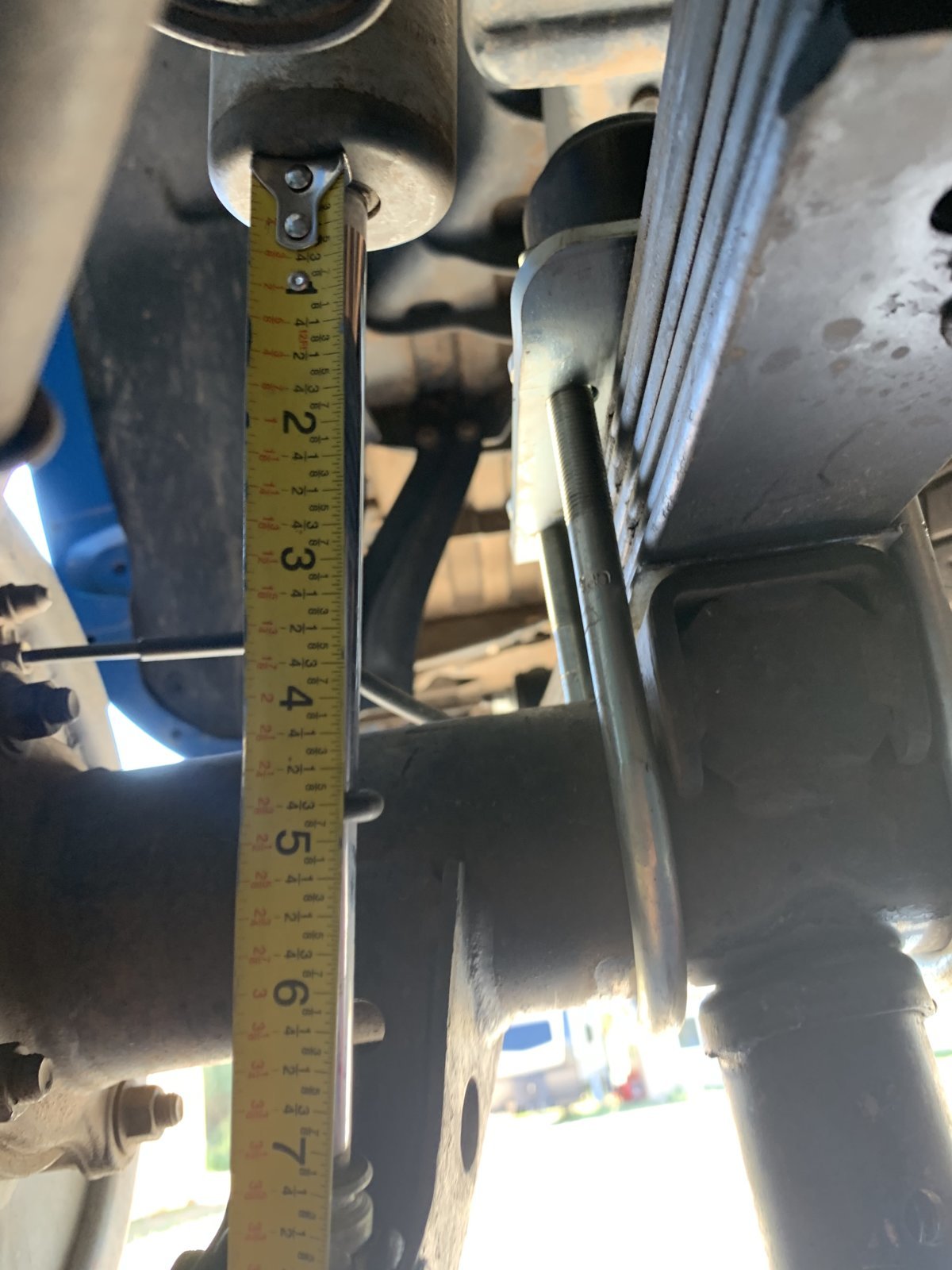

    Added the Superbump bump stop and flip kit also and while it provides more clearance and a smoother bottom out its definitely not allowing me to get full up travel. Only getting about 4.5” out of 7” possible. Seems like the maximum you could get would be 6” if you fully compressed the bump stop. In the pic you can see where the O-ring is riding. This was after a super rough off road drive with maybe 100lbs of gear in the back plus the camper shell. Would like to see at least 5.5” of available up travel so I’m not completely happy with these. C2388861-8B13-41FA-B173-56D223088C47.jpg 90B52B92-7548-4C60-A963-A4925B72294D.jpg
