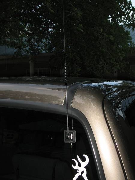

    Cat-back exhaust, BluLogic, Back-up Camera, Extang Solid Fold Tonnau cover, Pop-n-Lock PL8521 electronic tailgate lock, Illuminated 4x4 switch, Smittybuilt Nerf Step Bars, Toyota bed mat, Tinted the windows darker, CB with custom fab'd antenna mount, Grillcraft grill, AFE Pro Dry S filter with secondary filter removed. Differential breather relocation mod. Bridgestone Dueler AT/Revo 2 tires Weathertech mats Spec-D HID Halo's Bilstein 5100s front set at 2.5" w/OEM springs 4-leaf TSB w/ SkyJacker add-a-leaf
    I have an Extang Solid Fold tonnau cover and didnt want to have to a.) drill more holes than I needed to in my truck, b.) cut my tonnau cover so I fabricated my own bed-rail bolt-on mount using 1/8th" steel....Worked well....I can document in more detail (pics-n-such) later if you're interested....Here's the one pic I have now:
