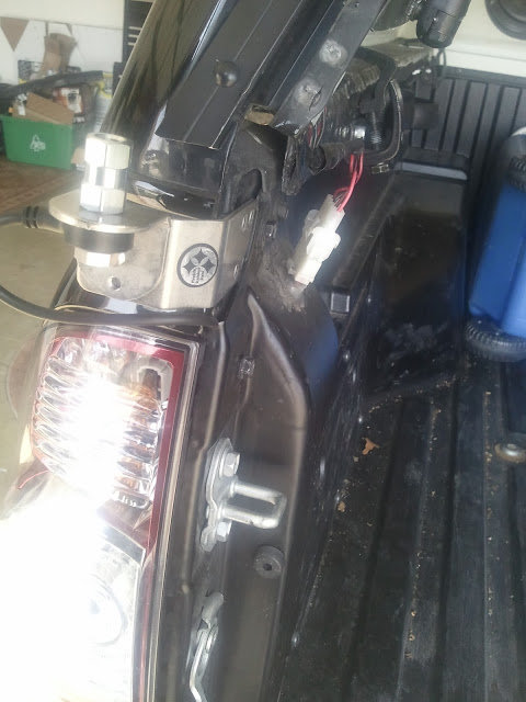

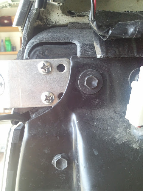

    I mounted mine here with a regular firestick due to my fiberglass cap. Am I in need of a NGP antenna. My swr is good, but I always get a lot of noise from other radios. I think my transmision is good (not really tested).

  13. Jun 18, 2012 at 2:34 PM
    95 taco
    95 taco [OP] Battle Born
    May 3, 2012
    #78175
    17,535
    2003 4x4 TRD SR5 auto
    OME 883 front, OMD 3.5" rear, Relentless front bumper, smittybilt 9.5K winch
    no problem, awesome mount location, if i was gonna keep my shell i might have done something like that.
  14. Jun 18, 2012 at 2:37 PM
    Forster46
    Forster46 Very nice how much?
    Jul 20, 2010
    #40487
    3,362
    Nick
    Mount Vernon, WA
    The doritos locos taco
    6000k HID's, AUX Reverse Lights, 3" Rough Country Suspension Lift, Pioneer AVH-P4200 Double Din, Underglow and footwell Lights, Camo Seat Covers, Duralast Tool Box, Blacked Out Badges, Grill, Front Emblem, Midland CB Radio, Amber Strobes, POWER REAR WINDOW, cup holder LED's, Firestik 3' in bed, console divider, Ultragauge.
    Where did you get the mounting bracket?
