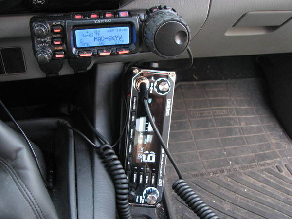

    Specalt did that on here. It does fit if you have a smaller model CB.

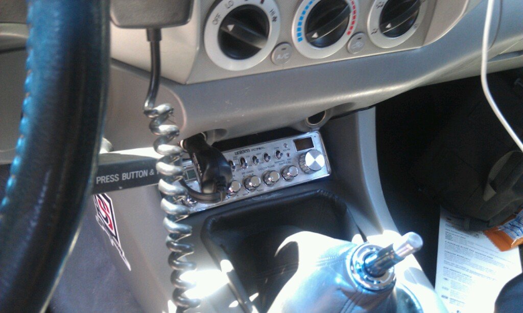

    Yes
    I put mine here....
    Super easy install and easy to reach.

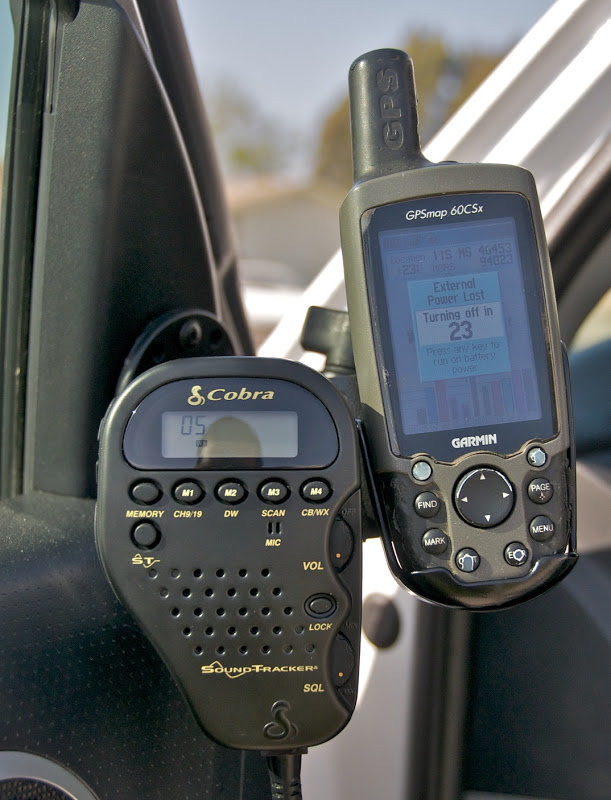

    Just get a cobra 75 wxstv and mount it anywhere!

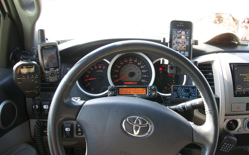

    :eek: you going for the plane cockpit look?
    That truck would be broken into and stripped in my city in a NY second. I keep my electronics hidden for that reason. Of course most don't live in a crime ridden shit hole like me.
    My cb is in my center consul. When not in use no one has a clue. I also stuffed my SWR and aux speaker in there.
    OP just put it where it's best for you and think it out. I sat my ass in my seat and stared at my truck for 20 minutes before deciding. The main object is usability followed by a professional looking installation. I see way to many hack jobs when installing CB's. Please keep them away fro your legs or your passengers legs if you value their safety in an accident.

    OMG, havent seen that many electronics facing a driver since I was in a Japanese taxi.
    And to think you can't "text message" cuz that would be a "distraction" but all of that's legal.

    This is the CB I have as well because it can be easily hooked up and put anywhere and easily removable and can be put away. I keep mine in the center console when not in use.

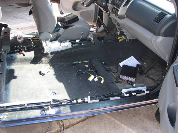

    Just Installed mine last weekend. Uniden 520xl with a 20w external speaker under the seat facing up. Fits perfectoy and is nice and hidden.

    Did you drill through the bottom to get the antenna cable to go out somewhere? Also, you'll need to run an external speaker or that thing will be muffled as all hell if you close the armrest.

    Yeah I drilled out the bottom and ran It under the carpet and through the rubber grommet under the drivers seat. And I do have an external speaker. It's under the seat facing up
