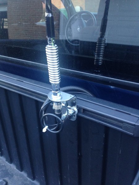

    any one install a cb and have the swr reading under 3 ? Mine are in the 3 range.
    Firestik antenna bolted to bed rail passenger side. Ground wire from bracket to frame. Hooked up to battery.

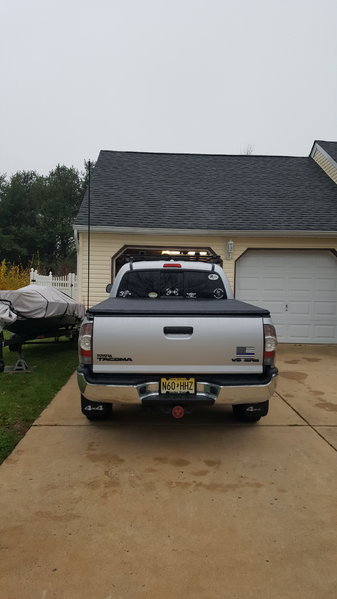

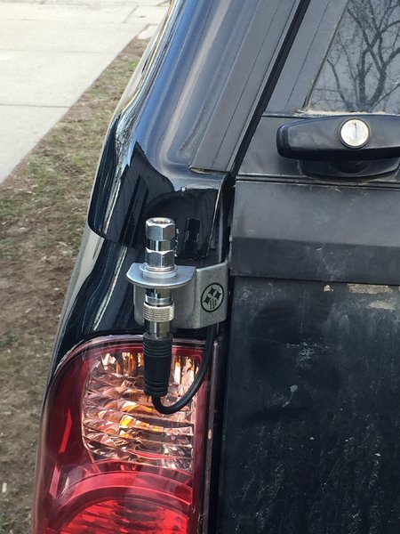

    Got mine down to about 1.8. Mine is mounted on the drivers side by the taillight using the existing 2 10mm bolts up top. I made my own bracket out of 1/8 steel plate. Has a good ground without having to add a ground wire to the bracket. Also i have a 4 foot firefly by firestik.

    Bed rail CB antenna tuning can be a pain. If you want a more no fuss install, there are a few vendors that make antenna mounts that go near the tailgate on the 2 little hex bolts on that inside metal portion near the tail light.
    That said I have a military CB antenna setup on my passenger bed rail and my swr is somewhere like 1.4 on channel 40 and 1.2 on channel 1. Best I could get after properly tuning everything.
    Do you have the adjustable firestik with the little twisty bolt under the red tip? Have you adjusted that?

    Mine is basically the same setup as 10tacosr5. My swr is 1.6 on 1 and 40, and about 1.1 on channel 19. There is a good chance your ground is too long. Try switching to a braided ground strap and not a stranded wire. IMG_1292.jpgAlso you want an 18ft coax. And make a loose figure 8 with the extra. If you move your mount to the tailgate you'll use 95% of the 18ft coax.
