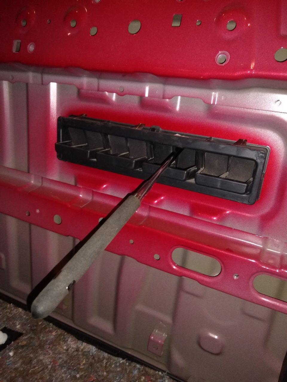

    Here's the cab vents...this should work ok.

    Are those behind the rear seats, so you have to take out the seats to get to them?

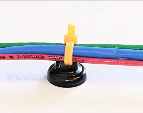

    My access cab has no actual seats..just storage for Jack, etc. I just pulled off (unsnapped) the back panel to expose it. I think I'll use these Mag Daddy magnets to secure the coax down from the magnet antenna base near where it'll feed in these vents.
