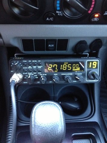

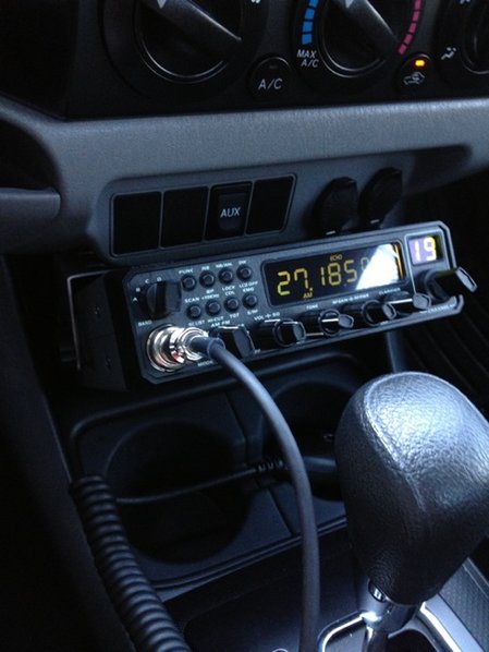

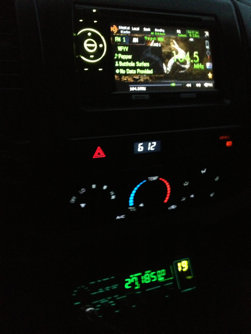

    Pull the bin out, do not drill through the back of the bin while it is in the truck. There are components directly behind the bin. I pulled the bin used a Dremel, smoothed edges and installed a rubber grommet for the coax and power to pass through. Worked well for me.

    Ooops, I can be such a rookie sometimes. Here we go.

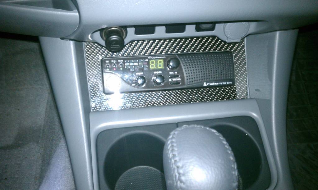

    That is the computer for the airbag system. And that's where I put my cb. I love it there.

    IGLOW4LO, that looks great. Where is the rest of the cb though? Is that just the face in the second pic?

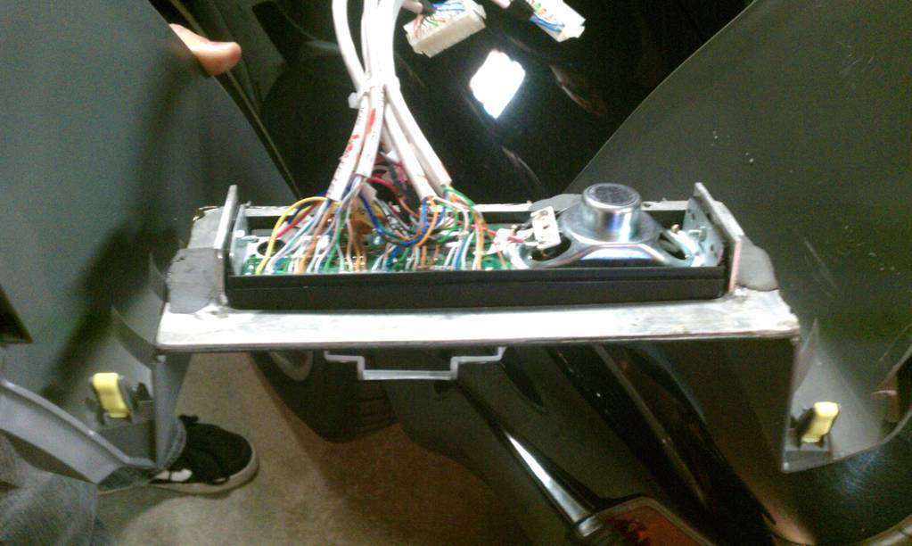

    Ive seen that thing! He stashed the radio under the seat if I remember correctly. Lots and Lots of soldering :eek:
    Looks so clean though flush mounted!

    Cobra 29 in the location you want
    with radio under the seat
