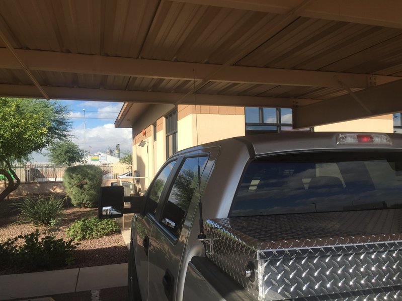

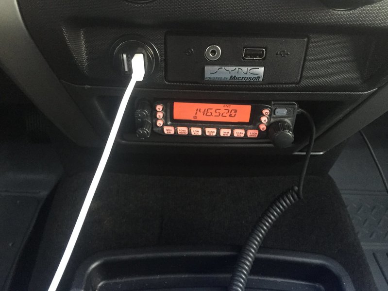

    A neat feature to most ham radios is remote mountable faceplates. I've got a Yaesu FT-7800 with the remote feature. So the faceplate is mounted in a lower dash pocket in the truck with the bulk of the radio under the passenger seat. Then currently running a NMO mirror mount with dual band antenna off the toolbox.
