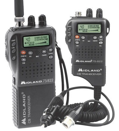

    Ordered the Midland handheld and a 2' Firestik. Antenna should come in Thursday. Will post pics when done.
    ETA: Bought it to get ready for my first trail run next month. Still have to find an SWR meter or a local shop. Both are hard to find apparently lol
