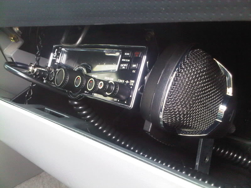

    I got the Cobra 29 LX. looks great, it's downside is no side band and the unit is rather large so your mounting options are limited.
    http://www.amazon.com/gp/product/B004RO3RBE/ref=oh_o03_s00_i00_details
    Mines is mounted in the glove box.
    Using a 4ft fiberglass antenna right now, gonna order a tune-able Firestik soon.

    i did the center console for the same reason but i cant jam as much stuff as i used to in it now lol.
    glove box would be annoying IMO just because you have to reach over when you need it. center console i just open and grab.

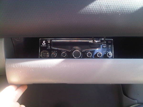

    I redid the glove box so it only opens enough to access the CB radio. The Mic Cord is long enough when I do need it I can just lay it in the cup holders.

    Wow thats a super clean install, just like it came from the factory

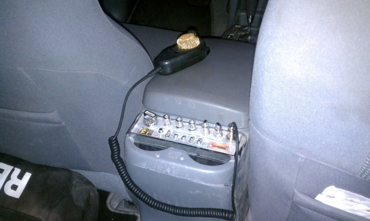

    here's how i have mine mounted..kinda

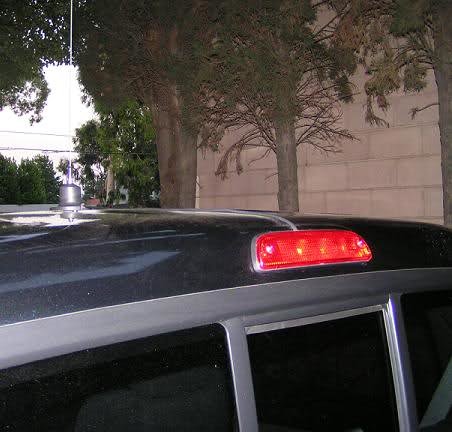

    and how i have the coax routed to from my Wilson "Little Will" mag mount antenna
