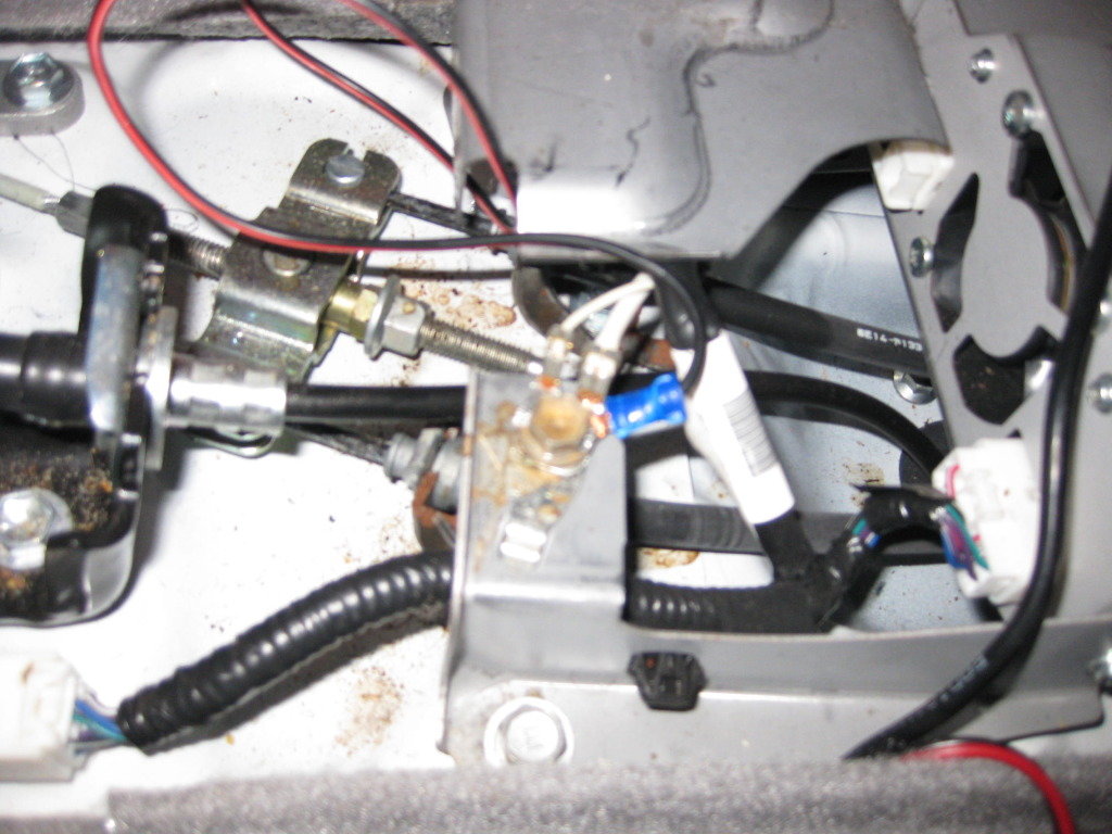

    here is a pic of how it is wired
    red wire: power
    black w/ blue connector : ground

    That looks fine, but I'd probably use the bolt on the side of that bracket instead of one already used by whatever.
    Anyway, if your electrical connections are okay, check the antenna ground and ground plane. One quick way to do so is to disconnect the coax at the back of the radio to see if the noise reduces substantially. If so, make sure the antenna is mounted well to metal (the beds on many Tacoma trucks are fiberglass) and the metal surface area is large enough to provide a sufficient ground plane. If either of these are lacking, the antenna will pick up noise from the truck and nearly everywhere else.
