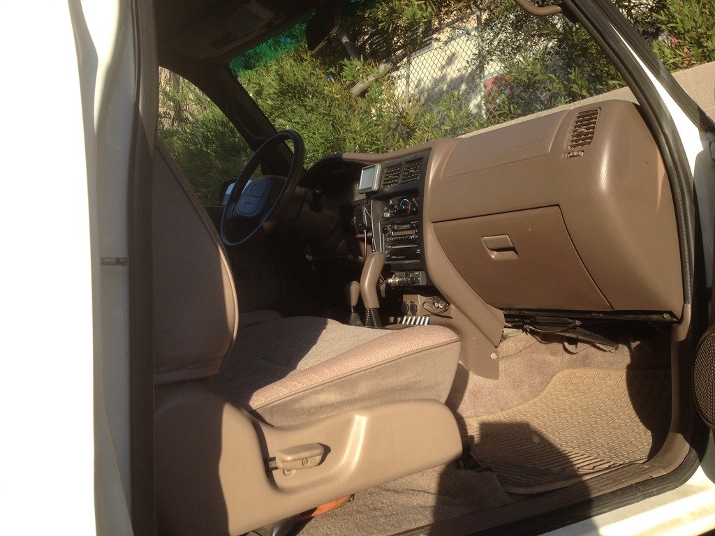

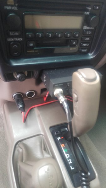

    And you don't have to tear the dash all apart...
    Pull the ashtray
    Unscrew the ashtray mount, set then aside in case you want them back later
    Route the coax cable and attach it to the back of the CB
    Hook up the power and ground wires
    Push the CB into where the ashtray came out - This is where the right-angle connector and reshaping the air duct helps to further recess the CB
    Adjust the wires/cable
    Tweak the antenna - SWR meter
    Drink your favorite beer
    I'm simply using some velcro to hold the CB into the ashtray slot. Hasn't budged in years... I use the Little Wil and it really didn't even need SWR tweaking.

    I doubt it's held in place by anything permanent, mine is just held in by friction. The reason it juts out like that so much is because the original owner didn't cut out the ashtray bracket. Once you do that it'll go in way more. Just pull on it and see if it comes out. I tried permanently affixing it but I never found a good way to do it.

    And removing the radio dash panel is a lot lot simpler than you may think. It's just pulling off the climate controls and a few screws. I can do it in under a minute. Just follow those instructions I attached in an earlier post.

    you are ABSOLUTELY RIGHT!!!! i feel so stupid!:annoyed: All i had to do was pull on the cb radio and it came right out! it isn't even attached to anything its just held in by friction! when i pulled it out there was already a black wire atatched to the coax antenna area on the back f the CB radio. Does this mean i already have an antenna installed somewhere?

    If you had an antenna already installed it's damn near impossible to miss it. It'll be a big ass giant antenna sticking out like a sore thumb.
    I'm guessing it was just removed. Some common mounting locations include the engine bay, rear bumper, and where the bed meets the cab. I'd look in the engine bay first for any spooled up wire.

    Damn! you were right again. i followed the cb coax cable and the previous owner ran the cable through the firewall into the engine bay and at the end of the wire it looks like someone snipped it off and took the antenna with them. i ordered a cobra CB Antenna with a magnetic base mount i will upload some pics when i get it in the mail :thumbsup:.
