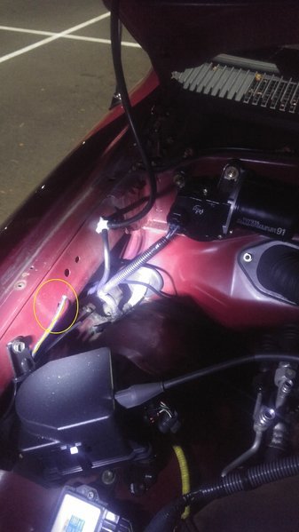

    [​IMG]this is the snipped wire. ill just leave it in for now until my antenna comes in the mail. i will update more pics when i get it.

    79
    The snipped wire circled in yelllow.
