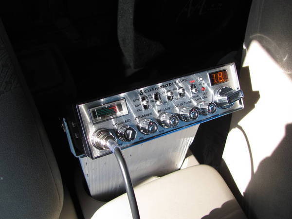

    So I recently installed a Cobra 29LTD Classic with a Fire stix tunable tip antenna. No matter which way I tune (up or down) I seem to be running hot. I can turn my SWR down on the ratio but then my range it cut considerably. Does the Antenna have to be grounder to my truck? What can I do other than the usual tuning to figure out whether or not my antenna is to long or to short?
