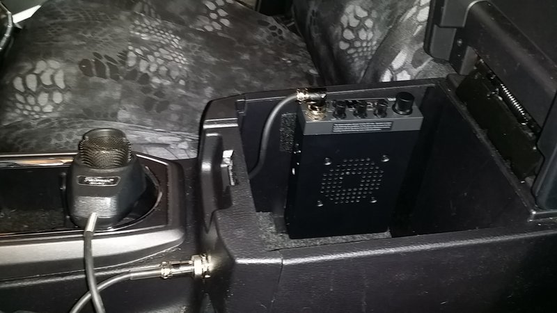

    20170217_130531.jpg works great and it's completely out of the way.

    Who makes your MIC??? :confused::thumbsup:

    Its a Palomar 41

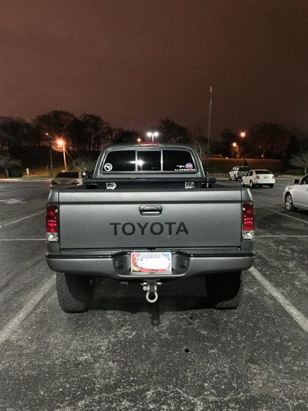

    Has anyone used a 2 foot long firestik? Is the range "acceptable"? Like for trail use and occasional trucker BS during traffic jams. I just moved into a place with a garage and the 3 footer is too long.

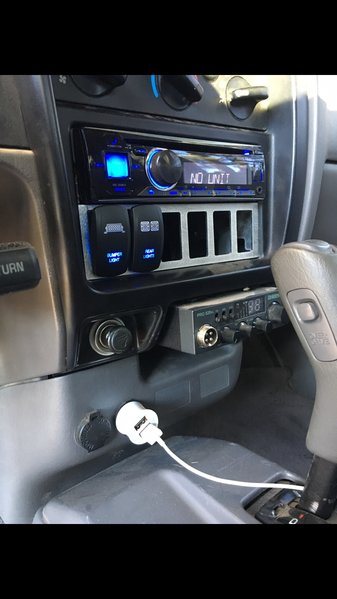

    IMG_6498.jpg More switches now but you get the idea :D

    Same place as the 3 footer, corner of toolbox on an extra long 'mirror mount' and heavy duty spring

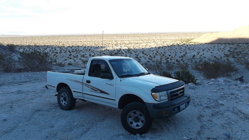

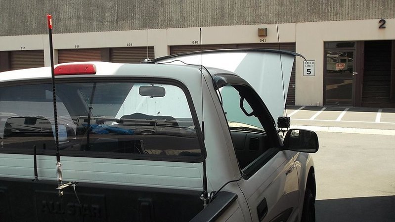

    You SHOULD be fine in that spot. BUT, as your antenna gets smaller and smaller and closer to a "structure", your SWR starts going to crap!!! I'm barely below a 3, which is really NOT considered "GOOD", but I am SOME WHAT within reason still. I have the 2ft for "around town" and what not and then when I'm out on a trail, I'll take the 2ft off and use my 4ft Francis CB whip.
    The pic shows where my CB antenna is located and you can see why my SWR is pretty bad because most of the antenna is "near a structure". You ideally want ALL or at least just over half of your CB antenna "above a structure". If/when I put up my 4ft, the SWR is around 1.5-1.7, which is pretty decent. I would like it to be 1.5 and below, but I'm pretty content with around 1.6 for sure.
    Here, you can clearly see how much more of the antenna is ABOVE the cab!!! :thumbsup: I just recently bought a 4ft tunable in hoping that I CAN get my SWR lower, which will help with TX efficiency. The Francis antenna is really NOT tunable, but I like it because it is fairly light weight!!! :thumbsup:

    your not going to have a very good swr reading. Don’t expect great distances because your cab is "blocking it”. Not a very good projection plane for the radio waves...
    Ever thought about getting a foldable mount in that same position? then just fold it down when your going into your car port?

    Yeah I know that will inevitably be an issue, however it's a matter of having long range or fitting in the garage.
    Hmm I didn't know such a thing existed
