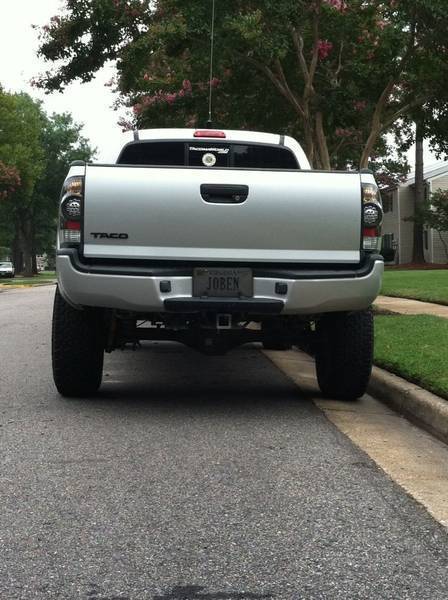

    I have a 60" whip mounted to my roof. Zero issues.

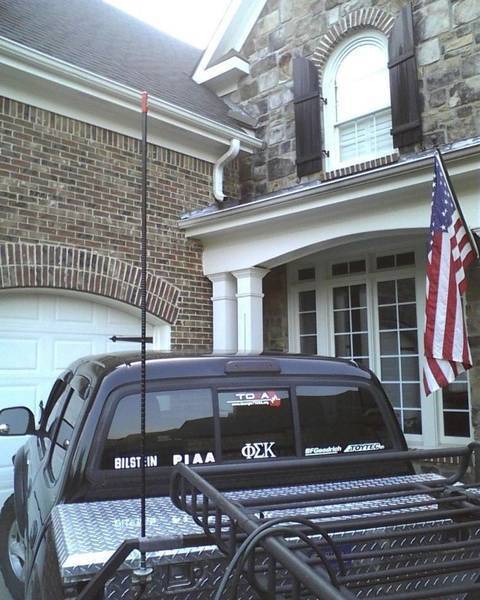

    the best pic i could find so far...hard to see
    this is what you are looking at.

    6"?
