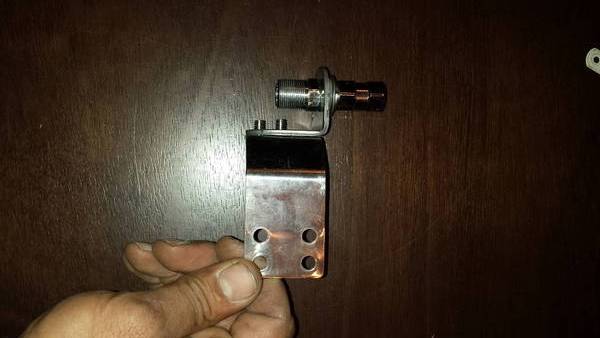

    Toytek 3" ultimate lift Billstein 1500 coilovers, and Light Racing UCA's with AAL in the rear, Mickey Thompson classic lock III rims with color matched powder coated color rings,with 285/75R16 General Grabber AT2 tires led tail lights , T-Rex Billet grill, HID reverse lights, FLYZEYE V2W led lights, throttle body spacer, and K&N air filter, Kenwood head unit, Rockford Fosgate punch 6 1/2" speakers, 6x9 Rockford Fosgate punch speakers,1 inch Rockford Fosgate prime tweeters, 5%tint all around, CBI rock sliders, Cobra 19 CB with 3' firestik antenna, 6 1/2" lightforce 170's behind grill, redline elite hood struts, retro fit HID projector head light with halos and demon eyes, weather tech floor liners, led interior lights, truxzedo low profile bed cover, rear diff relocation mod, anytime fog light mod.
    it goes stud to ground / mount then plastic washer then flat washer lock washer antenna
  14. Mar 10, 2014 at 6:28 PM
    addicted7369
    addicted7369 She Thinks My Tacoma is Sexy
    Nov 1, 2011
    #66263
    1,586
    Al
    Middlesex County, N.J.
    06 Tacoma Sport DCSB 4X4
    it should look like this.

    thanks for posting this! I'm currently having a different issue with my 19 that i'm hoping will be fixed when the SWR meter gets here and I can tune it....
    and in terms of grounding.. what kind of whip are you running? I ask because firestik gives diagrams on their site for how to ground specific mounting methods as well as types of coax
    EDIT: also, if you end up finding that you're haven a problem with the mount, buy a piece of steel flat bar from home depot or lowes and make one. That's what I did and know i've got a great ground, strong mounting point, and it only cost me about $8... just a thought
