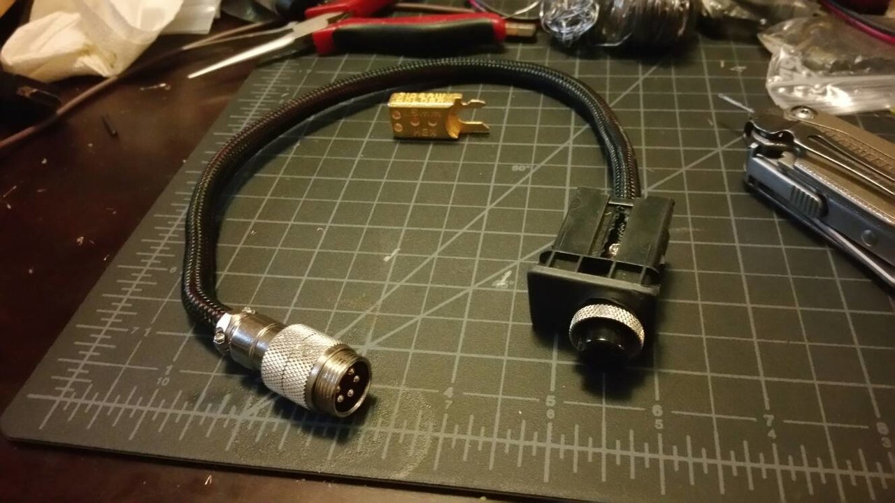

    Check this out. Cobra -75 Modded switch blank. Makes for SUPER clean install.

    OMG that's the shit right there!

    Basically it is just a jumper with the switch blank in there. After making this one, the next ones I make for sale will be 18" instead of the 14" this one was.:D

    I checked mine and there is a residual ground but it is not sufficient enough to ground led lights. I had to ground to the frame.
