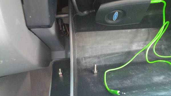

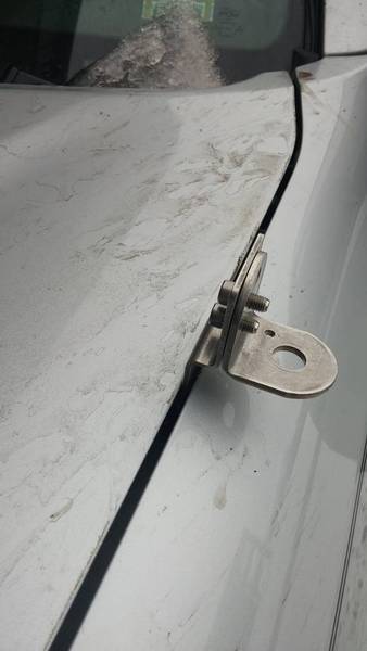

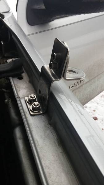

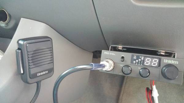

    Today I was able to get the hood channel mount installed and the radio mounted under my glove box. I'm uploading the pictures now. Still have to wire everything in. Not sure how I really want to do that yet. Sun went down and it went from a nice 40 degrees to a cold and windy 30. Hopefully finish it up tomorrow.

    Still got to weather seal this...
    Through the glove box

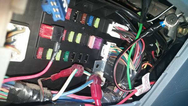

    I've been looking around and am considering picking up a fuse tap to power the CB. Would be nice if it would turn off when I take out the key, one less thing to have to remember.

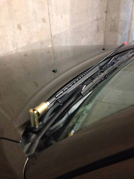

    I run a Cobra 75 wx handheld with a Relentless hood hinge mount on driver side. Was running a 3ft firestik which clears the roofline by almost a foot, reception not too shabby. Just got a 4ft firestik to run with my brand new Breedlove foldover mount and a matching relentless passenger hood mount. Going to rig up a away to fold my antenna across the hood and secure it down to that passenger mount.
    Something like this, though I have to make sure I clear the windshield wipers range of motion:
    I ran my coax straight through the firewall boot where all the other wires run (poked it a hole to run through). Ran fused power through firewall also. Wires are run inside straight behind theE-brake pedal and under into the carpet, I unvelcroed and revelcroed the carpetso the wires are all tucked in. I understand people have issues with runningpower wires right next to coax but I haven't really had any issues, but I'm notlooking for a suped up setup either.
    Mine is more for fun and trail useonly, and NOAA which I have had to use on more than one occasion driving awayfrom some bad storms.

    Wired direct to the battery is always your best bet.

    It was finished Wednesday but I was too busy running around doing 6 other things to come on here and post the pictures. I edited my first post to include the total of all the extra things I needed for the installation, still under $150.
    I will say this doesn't include the cost of the things I had on hand already (tools, electrical tape, etc.) but those items are generally good to have and can be used on many other projects. Some people might already have extra fuses, ring terminals, wires, silicone, but I didn't so I included them as parts for this project's cost.
    I did wind up going the fuse tap route, only because I didn't want to put leads directly onto my battery and I didn't want to splice into any preexisting wires. Just seemed like the only other clean option at that point. I don't get a lot of engine noise/heater fan/radio interference, probably helped that I used a fuse slot that was already empty and isn't wired into anything else. It's an ACC On slot too which is nice.

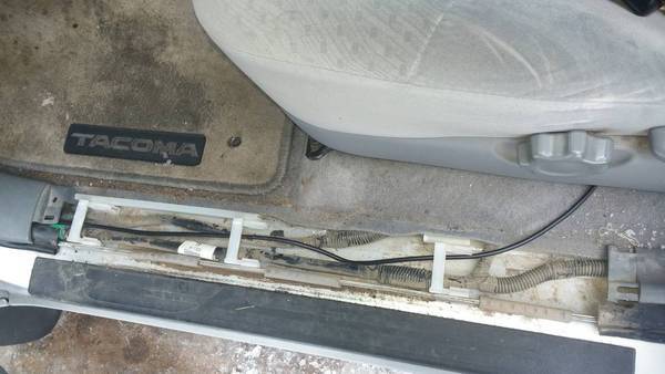

    I ran the coax through the wire bundle behind the E brake, down the left side panel and under the step plate. My Tacoma already had wires running through there inside of handy little brackets so I popped them open and slid the coax through too.
    I ran it up, under the drivers seat and rear floor mat, around the back of the center console, and then just did the reverse process on the passenger side. Out the passenger seat, into the floor step plate (not sure what it's really called) and up the right side, hung from under the passenger dash, down behind the glove box into the CB radio. And that was the full 18' which was real lucky. Wouldn't have minded being a little long, short would have been interesting. But it was just fine.

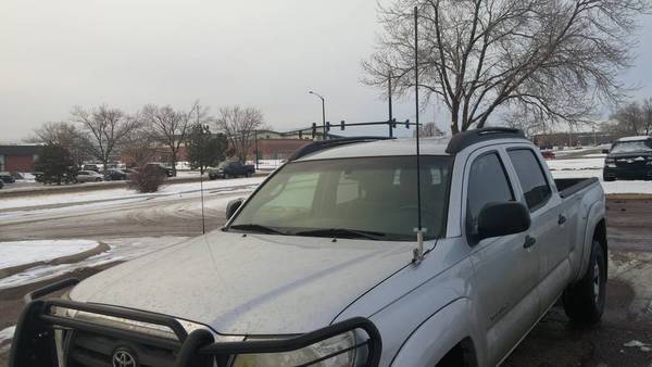

    Here's the Tacoma with the new FireStik 3' which definitely clears the roof.
    I tuned it in a wide open parking lot, managed to get Channel 1 and 40 both around a reading of 1.7 and Channel 20 is right at 1, the needle doesn't even jump.
    EDIT: Forgot to mention, I used the sealant around the whole antenna mount to prevent any kind of water leaking in and sitting under it or rust forming where I drilled through the inside of the quarter pannel
