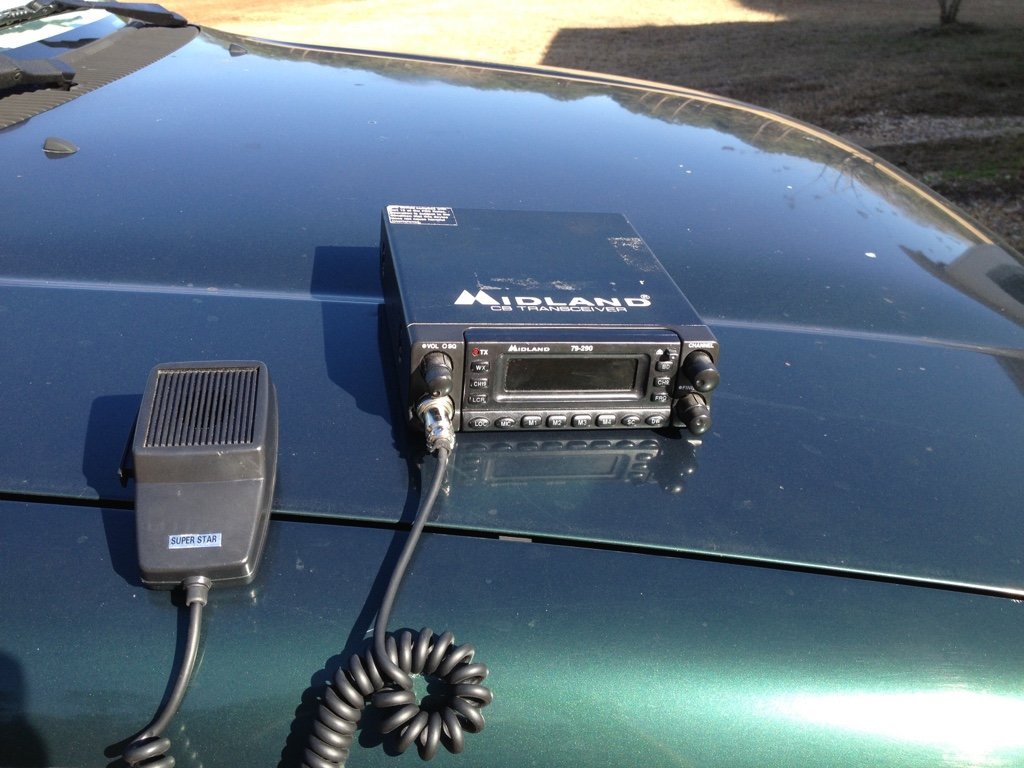

    Yes. But FCC says illegal. One reason I never installed mine. It'll cover 10m and the 11m CB bands. It's boxed up and is my SHTF radio. But to buy one that'll do both, no. It'll need to be 'opened' up to cover more bands.
