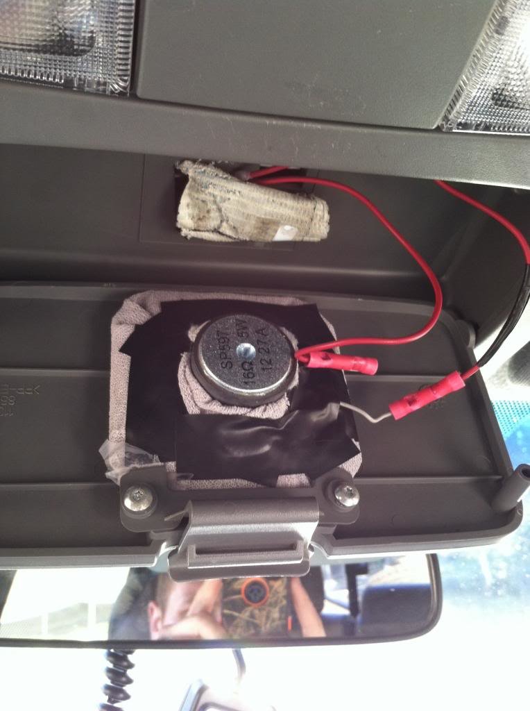

    Hey guys so i installed my CB Radio into my dash kit to keep it clean check it out and if u got any ideas let me know!...
    And my small antenna soon to be upgraded...
    And then i took apart my radio before hand and took the speaker out of the radio and then rewired it all the way up into my garage door opener compartment and I totally recommend this cause it is way louder and learer right over head!...
    CBRadioSpeaker2_zps38e9a2a9_79963a56ee9cca00bf619ab0c90ae1b252896714.jpgCBRadioSpeaker_zpsd74f46eb_ab0bc7288cce6f0b80f8ea15e1d691c5f885ac7a.jpg

    Did you have to tear your whole dash apart to run the wires? If so where/how did you start the tear down?

    Thanks guys and no i just had to take the dash kit for the stereo out an i just fed the wires down to the left in the back... you can push wires eaiser from the driver footbox up behind the center consol and i just fed it tell if poped up behing the head unit!:D:D
