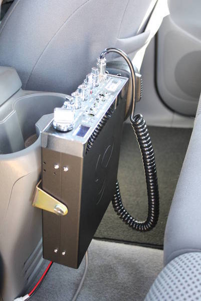

    The mount I made is a stolen idea from evilmonkey. Its a little more refined. I used 16ga steel I had lying around the shop. Cut a few shapes, threw a few bends on it, welded a couple spots, and painted it up.
    Here's the radio mounted in the cab. I looked everywhere for a spot to mount this, but this radio is huge. Anywhere else would have been banging me or the wife in the knees. So this is where it ended up. It will really only be used when driving cross country (every few months) so the position works just fine. A quick glance and you can see all the controls.

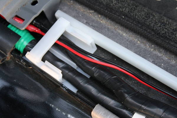

    I ran the power along the drivers side directly to the battery.

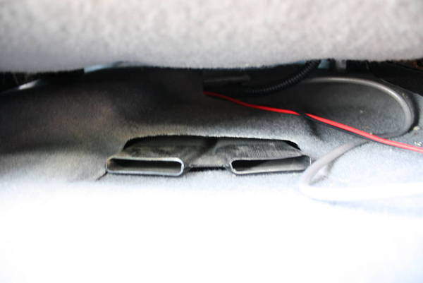

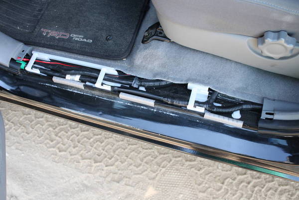

    There is already a spot under the drivers seat, near the rear air, that the carpet is sliced. I ran the power cables and coax through here. The coax was run under the truck, and through a a grommet in the floor pan along with a large cluster of wires. Its almost directly below the drivers seat.

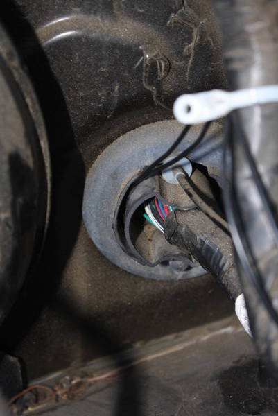

    Pulled the two power lines through this grommet in the firewall on the drivers side. Connected them to power and ground on the battery.

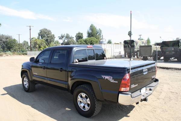

    A few pics of the truck with the antenna. About half the antenna is above the roof, so the reception is pretty good.
    Once everything is installed, I used an SWR meter to fine tune everything. This Firestik antenna has a quick tune feature on it which was really handy. After one adjustment I was getting readings of 1.5 across all channels. Reception is good for about 2 -3 miles with this setup.

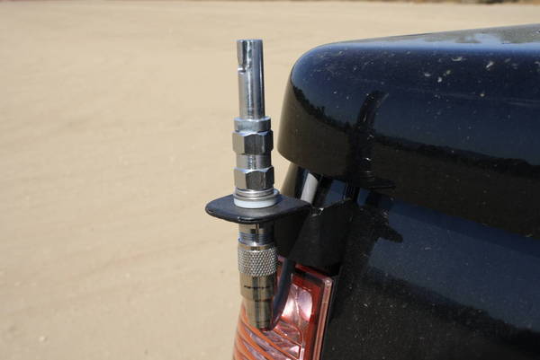

    That's the best idea ive seen to mount the antenna.

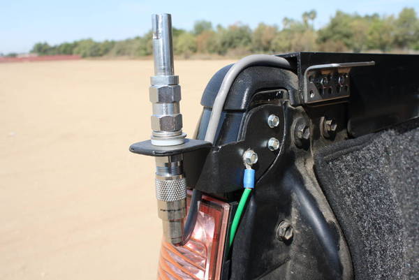

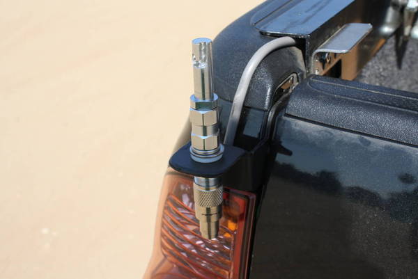

    :headbang: i love that antenna mount. any problems when closin the tailgate like havin to be extra careful? or was it already pre-existin screws? loving that cb too.

    No, no problems. I just used some #8 tek screws. There is plenty of room. The tailgate actually has a little recessed area there. I originally wanted to run the coax through the tailgate area, but there wasn't enough room. Just slam the gate without ever worrying about it.
