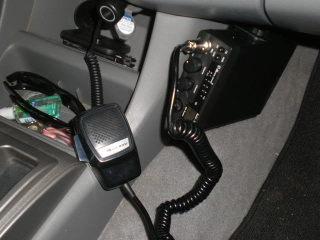

    I like the spot you chose but for me i would definately knee the hell out of that. i would have to go check how its wired just to make sure. Heres my location i chose.

    amazingly enough my knee doesn't touch it. However, when my foot is taking the parking brake off, I did make contact with the back of it. Now, that I've been in and out of the truck the whole day, I'm already used to it. It should work out great there.

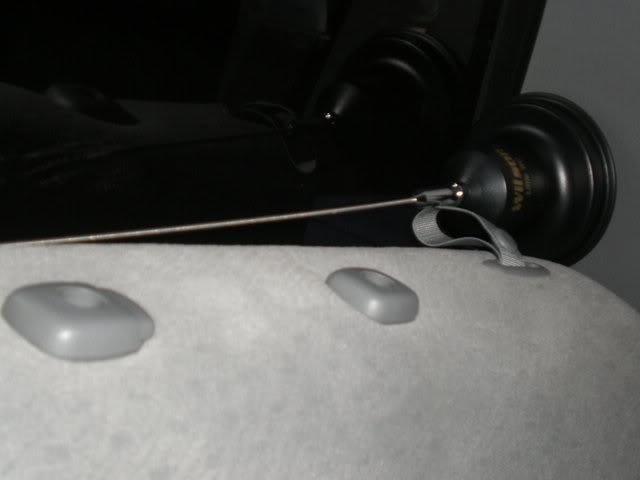

    Heres where i have it resting along the back bench will find a way so that i doesnt get beat up when hitting bumps on the road, but i just take it and mount it right out side through the sliding door put it on top in the middle of the cab.

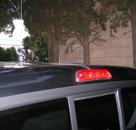

    mounted in the rear passenger center cup holder
    ran the cable under the brake light assembly rather than going through the sliding glass

    yes sir, it's mounted 24/7...
    i never have any problems with it. i've had this one for almost 8 years now and was on my previous vehicle. the magnetic base is strong and has never blown off from high speeds, high winds or branches on the trail. and since its a magnetic mount i can easily dismount it and just let it rest sideways on the roof when going into a low ceiling parking structure or whatnot.[/quote]
