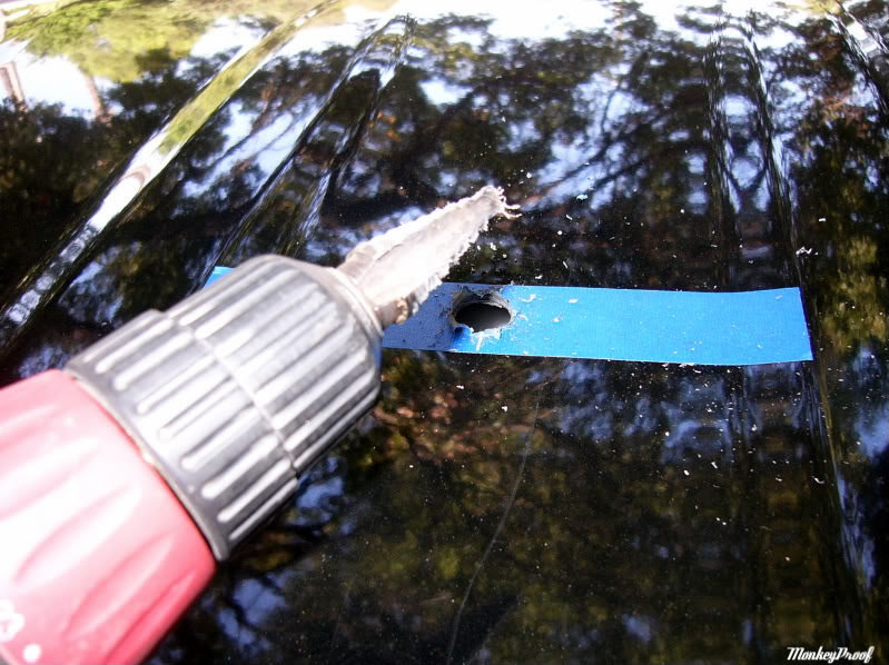

    OMG! That's not clean at all. How is the mount flush to the roof? I admit the finished product looks sweet. I originally wanted to go that way but I didn't want a hole in the roof.

    He is using a NMO mount. The best way to go. The problem is he is using to wrong tool for the job there. As for CB antennas, I'm not sure what is available in a NMO mount. The great thing about a NMO is there are all sorts of options when you remove it. They make these little stubby antennas you can put on that look like the Sat antennas found on most newer vehicles.
    I'll get some pix of my install later.
    This is what you should use for a NMO mount.
    http://www.wpsantennas.com/hs34-antenex34x-actholesaw.aspx
