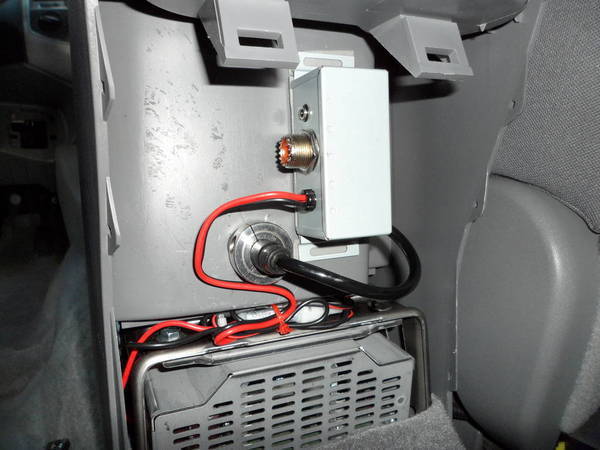

    <- in my 2006. And I mounted mine in the center console under the lid . Mounted perfect and is out of sight. Ran my cable from the bed under the cab, through a drail grommet, under carpet and right up into the center console. Ill take pictures when I get home :)

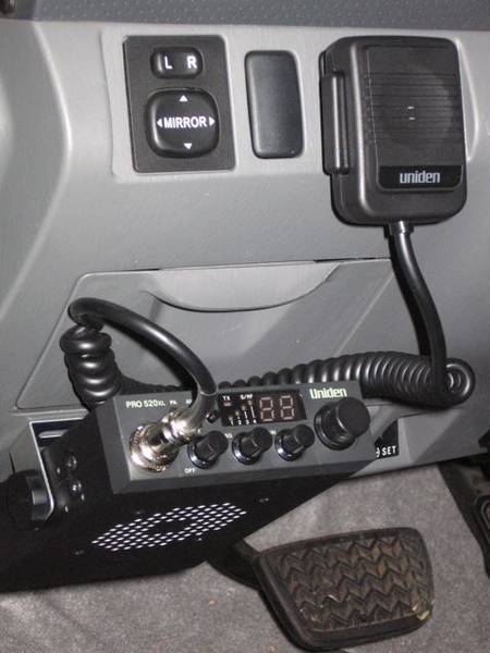

    barlowrs
    barlowrs Well-Known Member
    Feb 12, 2010
    #31230
    594
    Robert
    So Cal
    06 Toyota Tacoma Sport 4x4
    Build Thread: http://www.tacomaworld.com/forum/builds/74926-barlowrs-06-taco-expo-build-thread.html OME Lift, FJ SE Wheels, 255/85 KM2, Allpro Plate Bumper, 8K Winch, Synthetic Line, Yaesu FT-8800R, Custom Sliders Sockmonkey bedside decals, BHLM, base model grille, TRD offroad (black) trim

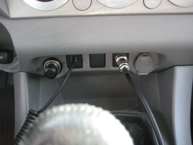

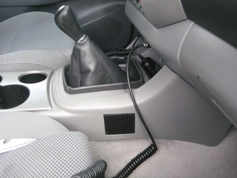

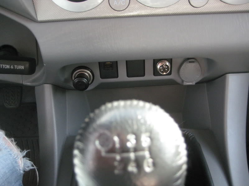

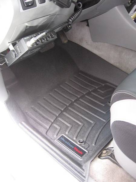

    What up...just saw your thread...
    Hard mounted on the passenger side of the center console, went through the firewall, using a straightened clothes hangar, to the battery for power and for the PA speaker, ran the coax behind the dash down the driver's side (popped out the plastic covers on the floor on the side) then through the grommet through to the bed and mounted the antenna on the rail on the driver's side (unscrewed and popped out the plastic panel behind the back seat as well). You can see in the second pic where the coax is going through the cab. I used an 18ft coax for mine, other ppl do it with a 6 footer as well. Pretty sure Socal16 has his that way. The grommet was re-sealed with some silicon. The antenna mount is grounded straight to the bedrail.
    I see others have their CBs hidden but I like how I can reach all the knobs and it doesn't get in the way having someone riding shotgun either. Thanks again to RecklessTaco for a ton of help with the install, his is the same way. Hope this helps!! :)

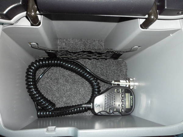

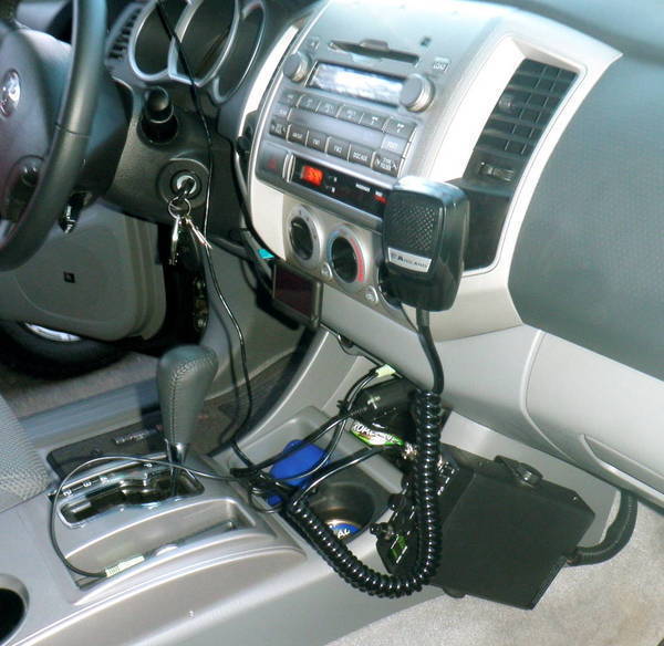

    I installed the Cobra 75WXST radio as well. I like how the entire radio is basically in the handset. I installed it in the arm rest compartment and have the coax running underneath the console to a grommet through the floor and to the bed with a Firestik No Ground Plane antenna. The no ground plane antennas work well for us with the composite beds as there is not metal bed to act as a ground plane.
    The arm rest has a great area behind it where the radio unit can be mounted. Then I drilled a hole to the console area. This is where you screw the microphone in. This allows the entire CB to be hidden when not in use. When it is in use, you can pull out the MIC and the arm rest still closes without crimping the cable.

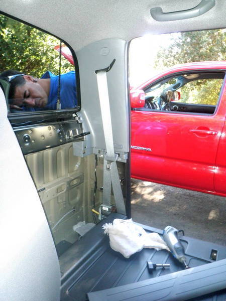

    Here is how I mounted the antenna in case you were wondering. :D
