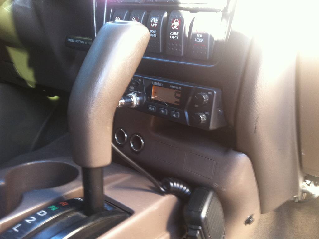

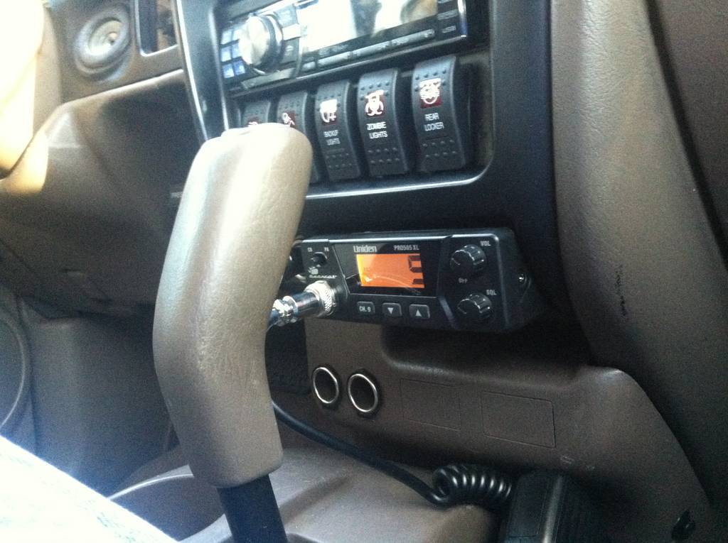

    5100 OME 3" front lift 1.5 rear All Injen cold air Intake N-Fab light bar Hella 500FF lights Alpine Heand unit Type R 10 sub r500.1 amp Alpine 6x8 comps up front Alpine 6x9 in rear
    Here's where I put my

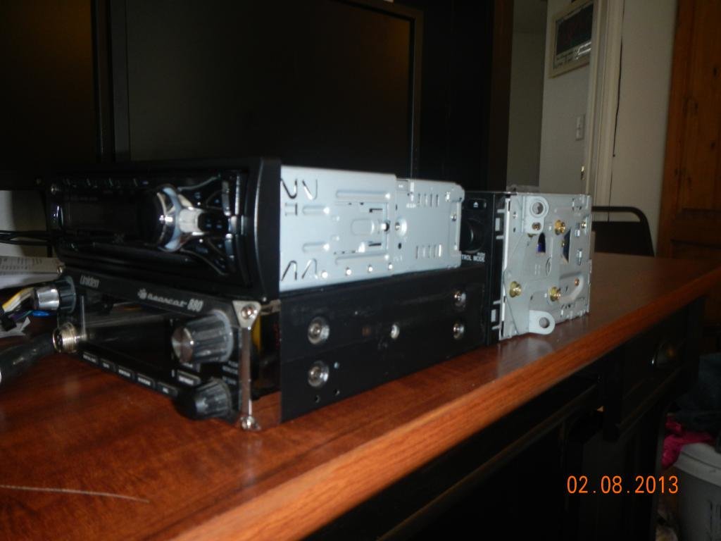

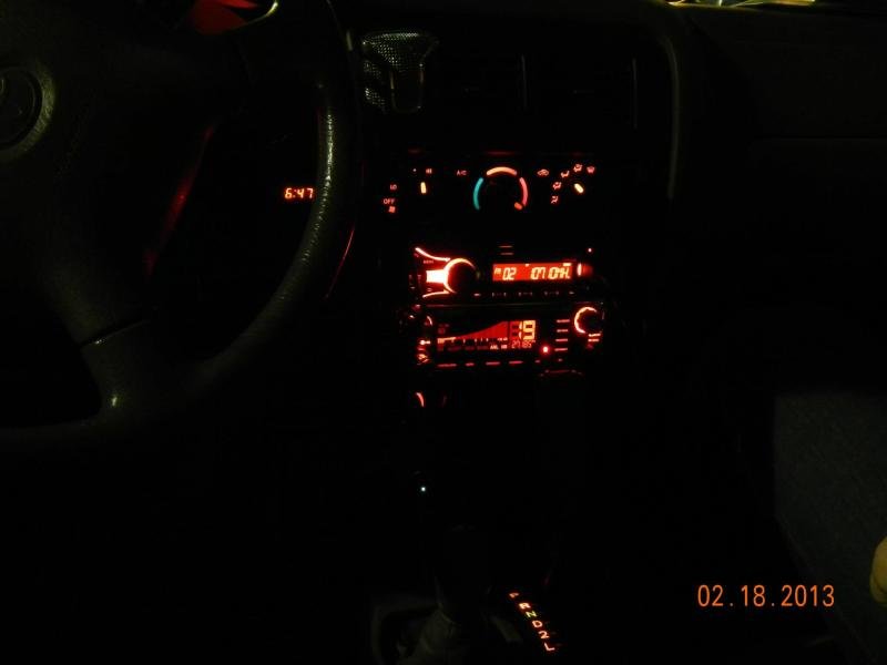

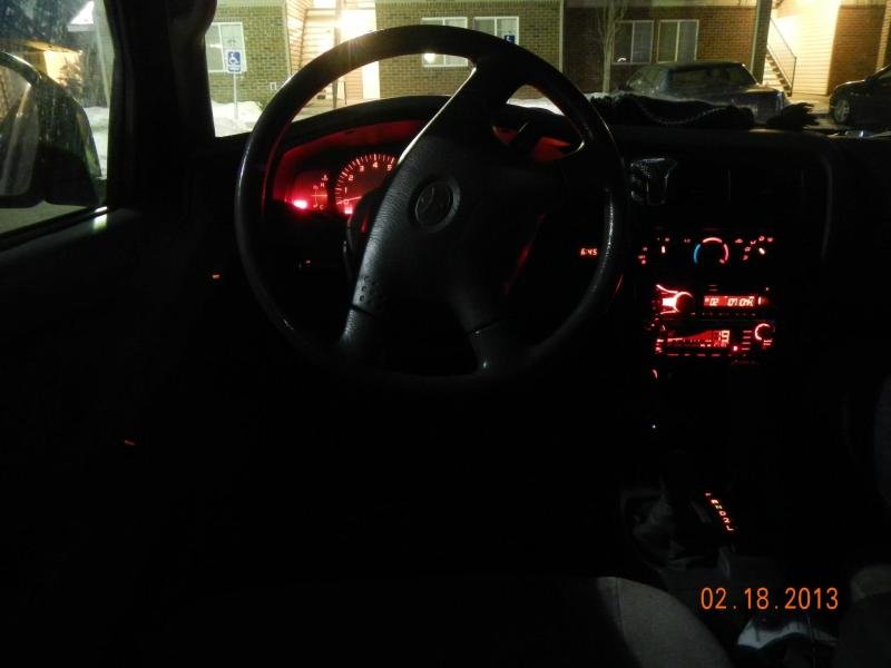

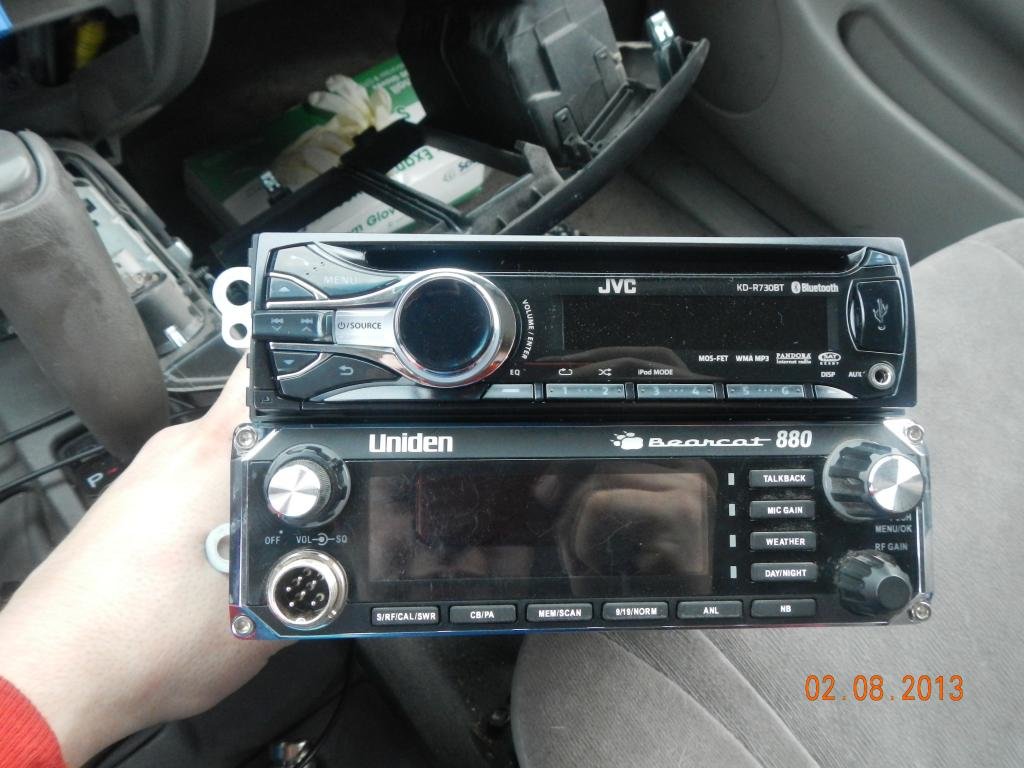

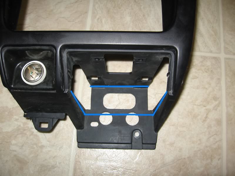

    Funny you ask because i just finished my install of that very radio... I love the heck out of it, and it's by far the best radio I've had so far... The color change feature means it blends in to the rest of my dash at night and my dashboard doesn't look like a Technicolor Unicorn threw up on it. Here are some pics of how it looks installed:
    There was a bit of issue with the antenna plug sticking out too far in the back and pushing against the duct work back there, and i actually had to push the antenna plug back into the CB radio a bit and put a 90 degree elbow on it to get it to work. It also took quite a bit of filing the plastic bezel to get it to fit. I have a few pics of the install process i could probably dig up if you're actually interested in a write up or something...

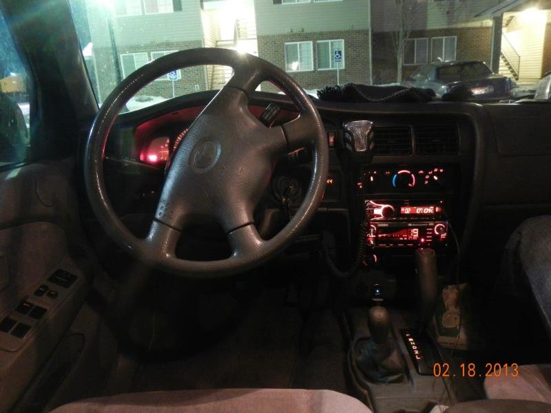

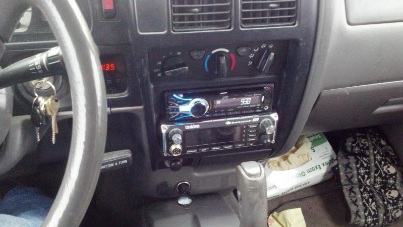

    here's what it looks like in the day time:

    Nice! I didn't think it would fit in there. Like, I didn't think it would even come close lol. How is it secured in there? Looks good btw. I've been debating between the bearcat or the cobra 75wxst. I like the look of the bearcat a lot more, that's for sure.

    I had similar concerns and the choice was made for me when i got this radio when i bough an old 86 4runner and it was in the back still in the box and everything... i had it installed in my 85 4Runner and when i sold that i went about putting it in my new tacoma... i'll try to find some of the pictures i took of the actual install process and post them for you.

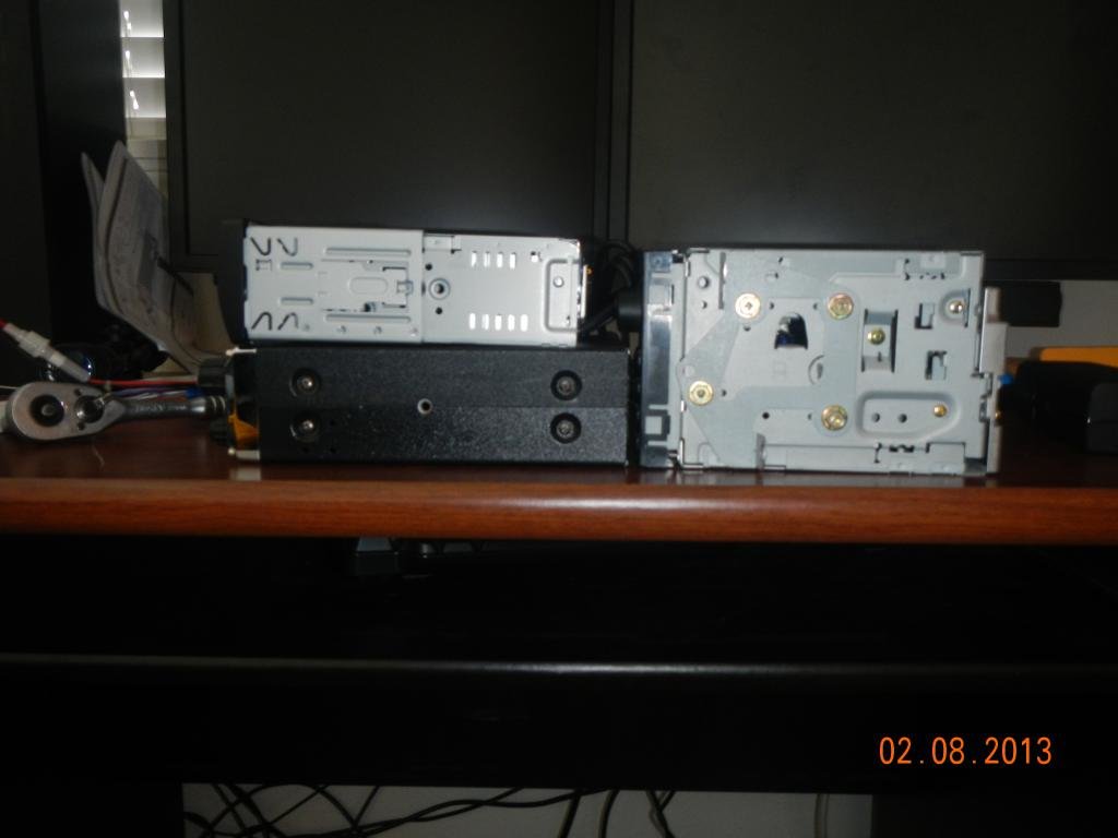

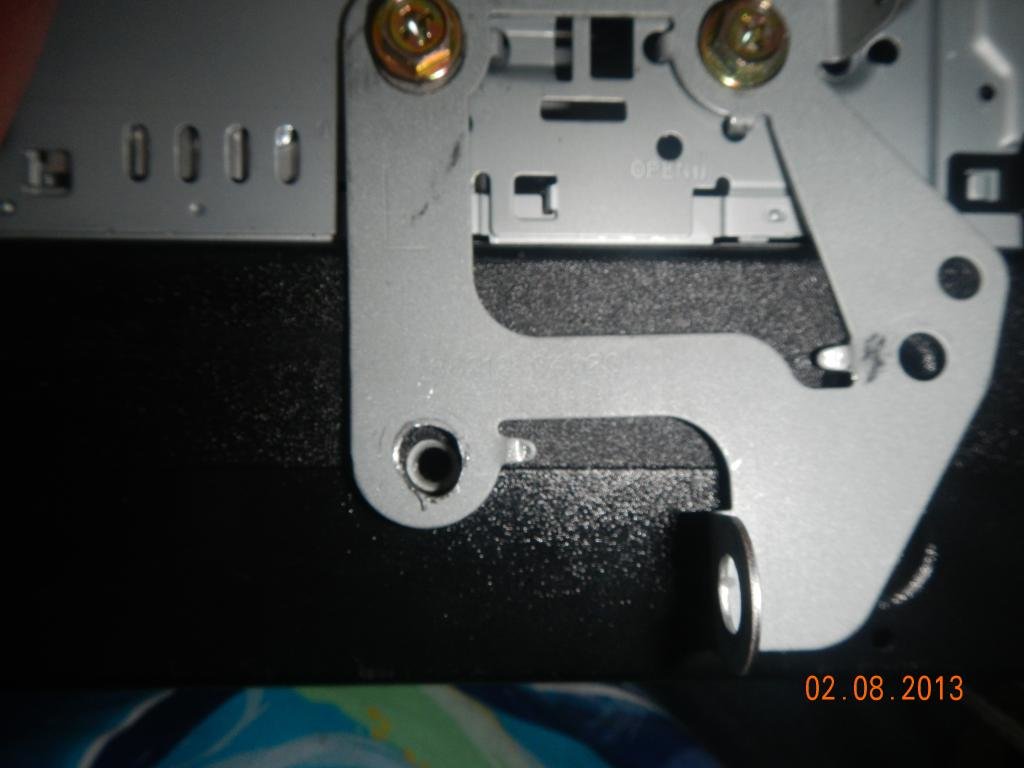

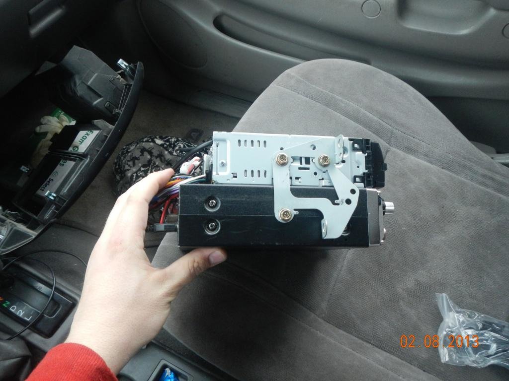

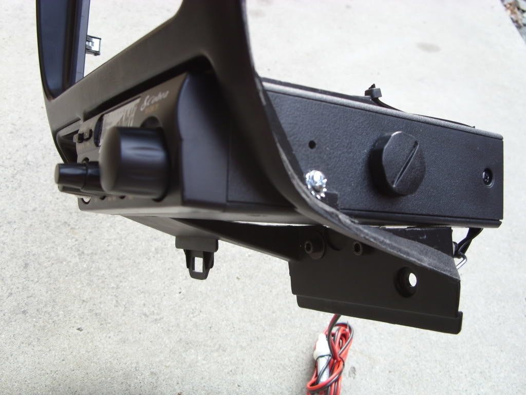

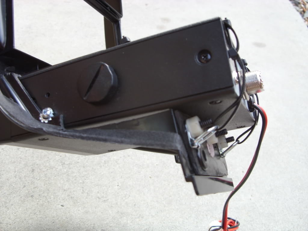

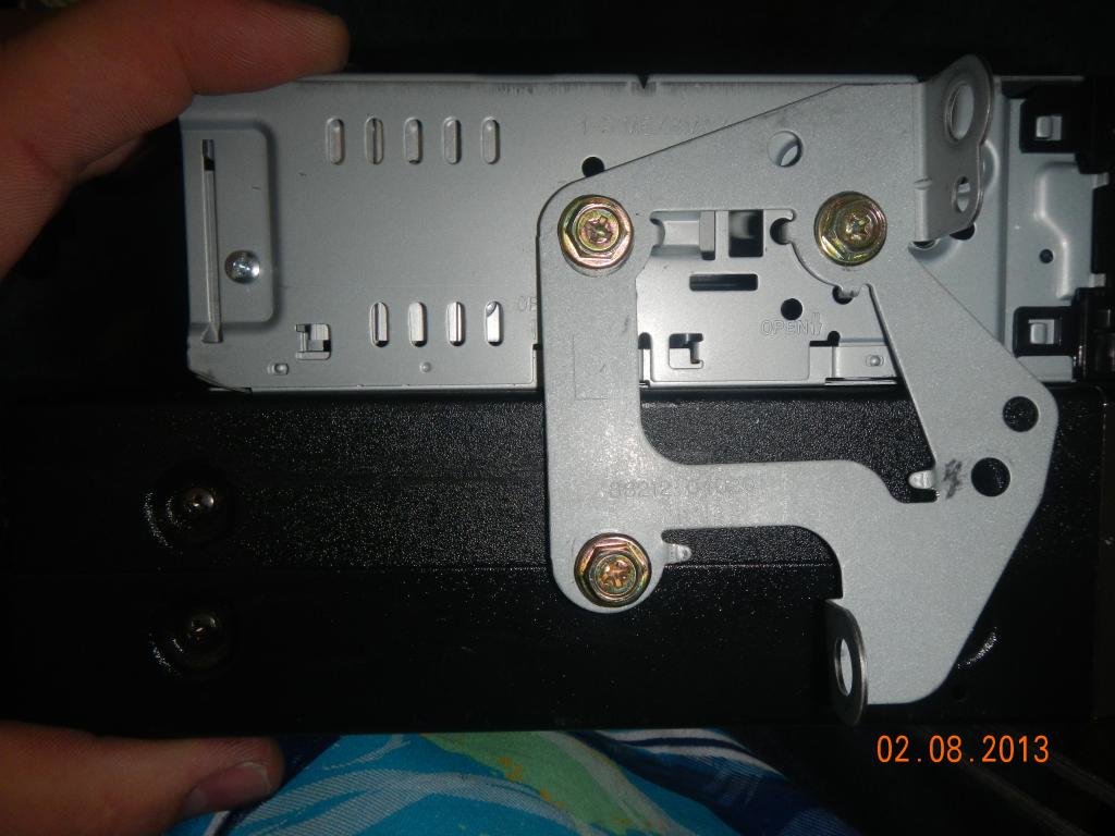

    I didn't take as many pictures as i thought but here's what i have:
    These pictures do not show the correct depth for how i ended up installing the radio. I was trying to mount the CB radio and stereo together with the stock mounting brackets that held in the stock radio. I did eventually get it to work but it took some slight modification to the bracket and to the cb radio itself by drilling new mounting holes. i had to readjust the cb radio and push it a lot more forward and i'm sorry to say that i don't have any of readjusted pictures...
    The hole in this picture is the normal mounting hole that the radio comes with. Unfortunately, when i mounted the radio through this hole it pushed the radio too far into the dash (towards the firewall) and it hit the ducting behind it... i eventually had to open the radio to find a place safe to drill through and make my own mounting hole... but after that it seemed to work pretty well.
    Again, this does not reflect the final mounting location...
    After i did this the antenna connection on the back was really in the way. I had a 90 degree elbow but that still wasn't enough. What i had to do was actually open the radio and loosen the nut holding the connector in place so i could push it back into the radio more. I then used the same nut to hold it back inside the radio and i put the 90 degree elbow on it. The result was a new male connection that sat almost completely flush with the back panel and gave me enough space to install the radio. Be warned, i did have to re-solder the male connector back to the circuit board due to my own rough handling when i was trying to push the connector back into the body. I wish i had taken pictures because i know this is going to be hard to figure out what i'm talking about just reading it...
    I also had to file A LOT of the plastic bezel to get it to fit... and i do mean A LOT! and since the radio sticks out a bit it was also a tight fit getting the plastic bezel to fit over it... It took a lot of modification and work, but in the end i think it was worth it. I also have an external speaker that i'm going to mount in the headliner above the rear view mirror, but this radio is actually pretty loud and i can hear it really well even with the normal speaker burried in the dash...

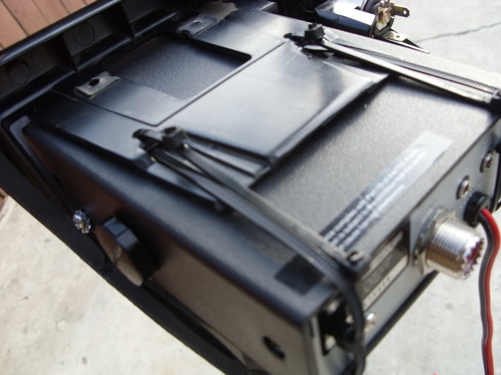

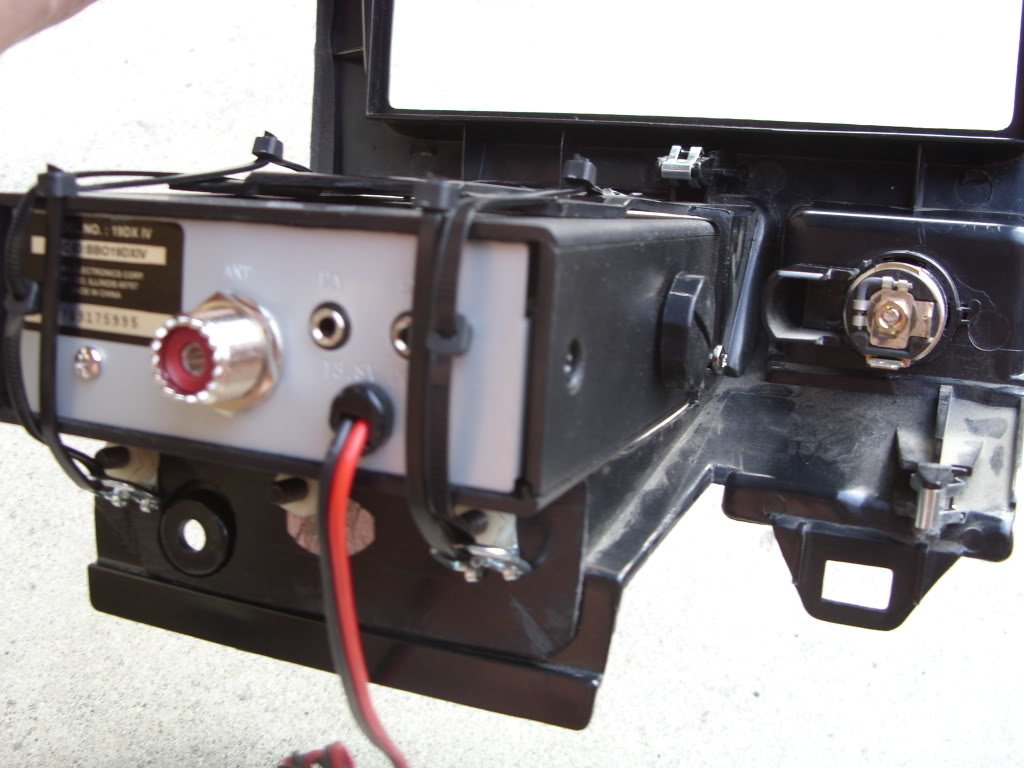

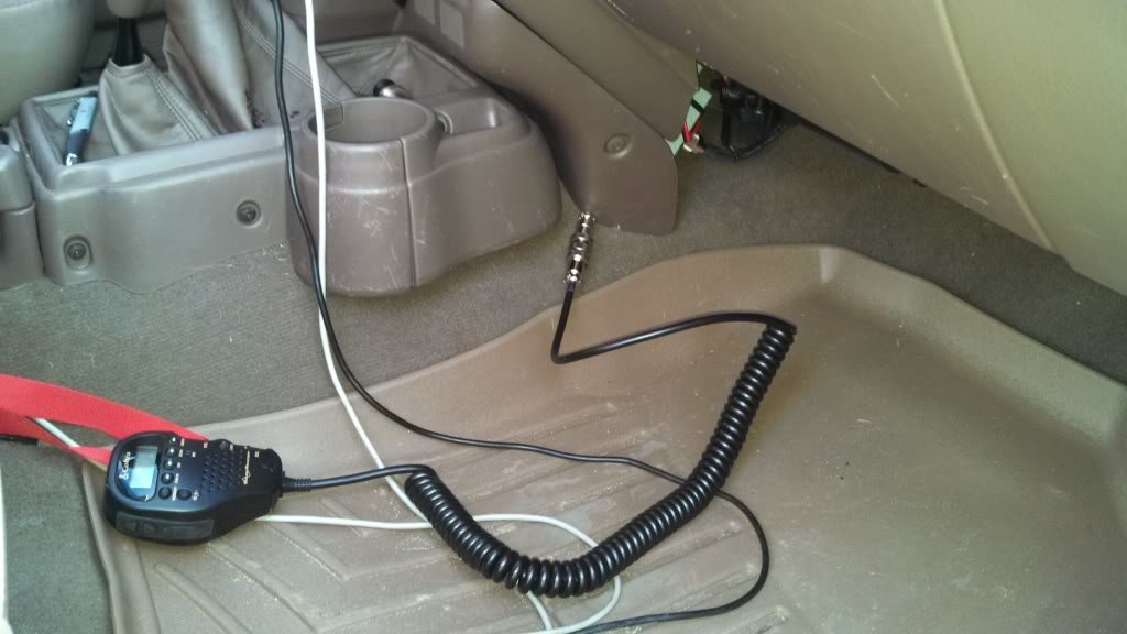

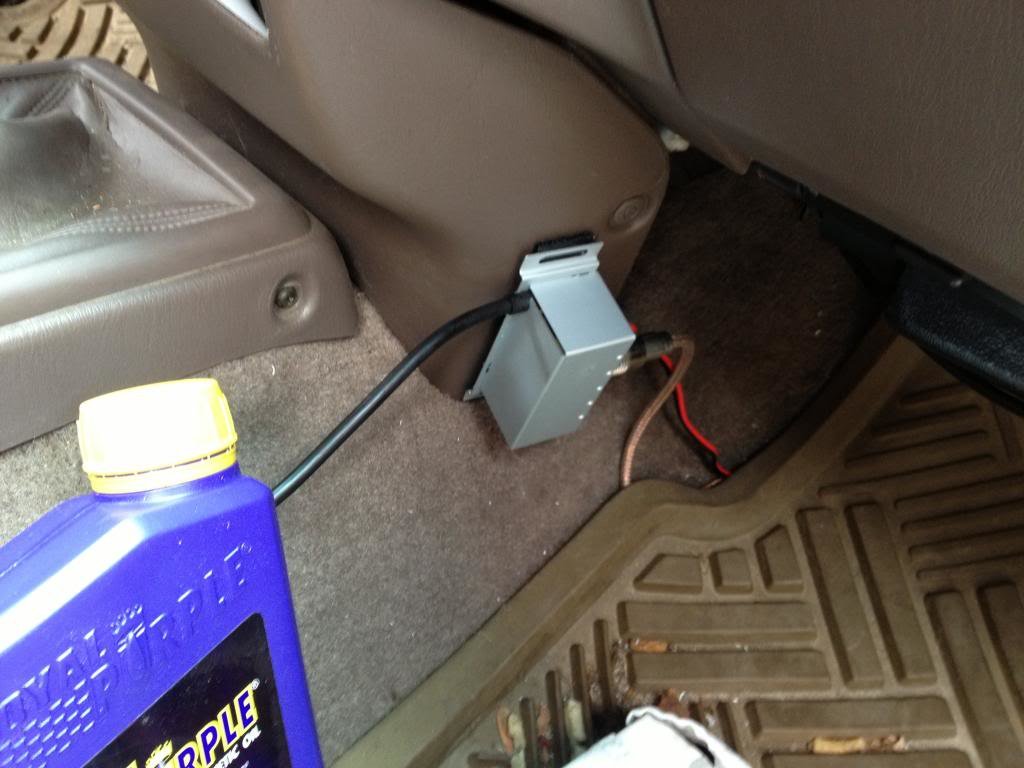

    Here's mine: Cobra 75 wxst.
    Installed the hidden part in the cavity under the ashtray on the passenger side, just behind the lower radio/hvac trim piece. When the handset is disconnected all that is left is the female half of the coupler. Works well, and it didn't require any real custom fitting. The hidden part is held in with zip-ties so it can be easily removed if need be. Only cutting I did is a small notch in the lower trim piece for the coupler wire so the trim piece would sit flush.
    This allows me to still retain the small storage cubby under my aftermarket radio, and the ashtray(change holder)

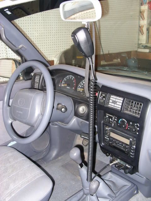

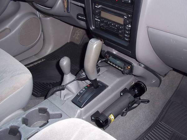

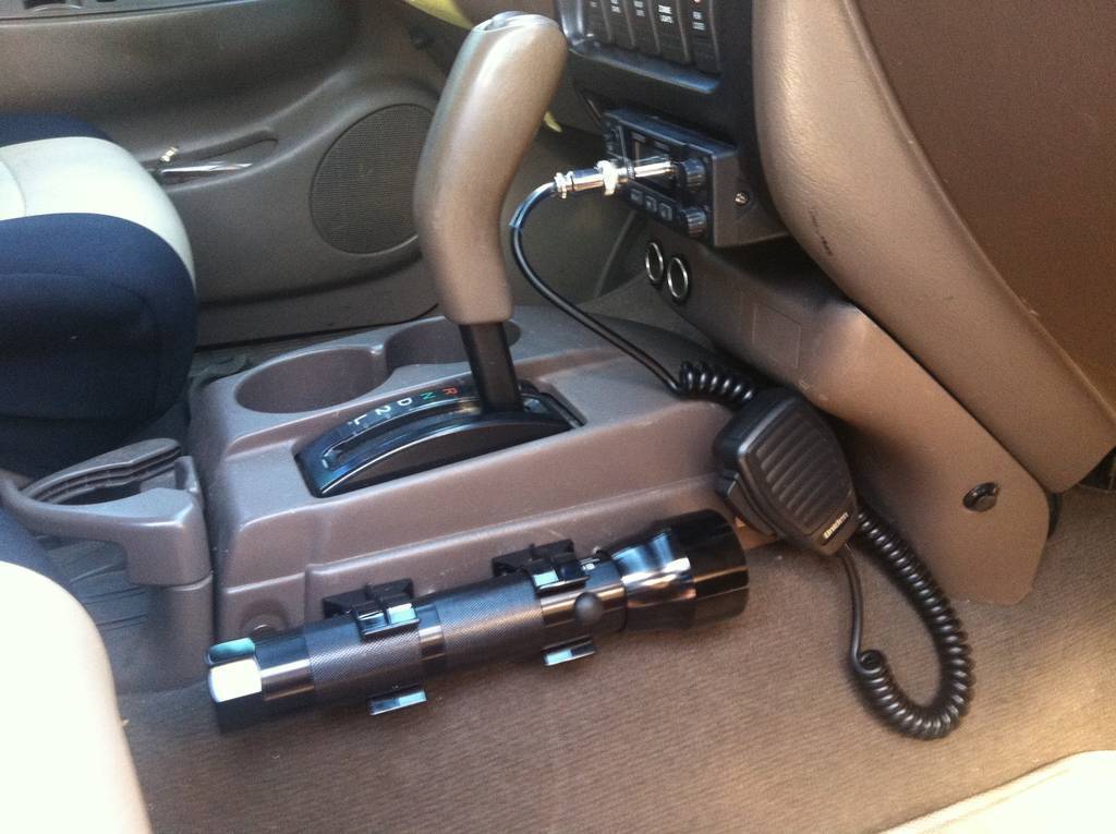

    I got a Cobra 75 WX ST And installed it like this:
    Did it this way because I didn't want to cut up my dash:cool:.
