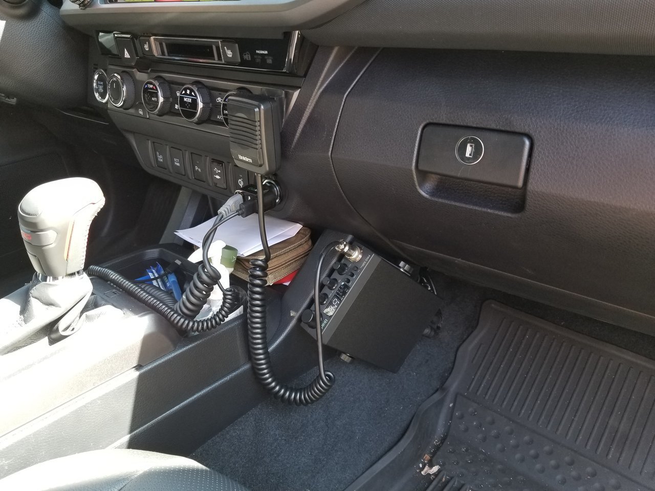

    I have a Cobra 75 WX ST....Control box is mounted under the passenger seat with velcro. Fuse tap from fuse panel provides 12 v. I use a Wilson
    ("Lil Will") mag mount antenna. Very easy install and easily concealed when not being used.

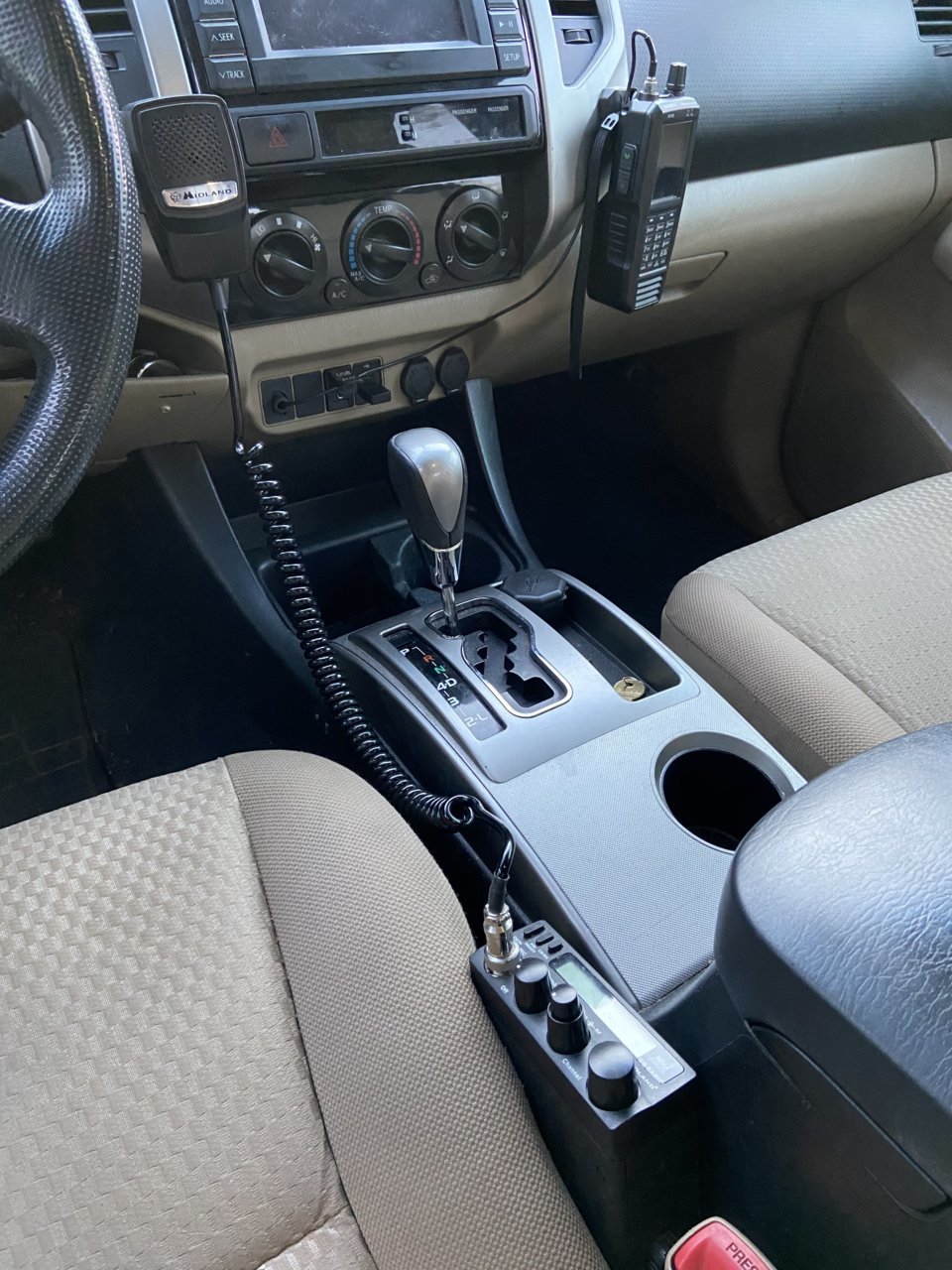

    Mine is mounted just like the one above. The mic holder is on an Expedition Essentials 3TPAM.

    Not too much
    My CB is set up in almost the same location. I have been using the cigarette lighter but get noise from the AC blower. Where did you tap into 12 volts?

    yepp i had the same issue with mine. so i ran the wire to the battery. the red wire on the positive terminal and black on any grounded metal. worked mint, and because it was direct connection to battery i was able to use it even with the truck off

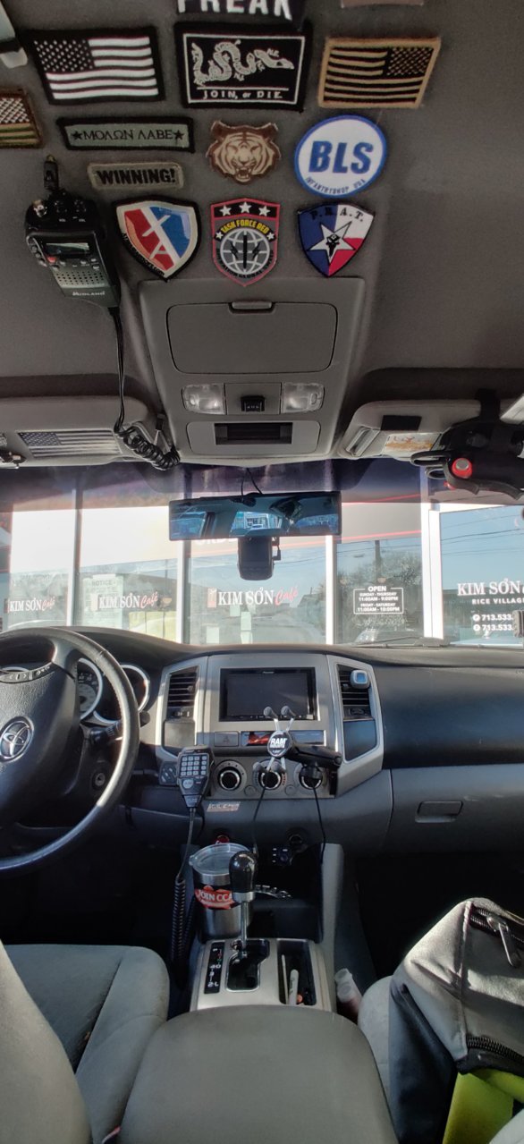

    will.i.was

    That’s cool, how is the radio on the roof mounted?

    I have two equipment ratcheting lines at the top of the radio and middle of the line. I drilled some holes and ran the lines through and anchored the fasteners inside the headliner and plastic upper console.
    A magnet on the base of the radio and inside the headliner keep it in place.
    When I use it, I can let go and the equipment lines pull it close to the headliner and I pop it back in place. It's convenient and allows me to disconnect the Midland 75-822 and transition to a handheld cb in seconds.
    The ham however is hardwires and a bit more permanently mounted lol
