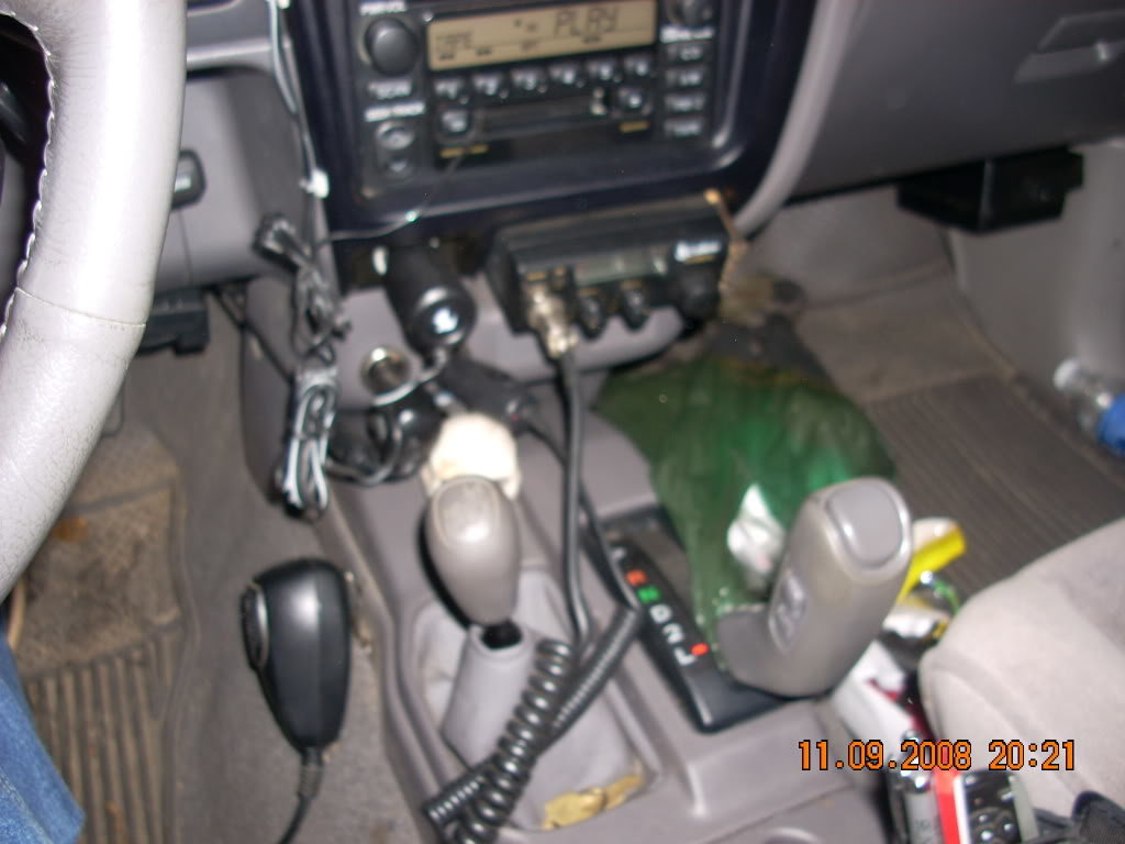

    You have the same body as mine..........I pulled my ashtray and stuck a Cobra Model 19 Ultra III........alittle dremel work. Your done in like 15 minutes. I can go out and take pics if you want to see what it looks like.

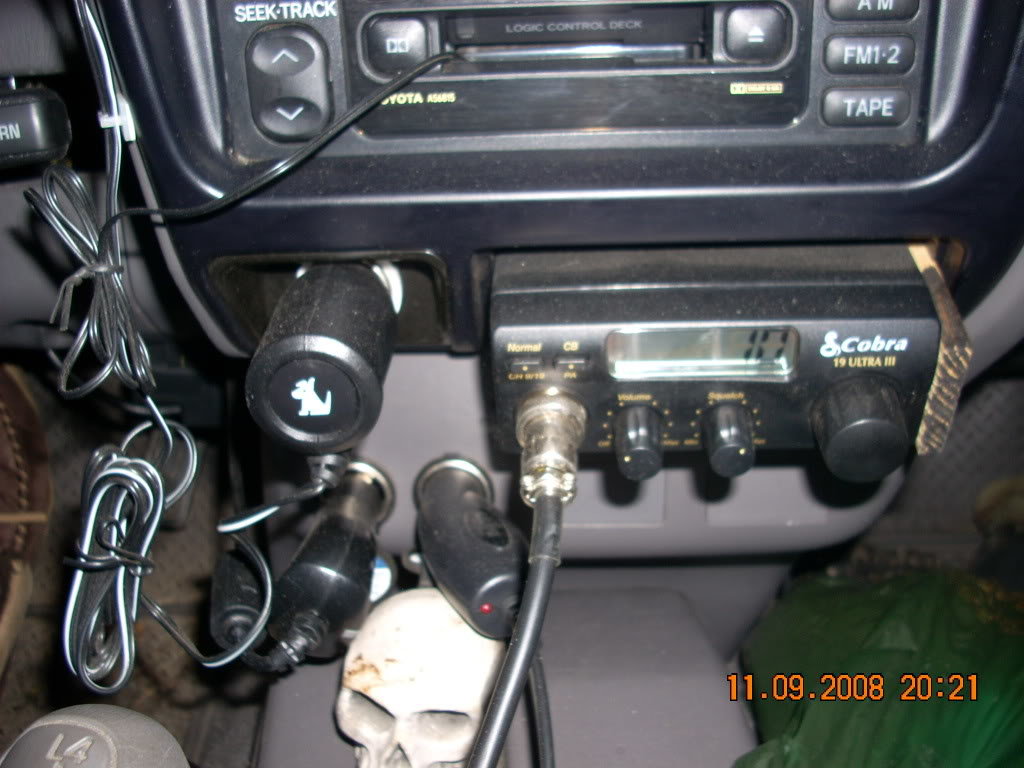

    Here are a couple pics............

    There is a very thin wall of plastic at the back of the opening (its like a stop for the ashtray so it can not go further)you need to cut it out in order to fit the CB all the way in. With a little finess you can get the mounting bracket in there. Its gonna be a tight fit........I stuck the shim in there becuase I wasn't able to tight the screws all the way down.........Its rock solid and hasn't moved since the day I put it in......(I have never touched it after installing it).

    did the best i could going from the back and front........you might have to loosen up the mounting bolts for the piece of molding under the ashtray area in order to get behind it. I have seen others who cut the plastic wall in the back only half-way slide the CB in and take a piece of 2x4 wedge it under neath to hold it in place........it'll never move. Mine rattled a bit so I stuck the shim in the side like you see in the pic. Worked like a charm. Thats How I got the idea of the shim......LOL

    Yup...........if you get to frustrated with te mounting bracket go with the chunk of 2x4 under it. My buddy went that route and its never popped out and he hammers his truck off road.

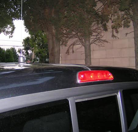

    easy install with a dremel and a fine file.
    ran the cable under the brake light assembly rather than going through the sliding glass
