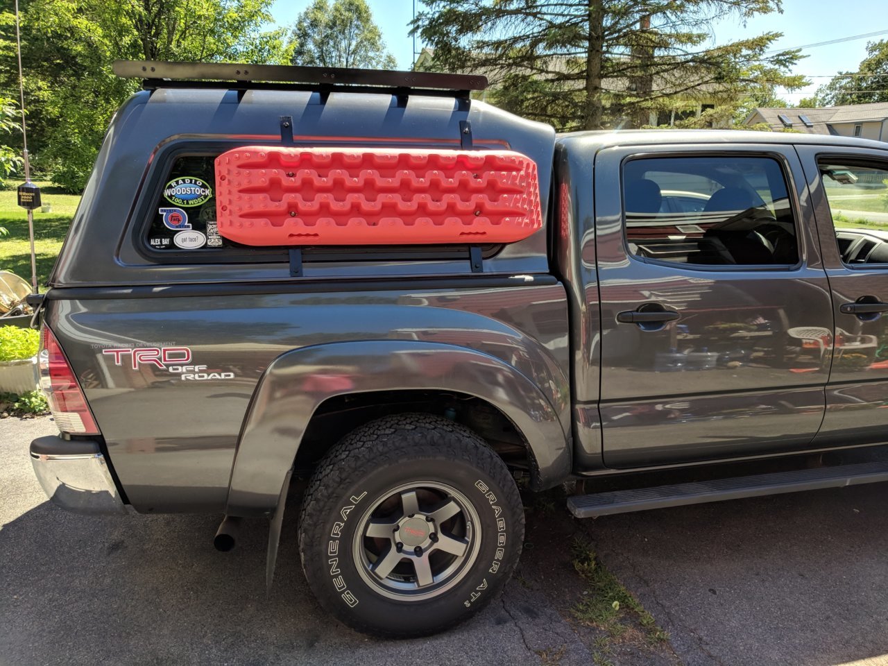

    Best pic I could find at the moment ..I'm a little tardy :D

    Traction boards and cab rack! Didn't knew you had updated the truck! Looks good!

    Had them on for a while..year or so. More updates done this weekend and should be ready to be on the road Monday.. Can't wait

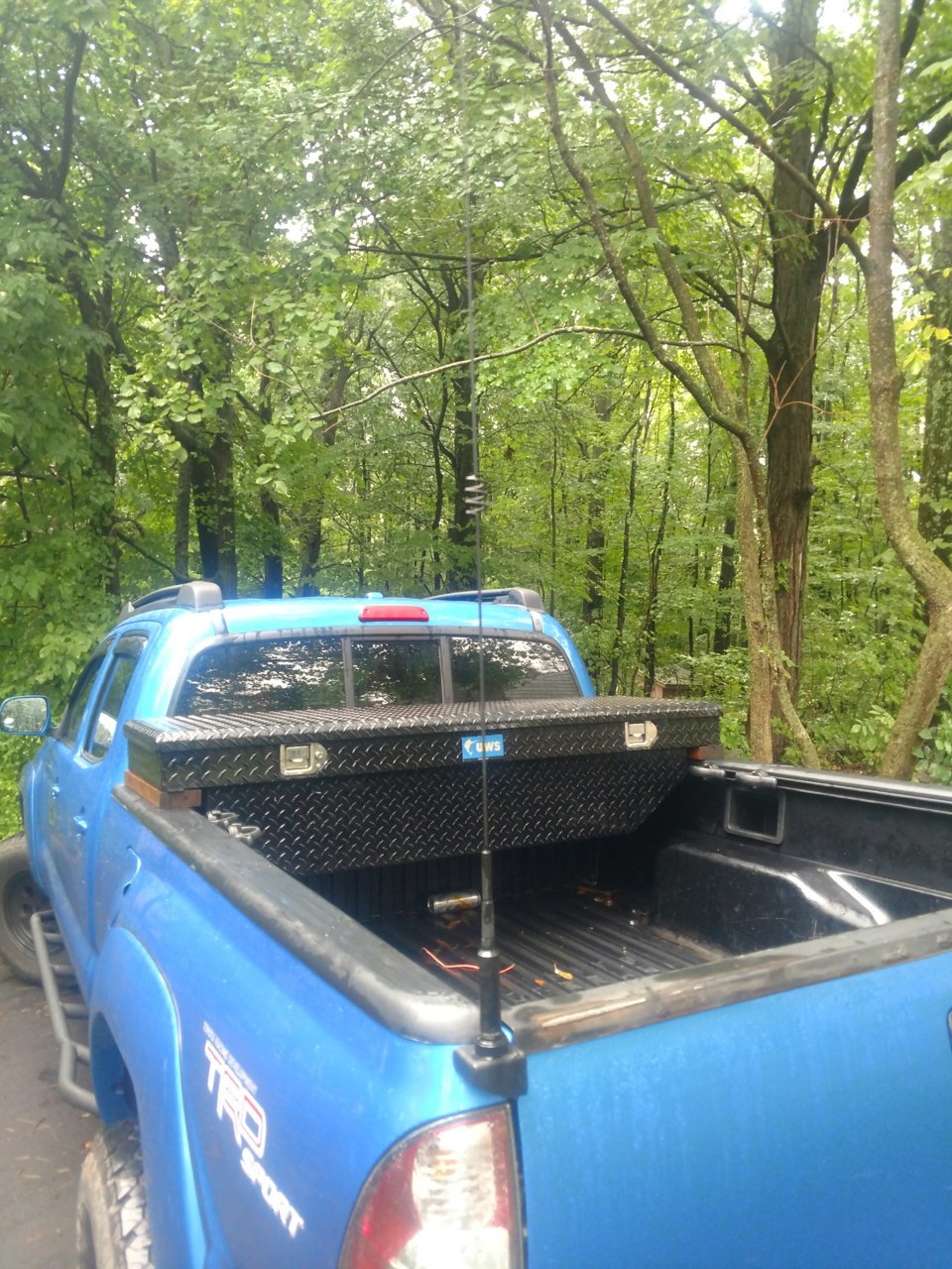

    What are you doing now?
    Btw...did you cover the bottom of the antenna at the screw on the bottom of the mount? I used plumbers putty instead of RTF to make it easier to maintain

    Same basic tailgate setup as others.

    I found a rubber plug under my rear seat (DCLB), popped a hole in it and ran it up through there.
