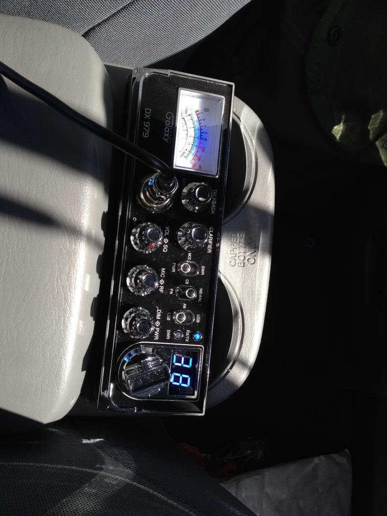

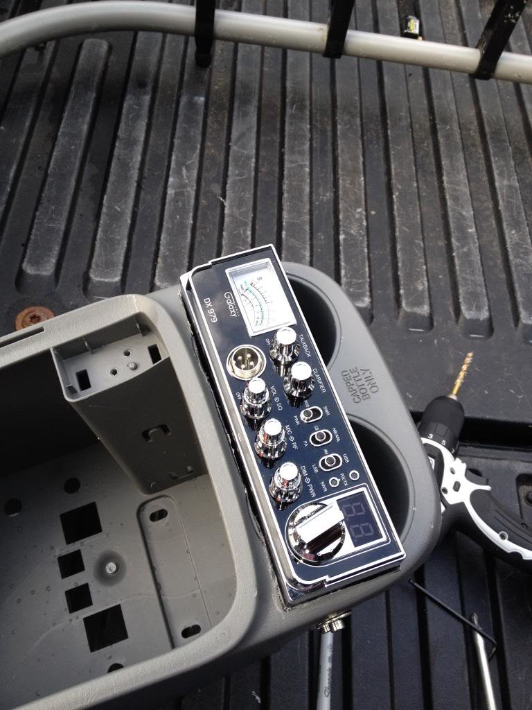

    Too late, Now the Government will listen to your CB transmissions....use the Handle Rusty Shackleford, you should be safe then....lol I posted where I put my CB in my Taco AC. any questions about the install, feel free to hit me up.
