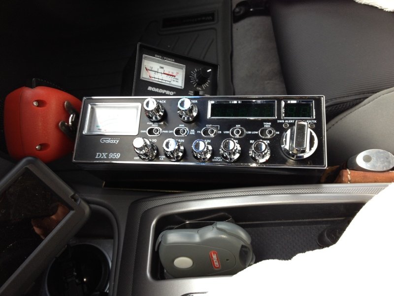

    Wilson 1000 mag mount in the center of the roof and a Galaxy 959 just back from Snakeradiocustoms. Tim kicked ass with this radio and I have swr of 1.0 - 1.1. Ditch the firesticks as I had a set and they were useless to get a decent swr.

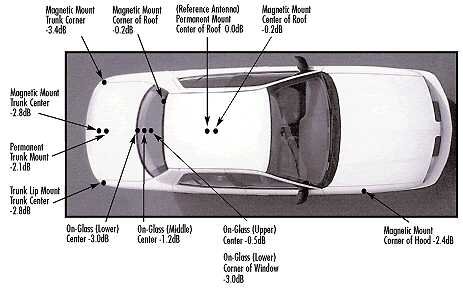

    Yes..in every situation a roof mounted antenna will always be better then say a tail gate mounted antenna. Its all about ground plane. Think of the roof as a giant reflector or dish..even a mag mounted antenna on the roof will have higher db gain then a tail gate mounted antenna. Both of my antennas are mounted to the roof. My Ham radio antenna is drilled through the roof in order just to have the best possible gain.
    Check out this chart..

    Curious how this applies to a truck (front corner of bed) having a taller roof line and also to NON-Ground-Plane antennas.

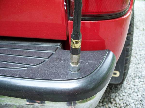

    I haven't seen one in person but those tailgate mounts look like they leave very little room for body flex in the gap. That gap between the tailgate and bed is small so my only worry would be catching the antenna on something and tweaking the mount so it rubs the tailgate or body or tweaking the body so it flexes and the mount rubs. I could be totally wrong
    Personally I would just drill a hole and mount it to the rear bumper off to the side.
    Something like this is what I have on my plate bumper and would work on OE with no issues. If you go to sell the truck just dab some black DOW 795 in there and no one would know there was a hole there.

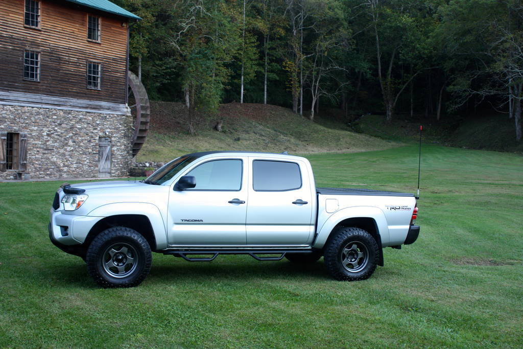

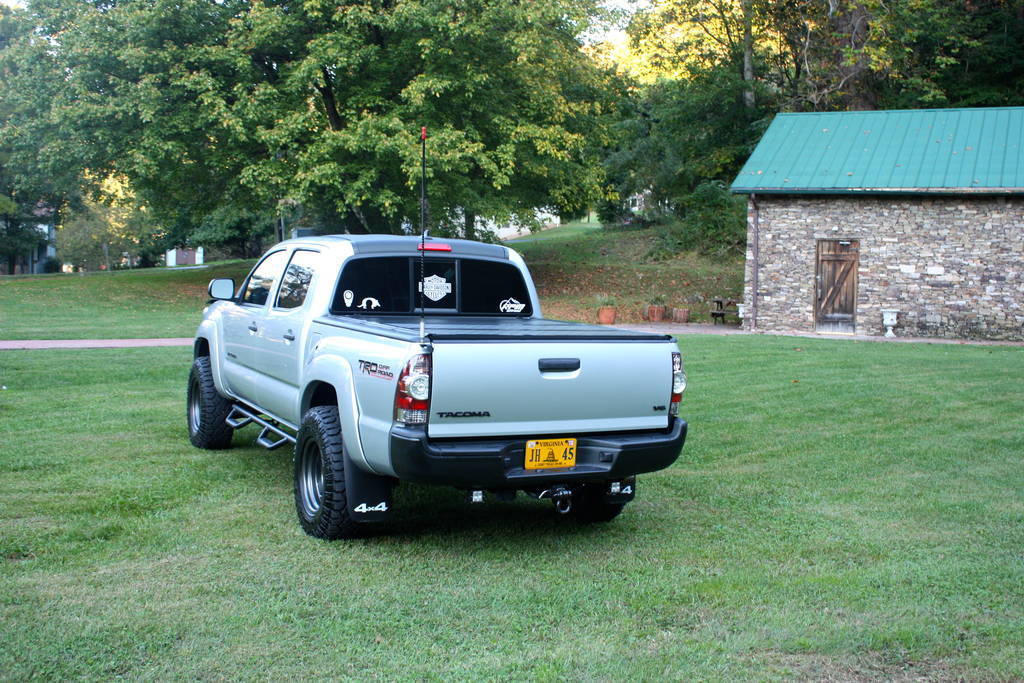

    Got my Galaxy 979 mounted up to the roof on a magnet mount system and I'm running a 102" whip on a firestik mount screwed into the bed. Clears the tailgate and I can fold the antenna down when I need to.

    This is a very clean headliner mount of such a large CB.
    Nice job.:thumbsup:
