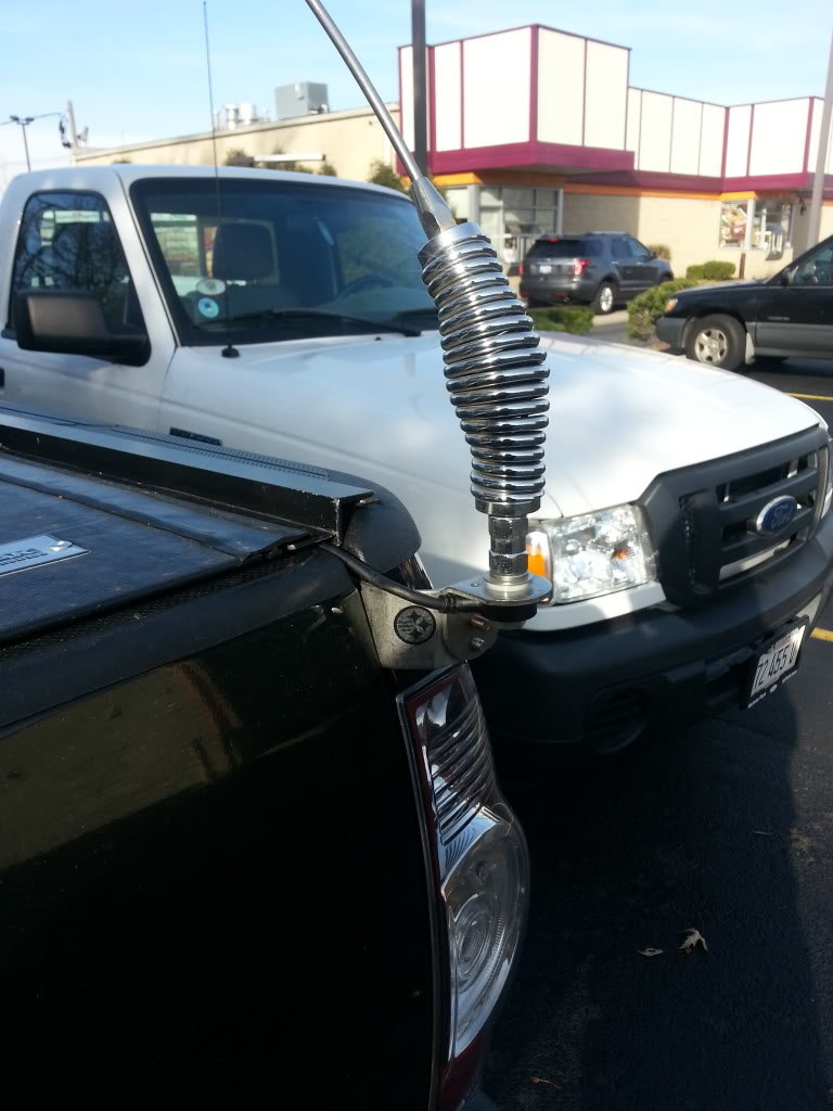

    You might want to change out that FIRE RING set-up to the TERMINAL END type (pictured). When the FIRE RING craps out just cut it off and do up the coax like in the picture below.
    If you do go that route make sure you coat the ends with COAX SEAL tape - it helps keep moisture out thus preventing corrosion. Heck, I would use it on the FIRE RING connector now!
    Like your setup and the bracket! :cheers:

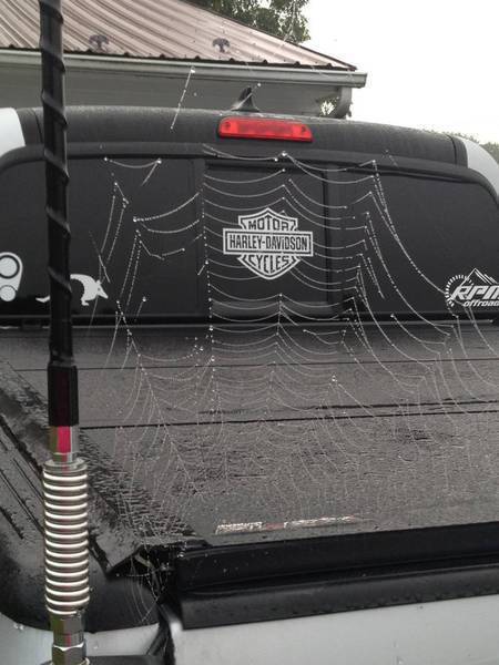

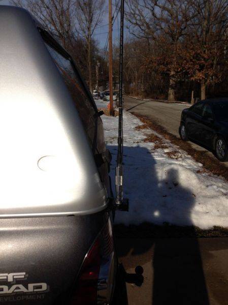

    Finally got mine installed. Wilson 4' flex. BAMF antenna mount. Uniden 520xl Pro
